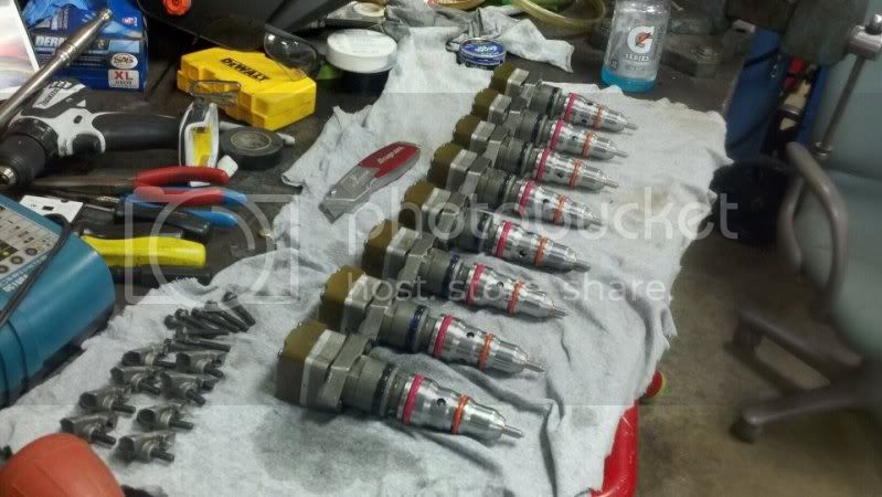

Got injectors back from Swamps. Went with 300/200s for the time. Dave and I were emailing back and fourth, we were set on 400/400s but he wouldnt be able to turn them around in time to have them by Carlisle. They were finished Thursday night, flow bench on Friday morning, werent gonna get here till Saturday around noon.
Didnt make it to Carlisle anyway, so they could have just been turned to 400/400s anyway. Oh well, Theres always next time.

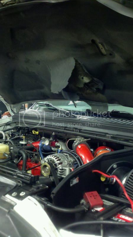

Got injectors in, everything together, took for a test ride. Daily tune, half throttle, 40lbs, boom. Whoops. Need to add more clamps and change boot
Changed boot and got 4 clamps, took for a ride last night, in the daily tune, still have yet to burn the 2 new tunes Dave sent.
Little hazey cruising, still getting some air out, but man, rolling into it at 45mph, lites around 2k, speedo moves quickly.

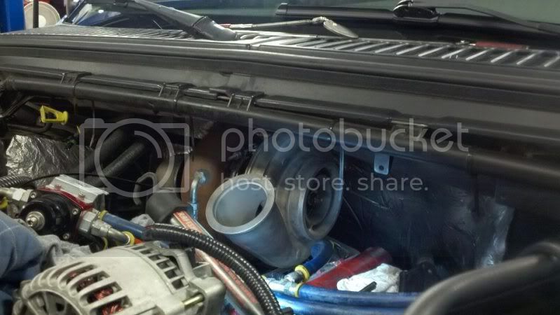

i still have to get that up pipe fixed, hope to get to it next week some time...i was really not happy after that dyno run...didnt even care to look at the numbers after dumping more smoke under the hood then out the tail pipe!

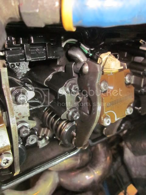

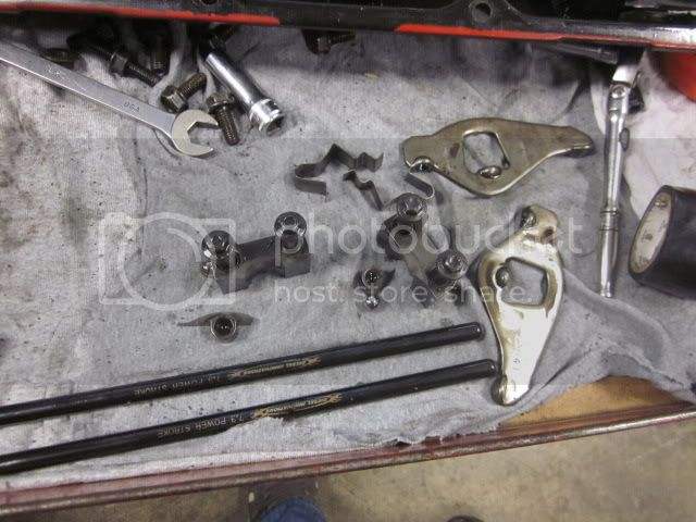

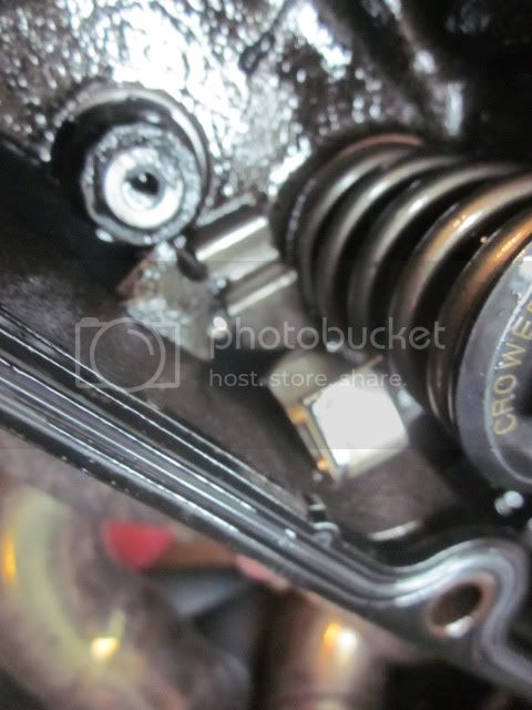

On Friday, was getting the truck ready for the Buck. Loaded new tunes, took for a ride, running awesome. Pull in garage, check fluids over, start up, back out of garage, CLACK CLACK CLACK, SES light on. Heart drops. Pull inside, shut off. Pull driver side valve cover. Find this:
Both rocker are retainers snapped, same cylinder, exact same time. Luckily found all pieces in the head, nothing dropped down. Push rods laying there, rollers all good.

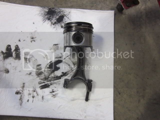

Ok, thats that, only thing it can be is a bent rod. Injector putting fuel in cylinder, not coming up high enough to ignite fuel, so only raw fuel coming out.

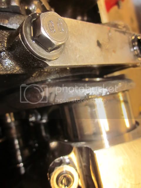

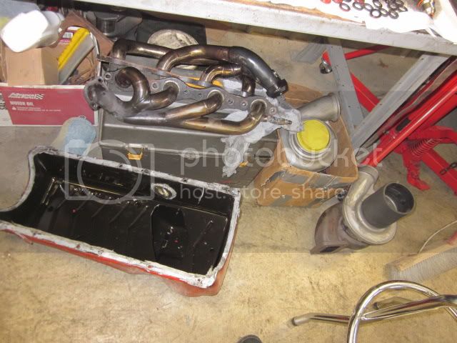

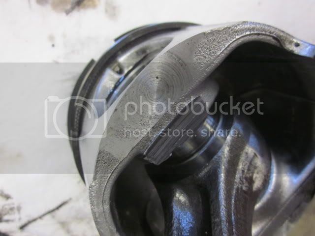

Pulled motor in 2 1/2 hours, head off, find #6 piston, 1/4" shorter on TDC.
FACK!

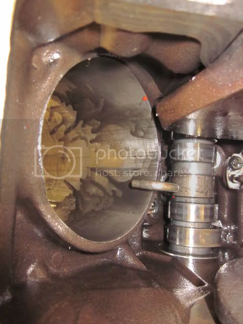

Flip motor, pull pan, found the knock. Piston to crank contact.
Slight score in cylinder wall, doesnt go past ring mark.
Now Im stumped on what to do.
Save for Billet rods, or replace one piston and rod. Cryo'd forged. .20 over piston with 15.5 comp, radiused and delipped.
Im not sure what caused the retainers to break, and if that is what caused the rod to bend, valves slamming shut during exhaust stroke, or what.
