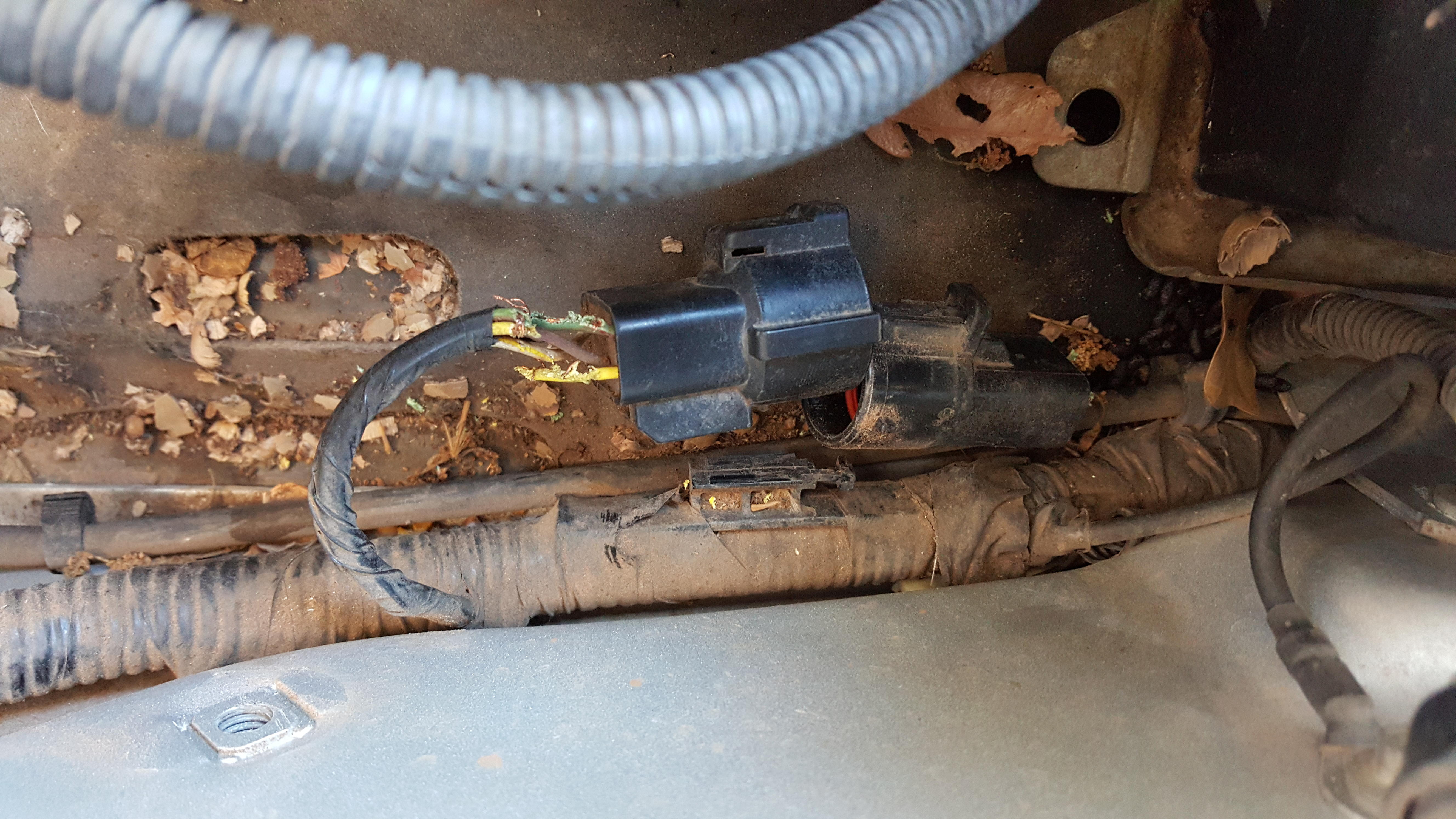

I have been told that the two wire connection at the alternator has one wire hot all the time and the other is ignition powered. My alternator has one wire hot all the time and one dead. I am missing the ignition power to excite the field in the alternator. I need to find out where that wire is fed power from.

On a 03 it is fed from the instrument cluster. I assume a 05 is the same but cant say for sure.

^^^^ This is the plug at the back of the instrument cluster, correct?

I HATE RATS!!
