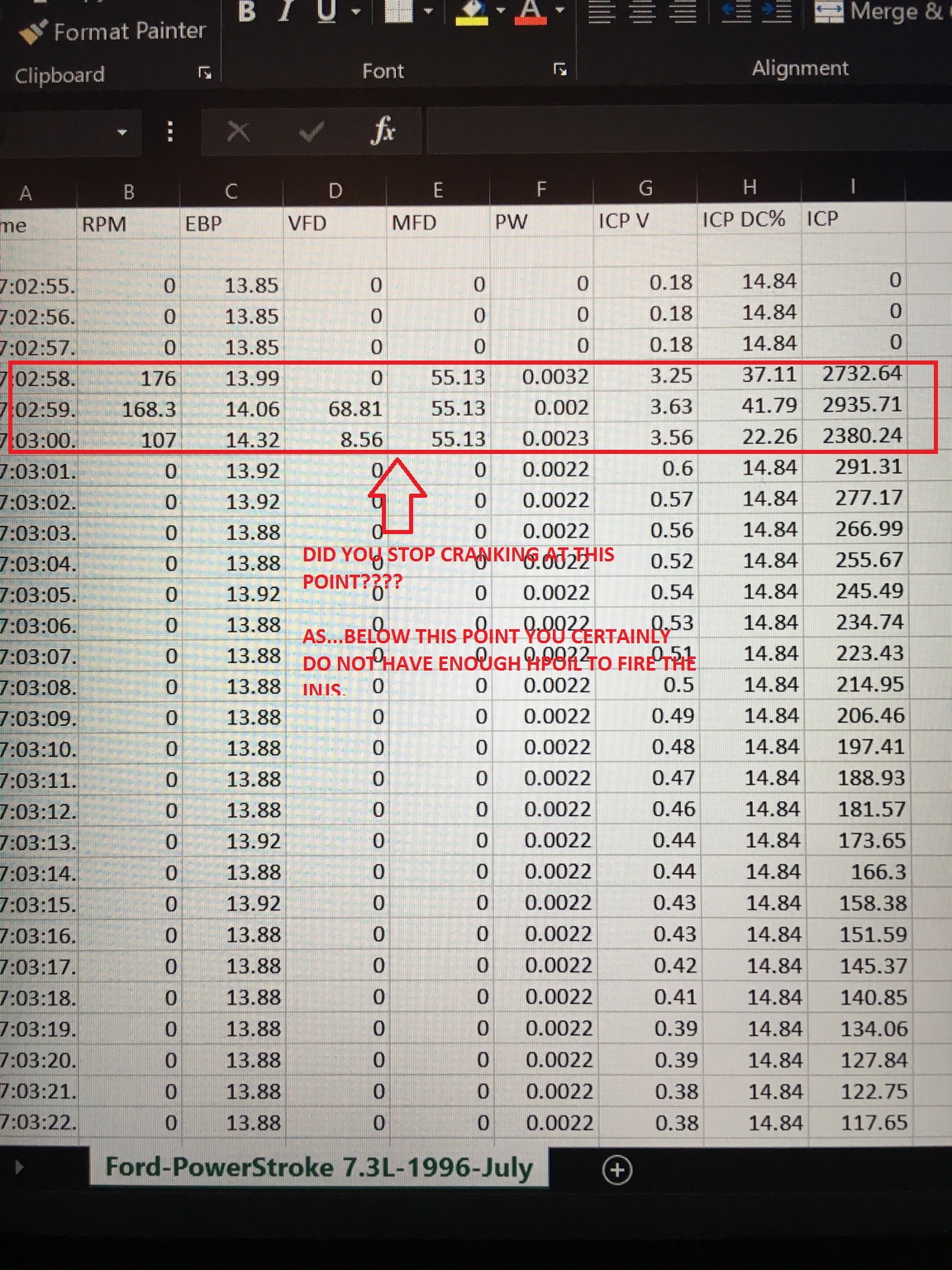

Did you only crank the truck for a couple of seconds?

That was the point in my original post too...the engine rpm column makes it appear it popped off and stopped cranking the motor.
golfer
1,209
after 15 pages...I assumed someone would have noticed 0 rpm...
until you get rpm...the PCM isn't going to command any IPR duty cycle...
(ProTip: because it doesn't think you are even cranking...)

Can you post a log of just cranking the truck over and what ICP/IPR DC% are doing.
Aluminum shavings interfering with IPR and/or HPO? Is there enough LPO to supply your HPO?
CPS not giving a consistent RPM signal to PCM? Faulty sensor or cam gear?
IDM faulty? Should be throwing a code, but faulty electronics don't always tell on themselves like they should.
PCM faulty? Same as above.
Those are my four stabs from what's been shared in this thread thus far.
Hope to see a video posted of your truck running great in this thread, sooner vs later.
I can do this later today.

That's bc I had the key turned for a min or two before cranking.
It comes on normally as it should.
