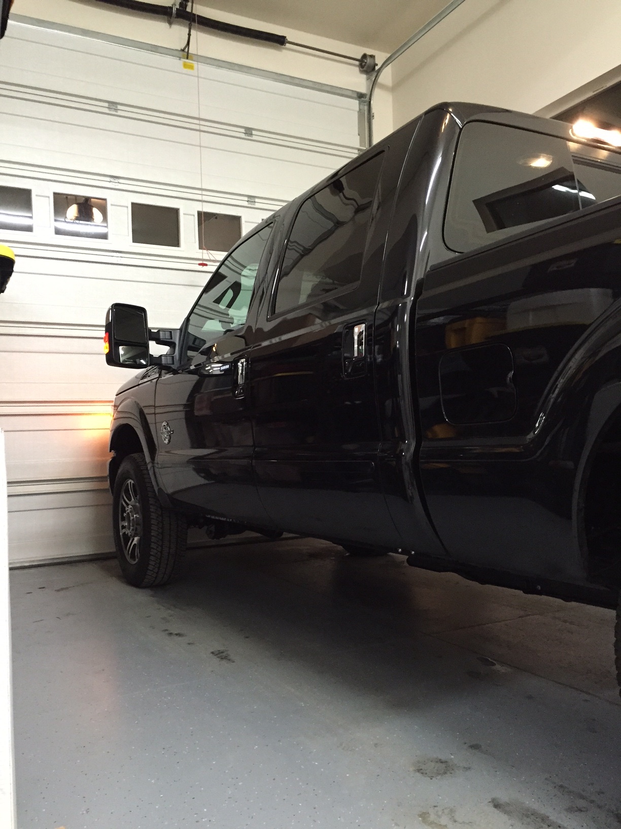

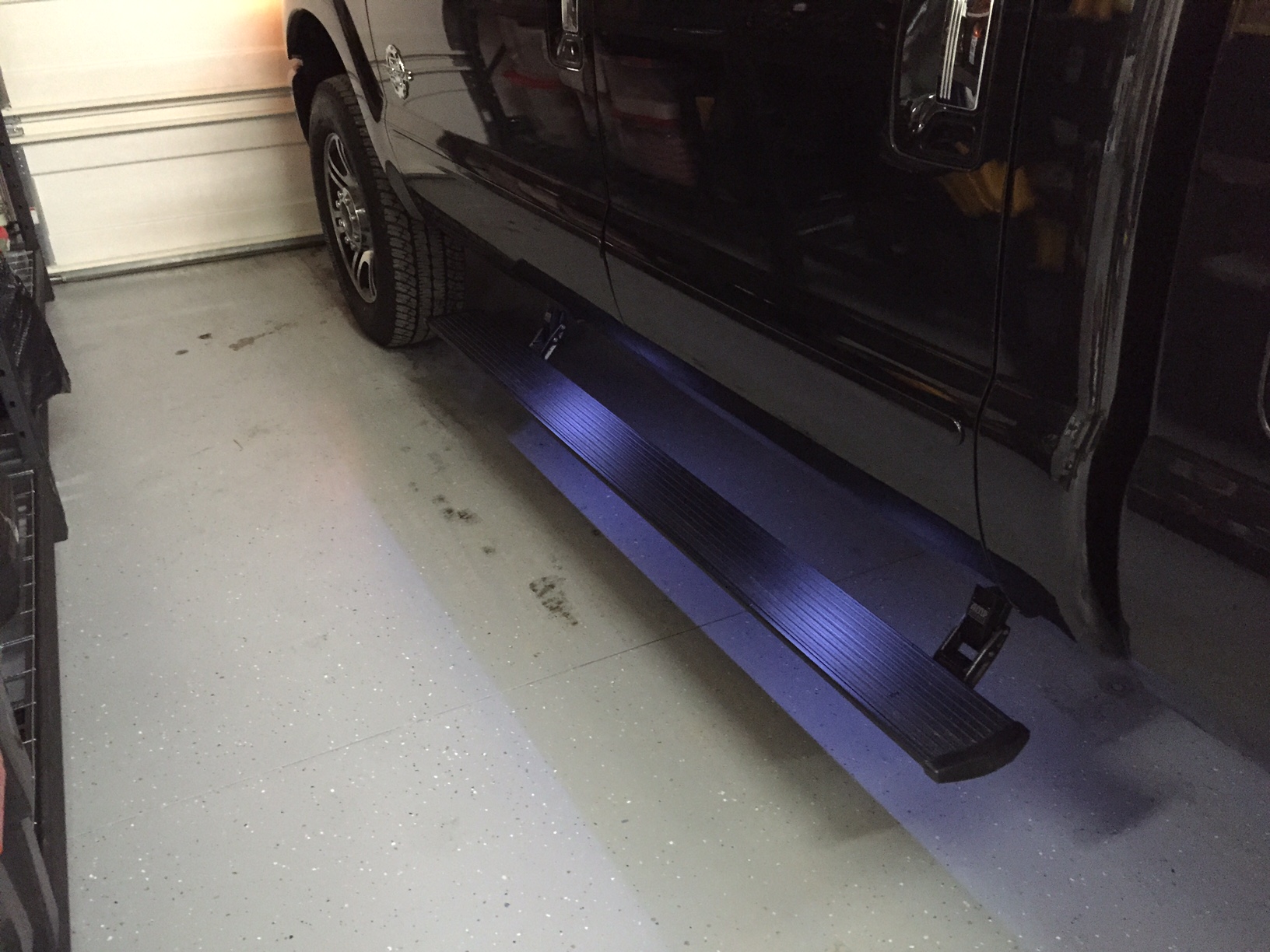

Running the Amps on my truck and no complaints. Love 'em! I went with the traditional wire-in model. Wiring them up wasn't too much of a hassle. I only wish there was an option for a switch so you can keep them permanently in or out. On my '10 F150 Platinum with factory power steps, I could control them from the dash option menu. Made it easy when going through a car wash and extending them out to get cleaned. First world problems, right?

I aggree that on the 08-15 SuperDuty wiring is cake. Try them on a 13+ Ram or I'm sure a lot of other vehicles, that OBD2 is worth double what it cost in that case
