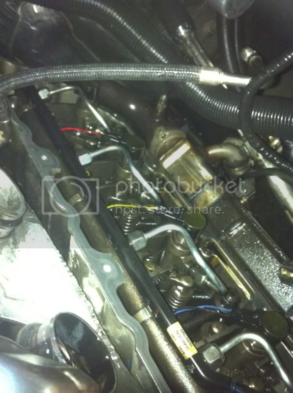

Well worst fear confirmed it's a hole in the piston. Took it apart last night in the camp ground and found all rockers intact.
Now I am in the process of figuring out how to get everything home. Once home I will begin the process to make it stronger and better then before.
What a kick in the nuts Nick.
Why doesn't it ever happen 2 blocks from home when your on 2 weeks vacation.
