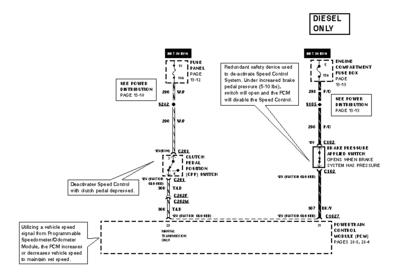

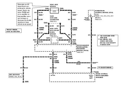

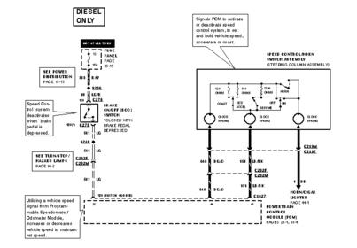

Trying to see what else to check. Third brake light is working. It is aftermarket Got a new master brake sensor with the ford recall harness on it. Fuses are ok in that harness and under dash. I did get another clutch cutout switch. What do I need to check for at the steering wheel? Three different wires. One for the horn and should there be power at one of the others?

Here's three gifs on the speed control circuits from the 96 EVTM. Cheers!
