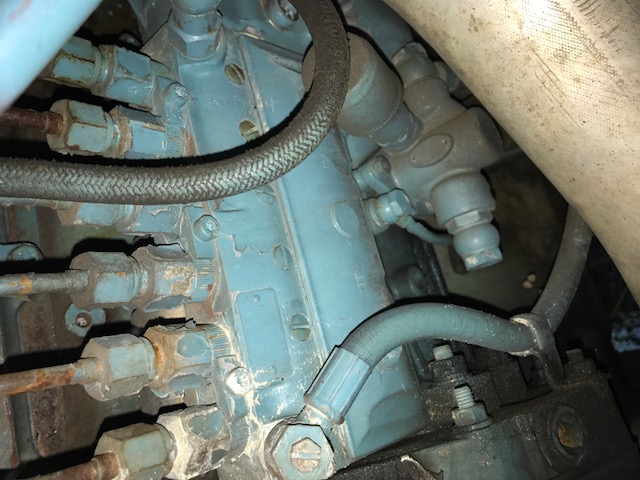

Awesome! That's the one you want bud (aftercooled model and most likely has an inline pump). $900 is a steal. Post up some pics when you get them. Specifically of the injection pump.
Can you identify the pump?

That looks to be an a pump. If you can get any info off the pump I can tell you which governor it has on it. I think the weights can be replaced to allow for more rpm or you could just swap out the governor for a different one. It also may have a boost compensator (diaphragm) on the top of the pump, but can't see the rest of it in the pic. There seems to be a few different versions of thus pumop to include one that has a larger frame. This would allow it to handle higher injection pressures.

RQV governor is for road type applications i.e. vehicles
RSV is for off road type applications. I.e. tractors
I would think this would be an RQV being a bus, but that's not 100% gospel.

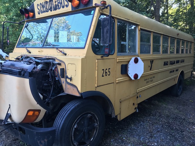

Its been a few weeks but I finally purchased the bus. Took me two weeks to meet up with the guy and get everything taken care of. It was the YMCA's bus so I had to wait until the right person (boss) was available to sign the title. Drove ole Betsy home last night and it ran pretty dang good. Now, I just need to find time to pull them motor and start the rebuild process. Anyone have a recommendation on which rebuild kit provider is good or bad?
