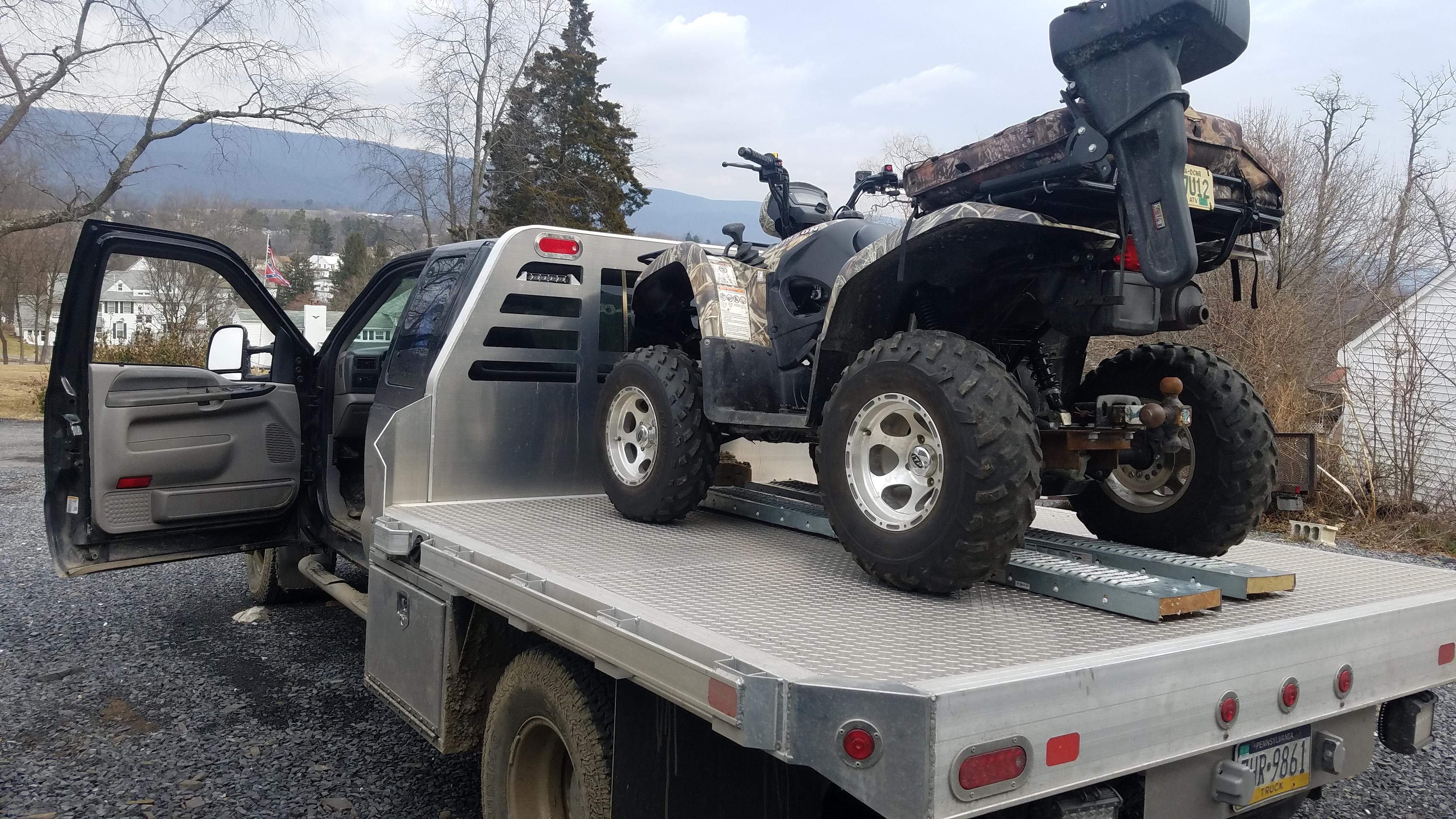

Kinda like the one I attached? Haha. And I just saw where you said you have an auto. So about the only time you should be able to make it smoke is lugging it while the converter is locked. Off the line with a .9 housing it aught to run like a rocket. I'd look for boost leaks, and ask about your tunes.

Yes!!! Exactly like that one. Nice truck! It does run like a rocket off the line but smokes the whole way in every tune. It's also a 3.73 gear.
