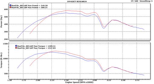

It ain't getting more closed than 95%. On tightly smoke controlled trucks, this can be a double edged sword because if the truck isn't making boost, it won't get the fuel either.... but that isn't the main issue. It could simply be that the volume is wrong under the turbo and until the turbo lights the manifolds won't shine. Once the turbos do light, i'd imagine there would be a pretty good "under the curve" power difference until the chargers become the restriction again.

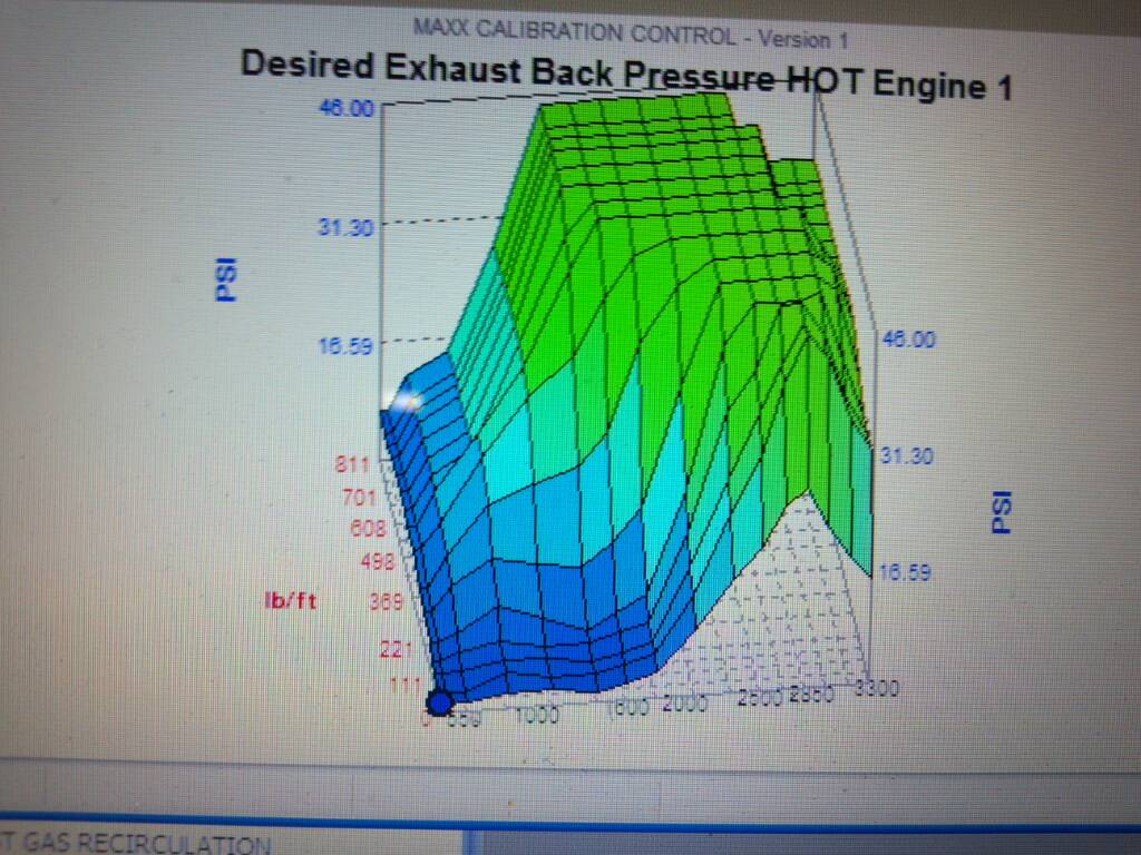

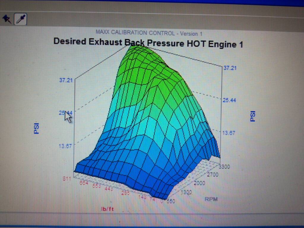

I don't think you understand what I'm saying. A stock vgt commanded bp file only holds the vanes at 95% for a very short time then rapidly dumps to 7% and drops velocity. This is a stock file.
What I'm saying is hold the vanes tighter for longer to keep velocity higher. To improve spoolup on the bottom end.Like this.
The only thing is you must have your gating set correctly to utilize this.
