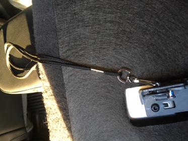

I did the poor mans latch
Coaches whistle lanyard, drilled hole in barrel bolt of latch, took headrest out and looped lanyard around hole for headrest and reinstalled headrest. Tether is out of the way hidden but easy to retrieve
