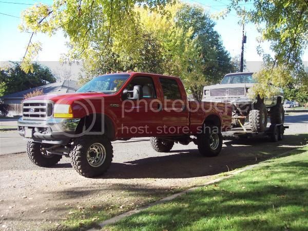

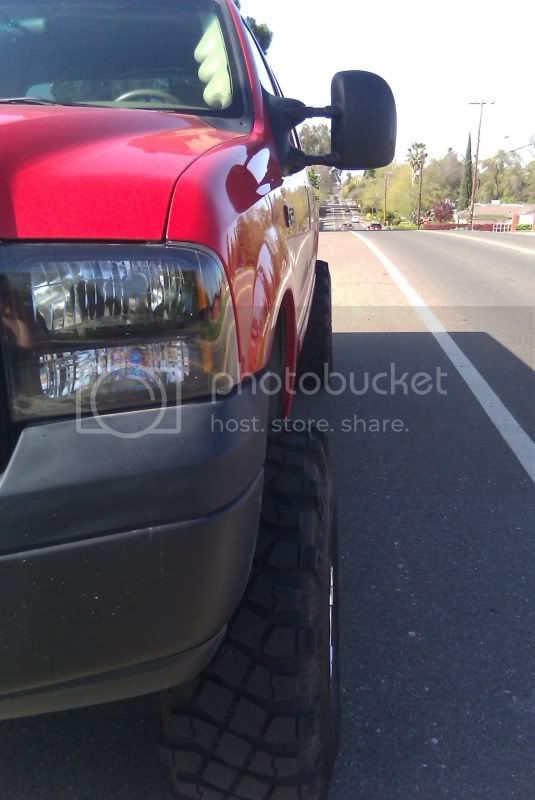

Aug 3, 2011 #7 RedSmokey New member Joined May 18, 2011 Messages 1,552 Reaction score 0 Location Sacramento, CA CTC DEEZUL said: any pictures? Click to expand... 37x14.00x17 Iroks on 17x9.75 rims with 4.5 backspace on 8" lift 38x15.50x16 tsl ssr on 16x12 with 4.5 backspace 325/85/16 xml (approx 38x13x16) on 16x9 with 4.5 backspace 325/85/16 xml on 16x12 with 4.5 backspace
Aug 3, 2011 #8 DEEZUZ NO PUKESTERS Joined Jun 30, 2011 Messages 6,847 Reaction score 187 Location NWI 4.5 looks good... I will keep you updated, dont want to ruin the surprise
