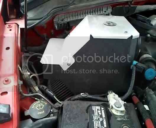

So I had a bad day today...
Got up for work, jumped in my work truck, turn the key to start... Click, click, click.
No big deal, jump in my 6.4, turn they key, cycle the glow plugs and start it.
I get this noise coming out of my intake...
I shut it off right away, only restarted it long enough take this video...
Not sure where to start.

First, get a scanner on it. Figure out which cylinder(s) its coming from. Depending on your scanner, it should tell you if its a miss or something else. Then, you can do a leak down and figure out whether its a valve or something else. Then, tear it down and see whats up.

Pushrod dropped off most likely. Happen to me a couple times. When you check it out, insect the rocker since the pushrod cup may have failed. Either way don't drive it or start it.

From my Dash Daq:
P0263 Cylinder 1 contribution/balance
P0284 Cylinder 8 contribution/balance
P0308 Cylinder 8 misfire

Sucks that its on both banks. Time to pull the heads and look for bent pushrods, or like Craig said, cracked pistons.

Sounds like classic intake valve. I know nothing about that engine, but I would be looking for a bent or loose pushrod or broken rocker on #8. Probably threw the other cylinder code because of the firing order proximity. I don't know the firing order for the 6.4, but if 8 and 1 are close, then having the previous, or following cylinder also fail in a contribution isn't rare.

I was thinking that in the back of my head, when the cylinder is on the power stroke it is forcing the air back though the engine.
I was hoping for a bad harness or something simple, but it sounds like the cab is coming up or i'm in for a treat cab on...:doh:
