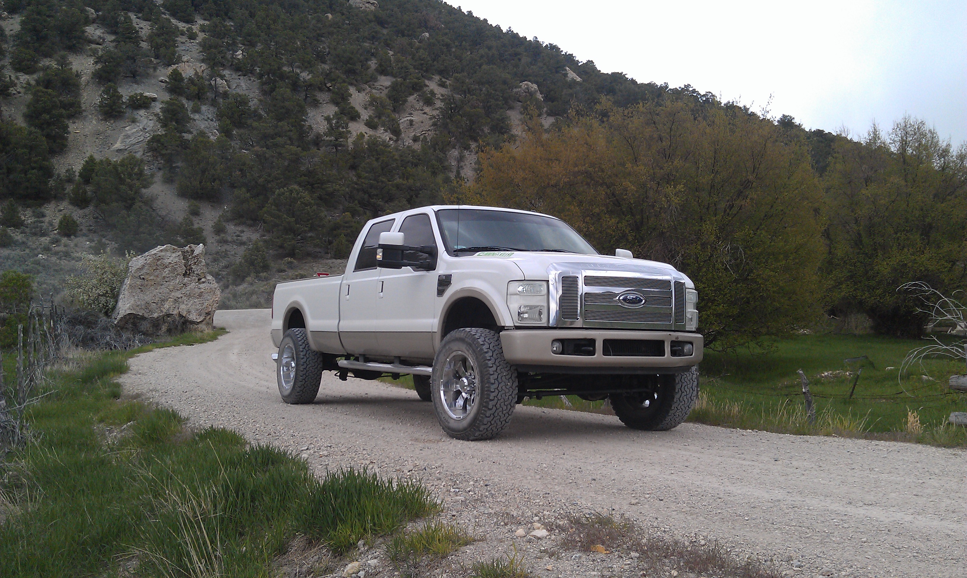

My brothers 6.7 an my 6.4
Really like this 6.4 light, and the one like it (from earlier in thread), but no reflector shining through. Can't decide between all the options. All black, the two mentioned, or something different. I want to start on mine in the morning. I have a CCLB white 6.4 xl. I got new headlights to do this, so I'm just trying to figure out what colors I want, and then get the stuff to do it all. Possibly thinking of leaving a portion of the reflector sticking out, with a decal type thing, like put some tape over the reflector in a way that it says ford or superduty etc etc after I paint it and pull the tape. Any idea that way? I could always paint the "decal" after the original paint dries, so it's not white with a orange Ford sign etc.

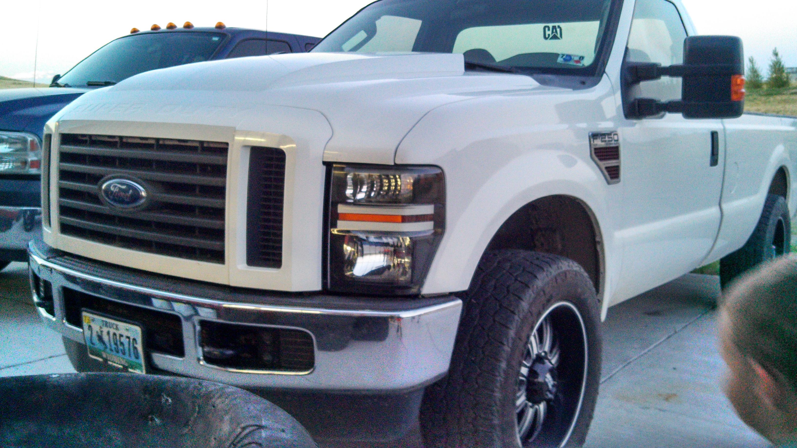

I need a little help here... I have a white xl cclb and here is what I have. I painted my headlights, and here's one with the pinstripe tape taken off, and the one without it. So one has the edge and one doesn't. I haven't put them on the truck yet, but here's the basic look. (this is not glued, just fitted for looks) The photo is a little funny here. The white stripes look a bit better in person.
Isaac313
Sep 12, 2014
28
Turns out, the white stripes don't look so good on my truck.... :(
Anyway, I just painted them both all black, with a white reflector. I'll try to get some pics on the truck soon, after I glue them back together and install them. I also have to finish up my pigtails, but I'm almost done.
