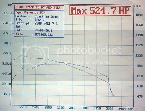

Jonathan has done it again. This time on his personal truck making 524.7whp the other night on the rollers....
Mods to the dually include:
BDP 250/100's
Comp 910's
Hypermax Pushrods
ARP Head Studs
BDP 3" billet intakes
BDP Super Duty dominator 66 w/ 1.15 Non waste-gated housing
BTS transmission
BDP 6 position Chip
Stealth Stage 2 HPOP
BDP Regulated Return Fuel System.

This is good to know. I just ordered a D66 and one day will have Hybrids.
What boost/drive pressures did it hit and how much TQ is that? 1125?
