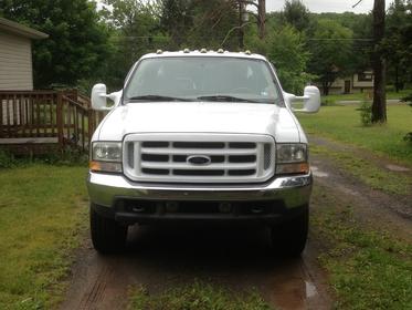

im not big on picture taking while working on stuff but ive got some.
