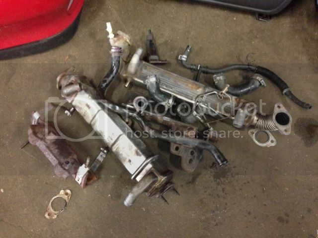

not sure what truck you got, but mine had band straps holding mine on.
This is all the crap you can remove. There are multiple brackets that hold the clamps. If you look to the left you'll see the bracket with the band clamps you speak of. Those band clamps are riveted or spot welded to that bracket.
