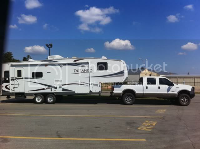

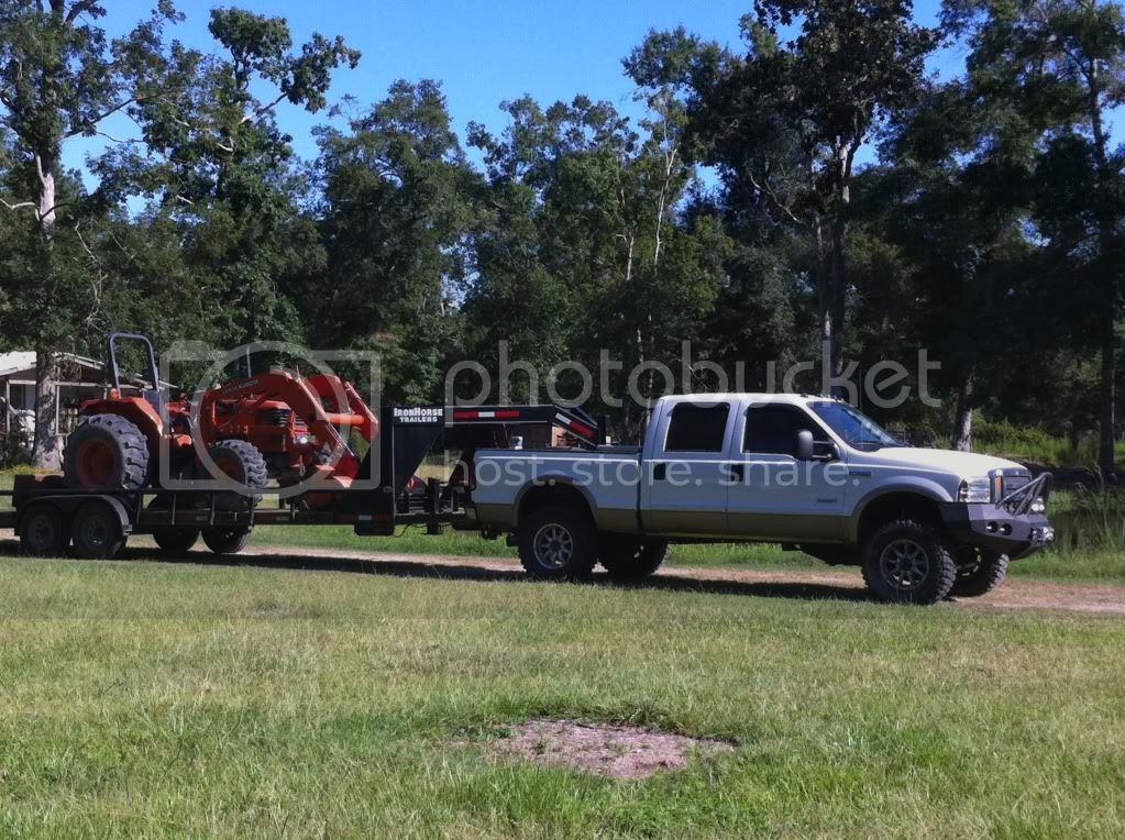

Based on the LB, I'd go with the B&W Companion, which would give you a very clean way to use the bed without the rails getting in the way. If your towing up to the limit, you may want to consider upgrading to a 4.10.
I considered going with the goose neck my truck came with, but my RV is too big to convert without voiding it's warranty.
