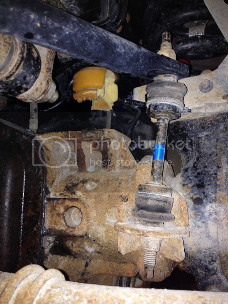

So the majority of people say the Bilstein 5100s ride firm? I put a set on the front of my truck because my shocks were gone after 30k miles, along with new bump stops. I will say that they made the ride easily 10x better than before but they still ride too soft for me. I only did the front because I'm wanting to do a 4.5" lift by next month and my rear shocks have a little bit of life left in them but not much. I'm thinking going with the Carli Backcountry (5160) kit. Any opinions, I want a firm ride and need something that can handle a beating.
This is what was left of my original bump stops after 30k miles

If I did that to bumpstops, I would be trying to get on the stiffer side of a shock. The fact that you say your 5100s are good means you probably NEED the stiffer shock. I would definitely be looking for a 2.5'' shock if I were you.

If you are abusing the truck that heavily and putting it through its paces I would push you to the pintop 2.5 or coil over. The 2.5 shocks will help soak up the suspension cycles. Skip the 2.0 shocks including the bilstein.
Tree'd by Eric. But this is exactly my advise.
