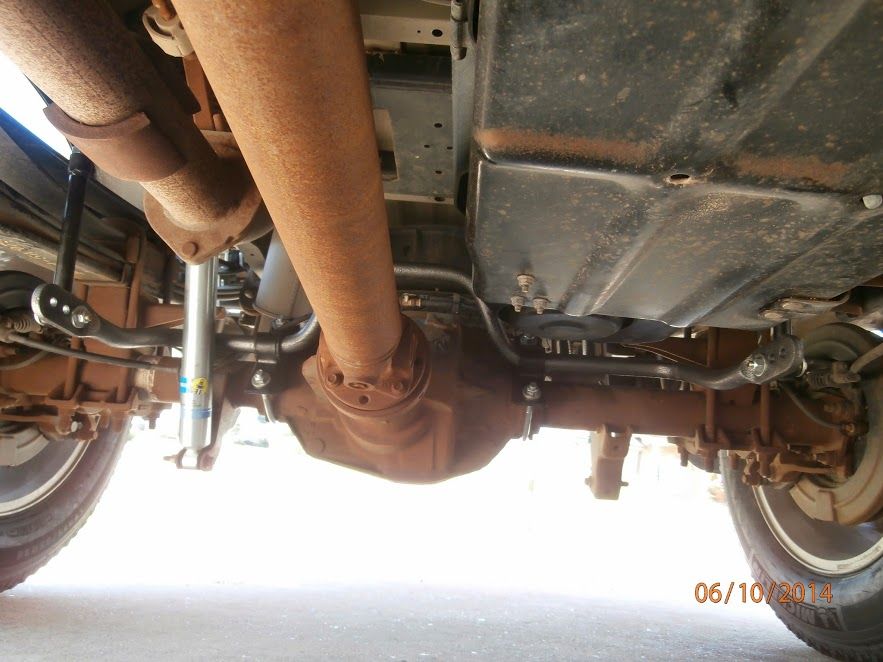

Will everything clear my carli long travels? Im going to order front and rear just wondering if ill be good on the rear, throw a pic up of that dually setup id still like to see it

Big wig mounts like the OEM
it's just thicker by a bit

Correct but the sway bar mounts in the same location as the factory one. Don't know if mounting locations are the same on a SRW as a DRW. I given the factory swaybar to my friend that has '15 F250 but he hasn't picked it up...he's attached to a ball & chain and needs permission. So I can't say if the sway bar is the same on a SRW.
I didn't do the front sway bar yet, just the rear.

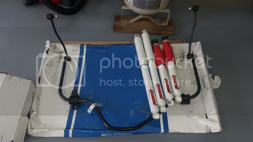

That looks like for one that didn't have a stock one.
Looks like you have the threaded holes in the bottom shock mounts for one. I wonder if it's has to do with stiffness of the bar since more bends up and down.
I knew the diff was different just thought dimensions were the same just the length of the tubes.

UNBROKEN
2,788
The rear bar is its own thing. It comes with all mounting hardware and doesn't use anything stock. The last pic posted is correct for an SRW and he has it set of the stiffest setting.

I don't know if it helps or hinders but we have a 2016 f350 DRW and the rear sway bar is mounted above the pinion, in front of the diff whereas my 2012 is mounted under and behind the diff

My old ass truck here is in front and up/over the pinion. It works great. Id emulate that for the rear.
