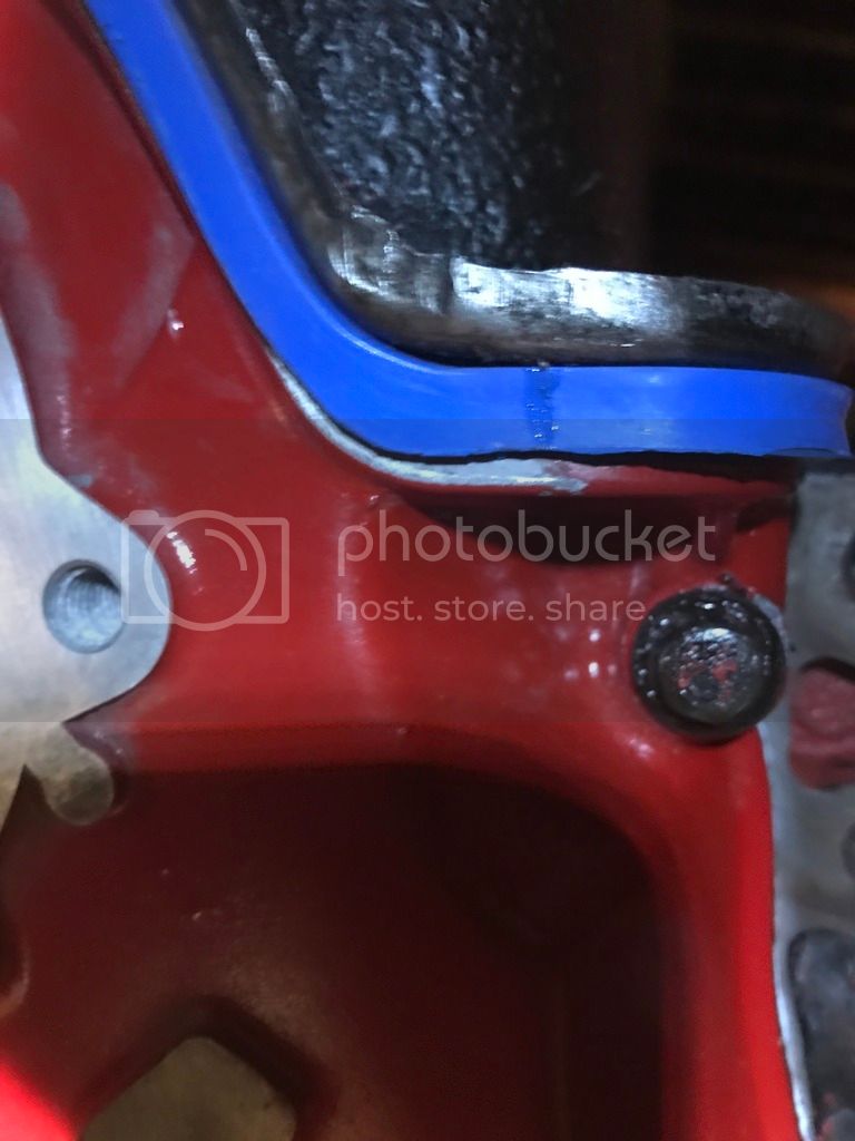

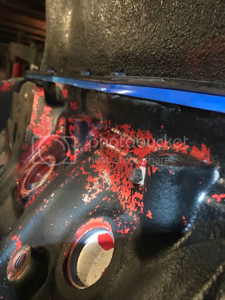

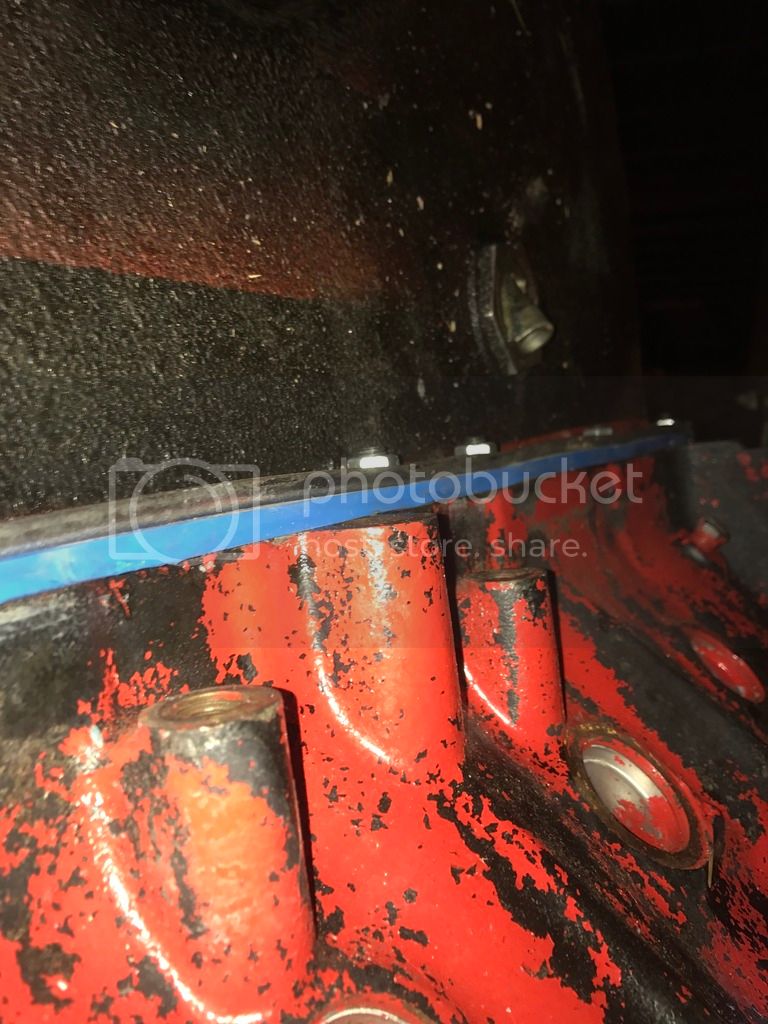

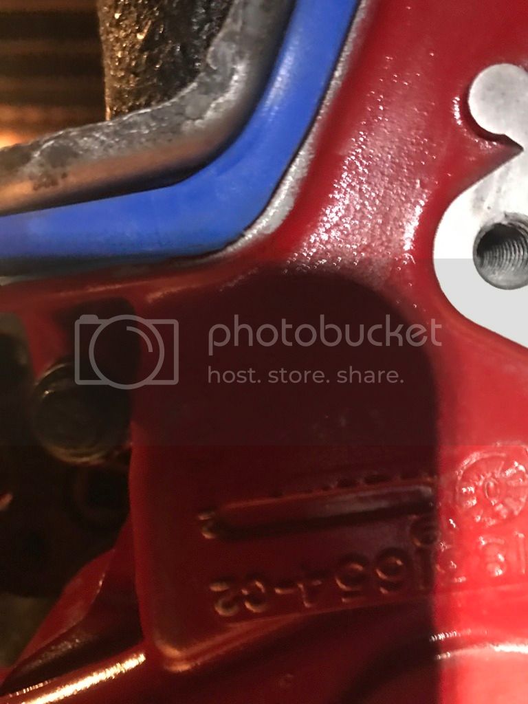

Couple pics of the gasket:

The front cover almost needs studs tig welded there in the corners. There is not enough fasteners to use a gasket imo.

oh man does that pan gasket look like troubles. Keep us updated
