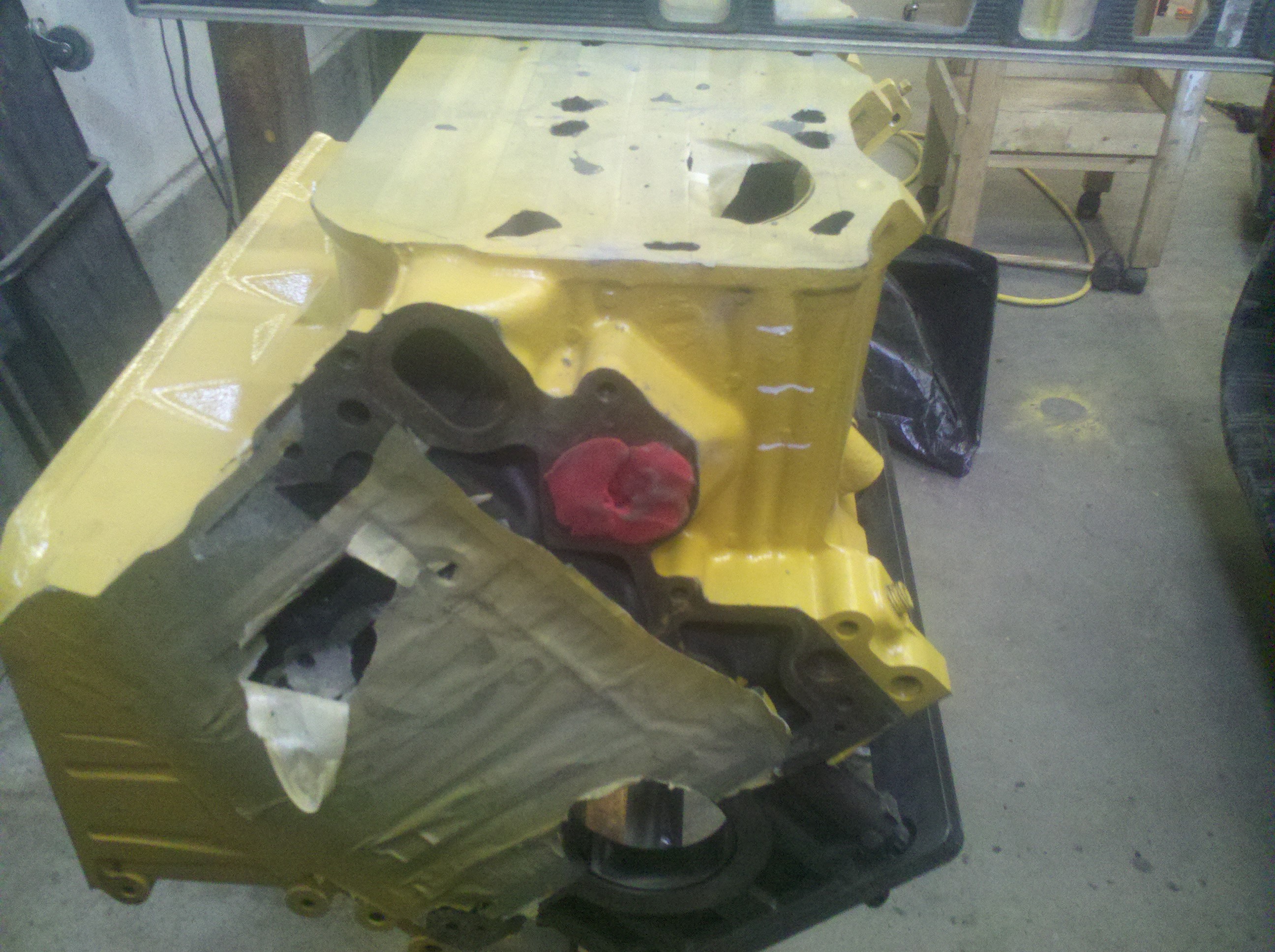

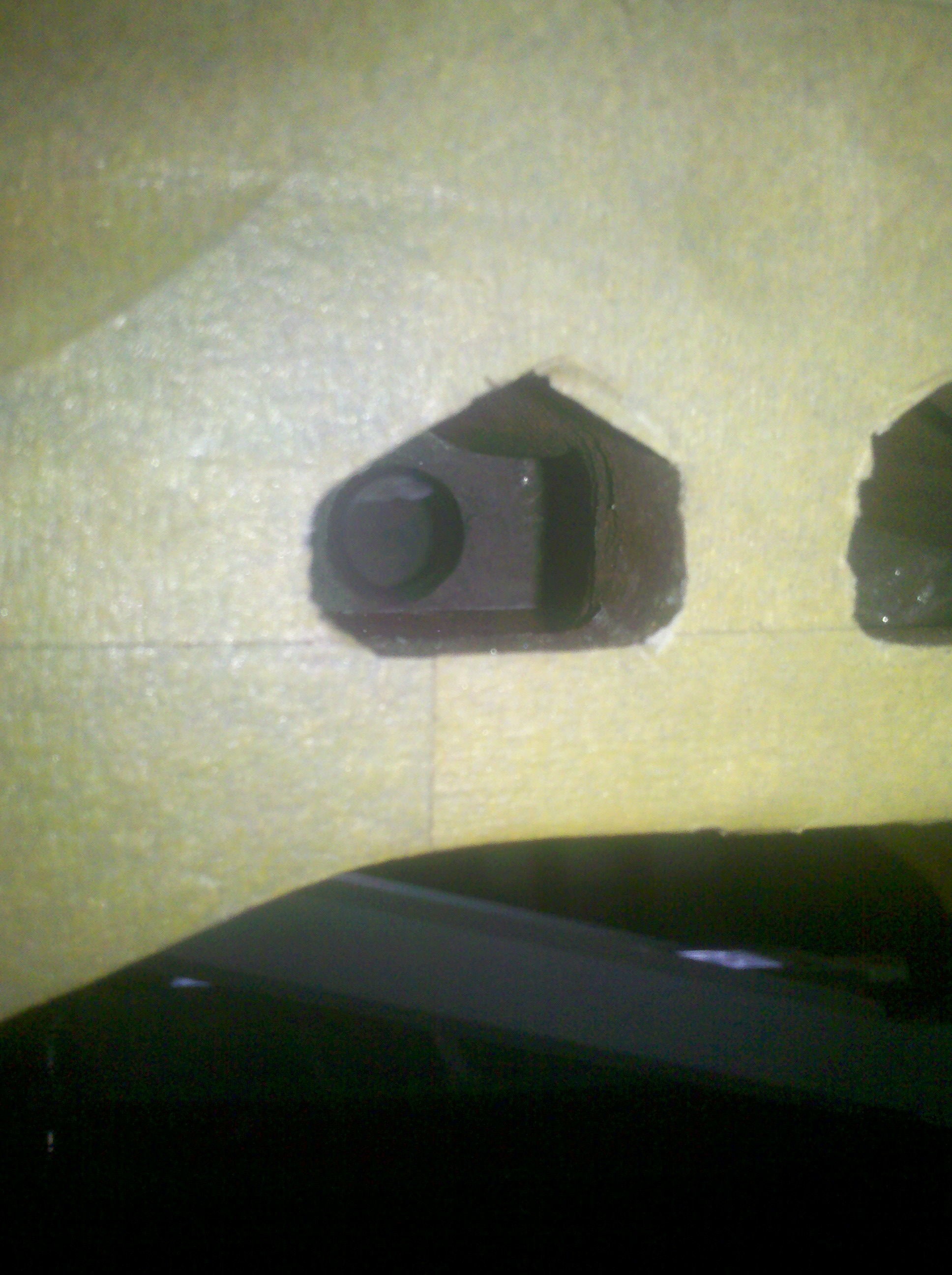

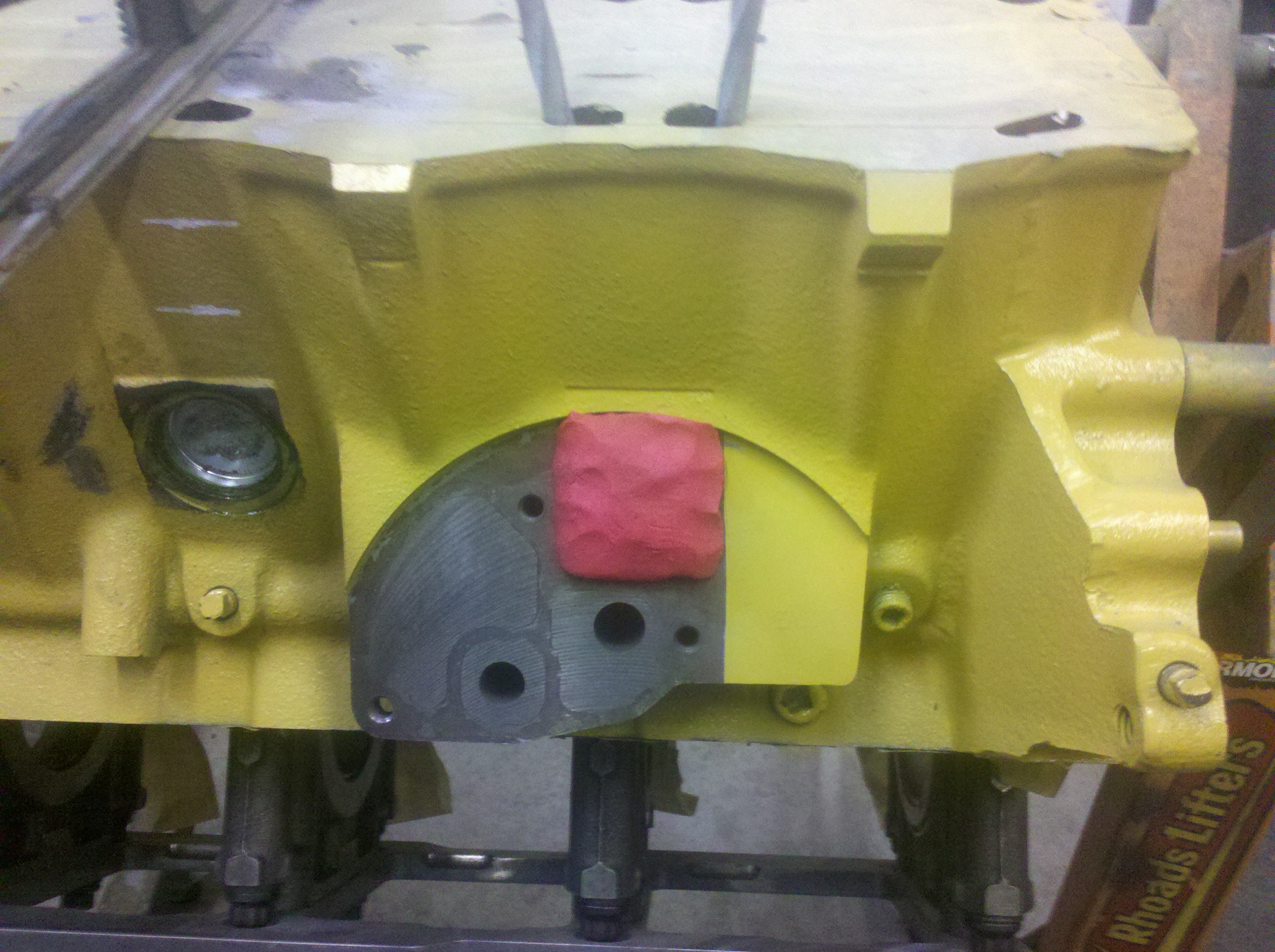

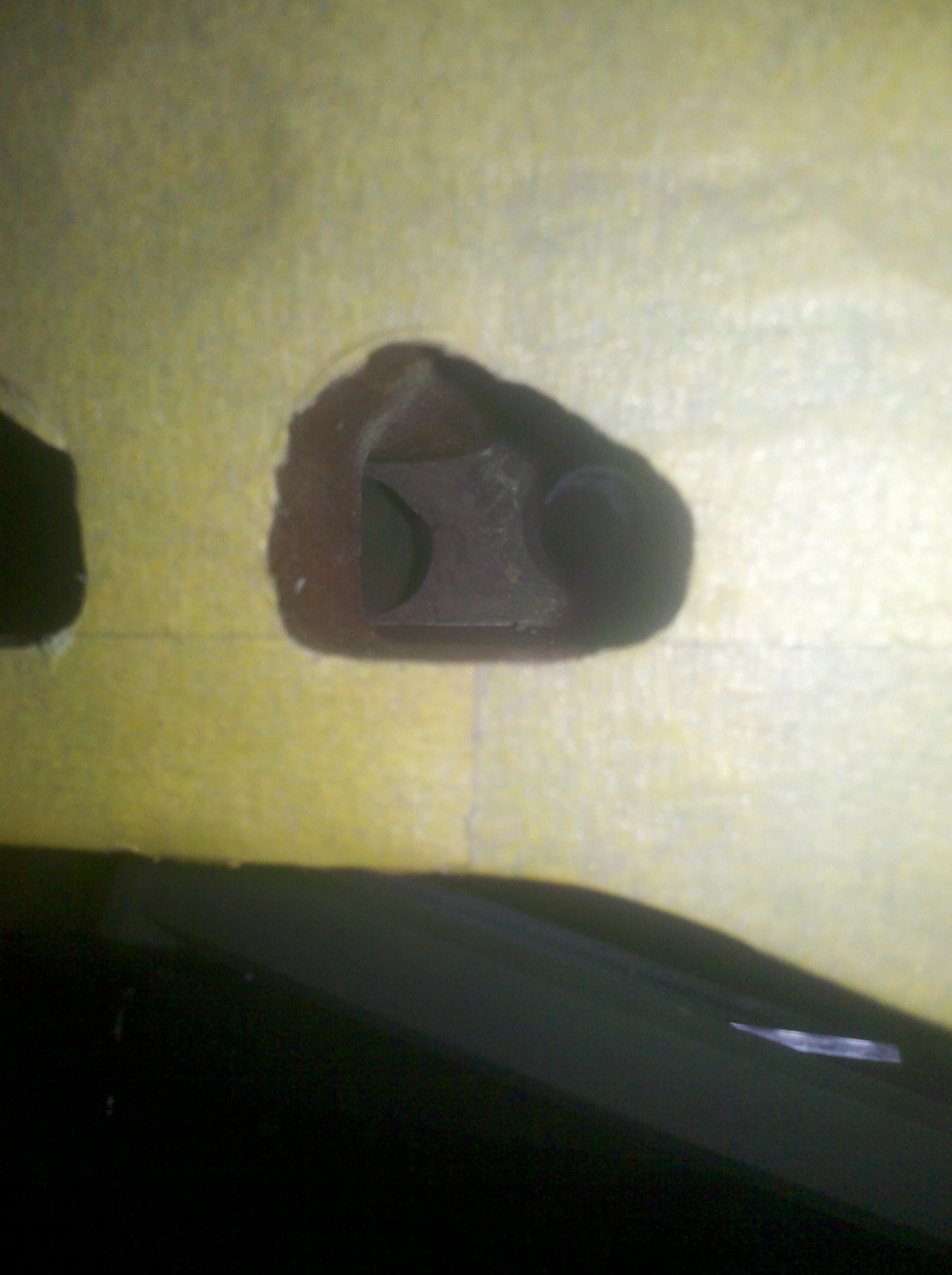

I used some plasticine from Michael's craft store to make some plugs for water passages
poured the DS today

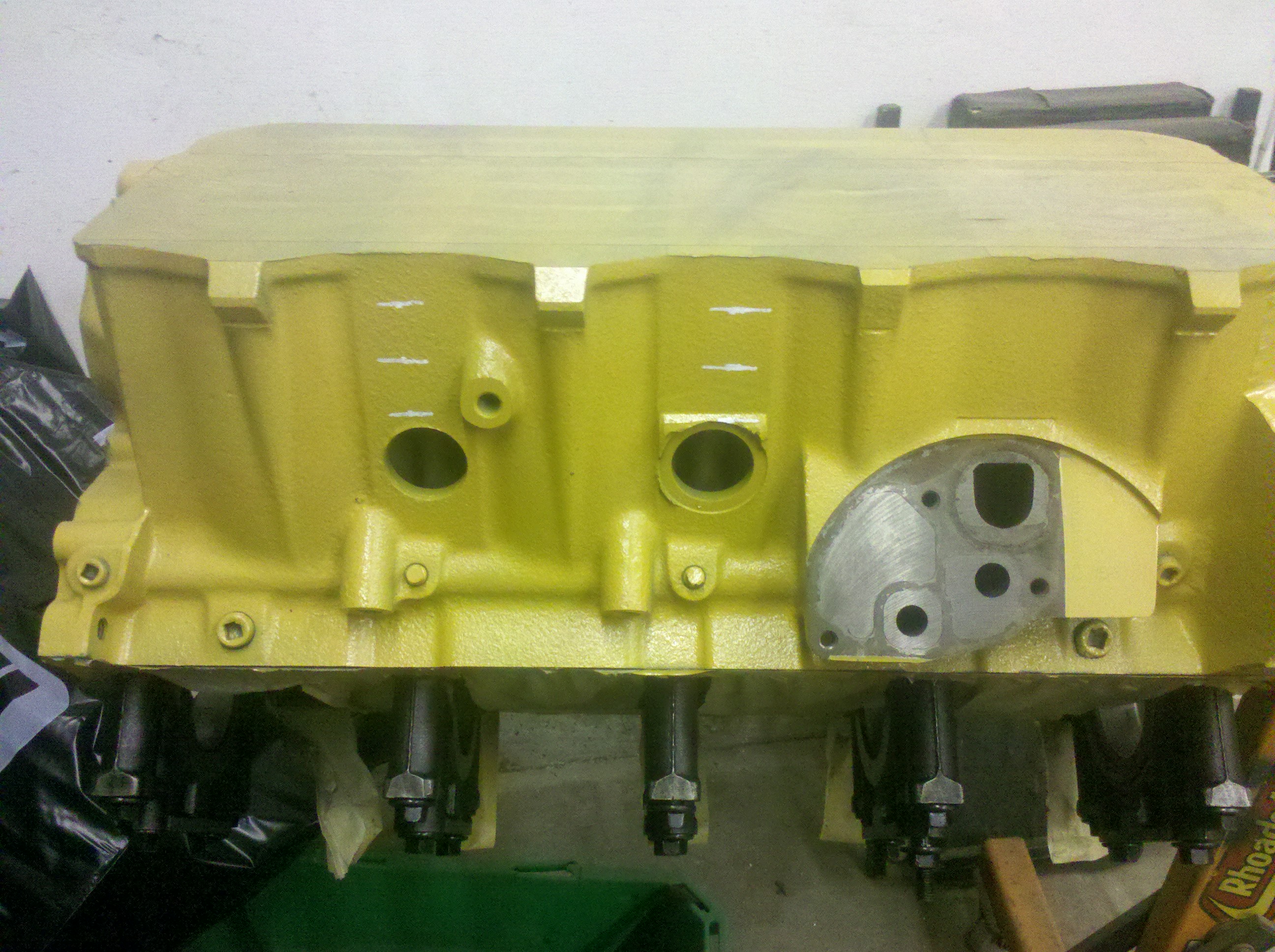

that grout is kind of scary to work with. it stiffens up very fast.
the fuel hose pulled out nice and clean. pretty happy with how it turned out
poured PS after work to day.
