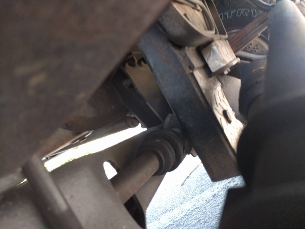

Both the front shackles are bent, can the leaf springs be adjusted left and right on the axle?Or is there a pin in the axles the leaf springs align with?
Part of me thinks whoever messed with them last didn't align the leaf springs so it put to much tension on them?
Obviously I am going to replace them but don't want it to happen again. Do these look like the stock size shackles?

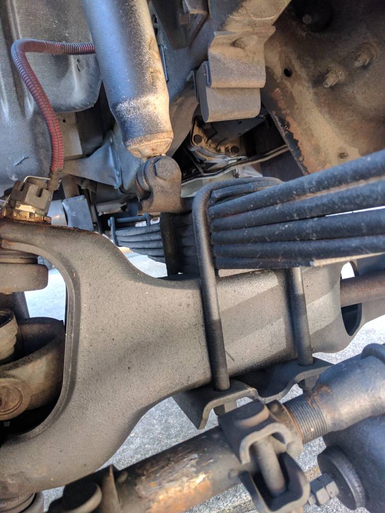

Thats the TTB Axle. Looks like someone installed different leaf springs. The oem springs are inverted and tapered d to deal with the flex of the beams. I hope someone didn't just throw in some solid Axle leafs. Also the bushings may be shot by looking at the angle of the spring sitting in its shackle. Most dump the TTB for the D60 Axle. I kept my TTB and did a 5" RSK. I bet it rides like a tank the way you have it setup.

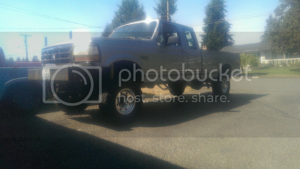

Here is how the truck sits on 32s, any idea which lift option for this kit would keep it at the same?
I seriously know nothing about this suspension setup vs stock

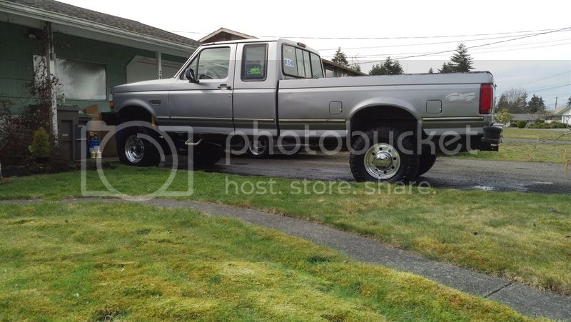

Here is mine.

Get the PMF 2.5" RSK, and Super Duty U code springs (I bought mine used). Should keep it closer to your height. Get us the measurement from the center of your hub, to the top of the fender opening. I will compare to my 97 CCSB measurements, when I get home today. And will post a picture of my truck's height for reference.

Looks like just about 24.75" on 32s.

I think that there is so much twisting and binding in your front leaf springs that it has extremely worn your leaf spring bushings, even though they appear to be poly bushings.
Also, and maybe it isn't as bad as I think, but it really looks like the camber adjustment bushing has the ball joint really angled a good amount.
I still suggest going with a D60, RSK, and super duty leafs. It will ride better, have better articulation, and less tire wear. Not nearly as many moving parts to wear either. With your current configuration, it looks like if you replace the leaf spring bushings, they'd be difficult to get the leaf spring bolts back in, and it would just wear the bushings out again prematurely.

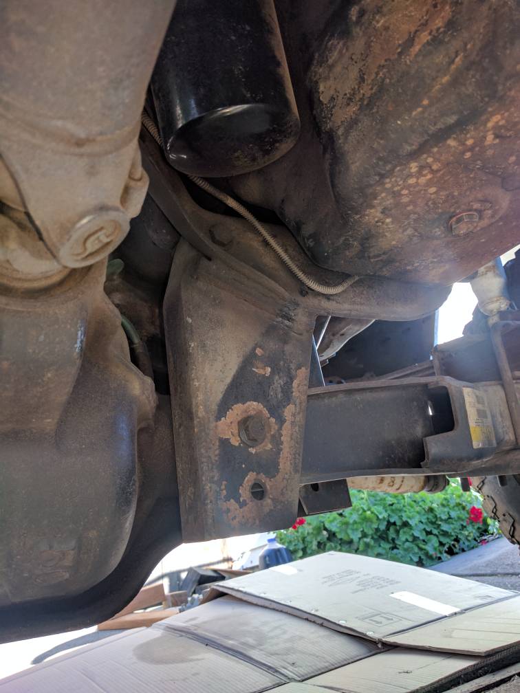

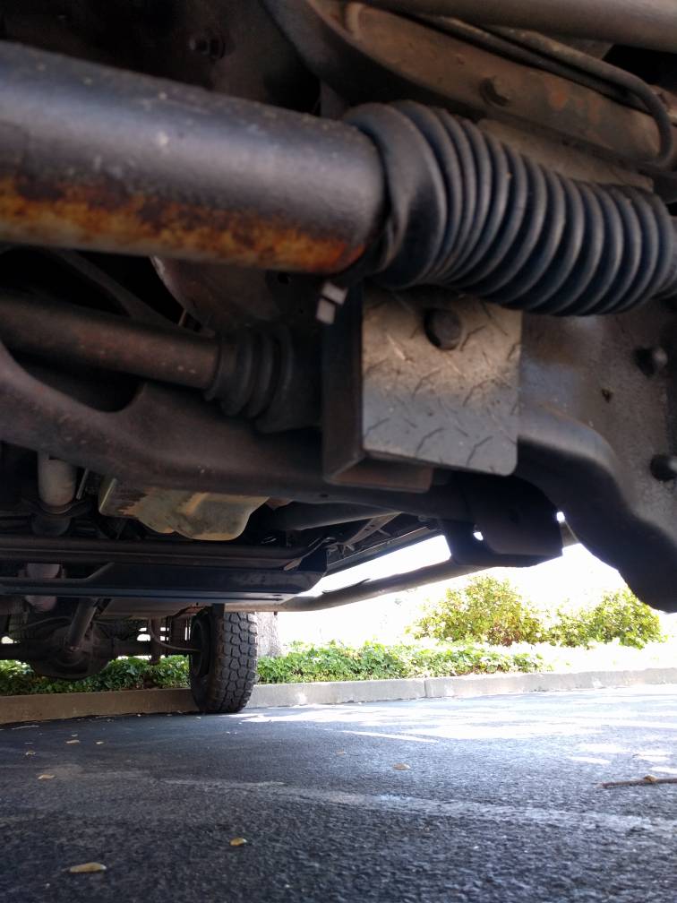

Yeah I definitely did the measurement right, idk why I was thinking tire size mattered haha. Is this the bracket?

Someone else who knows more about the Dana 50's should chime in, but here's my guess. Those may be an actual manufactured pivot drop brackets, but they look homemade to me. Factory pivot brackets wouldn't be welded to the crossmember either.. I'm guessing that they are way too large of a drop bracket, and the springs are also not factory, but still not giving enough lift to equalize the pivot bolt drop, so it's twisting the springs excessively, and also giving the truck a lot of negative camber, which is corrected by those camber bushings.
Things are way out of whack for sure.
You could buy an actual branded F250 lift kit to be installed, but I still vote for Dana 60 and RSK. Get that TTB out of there.

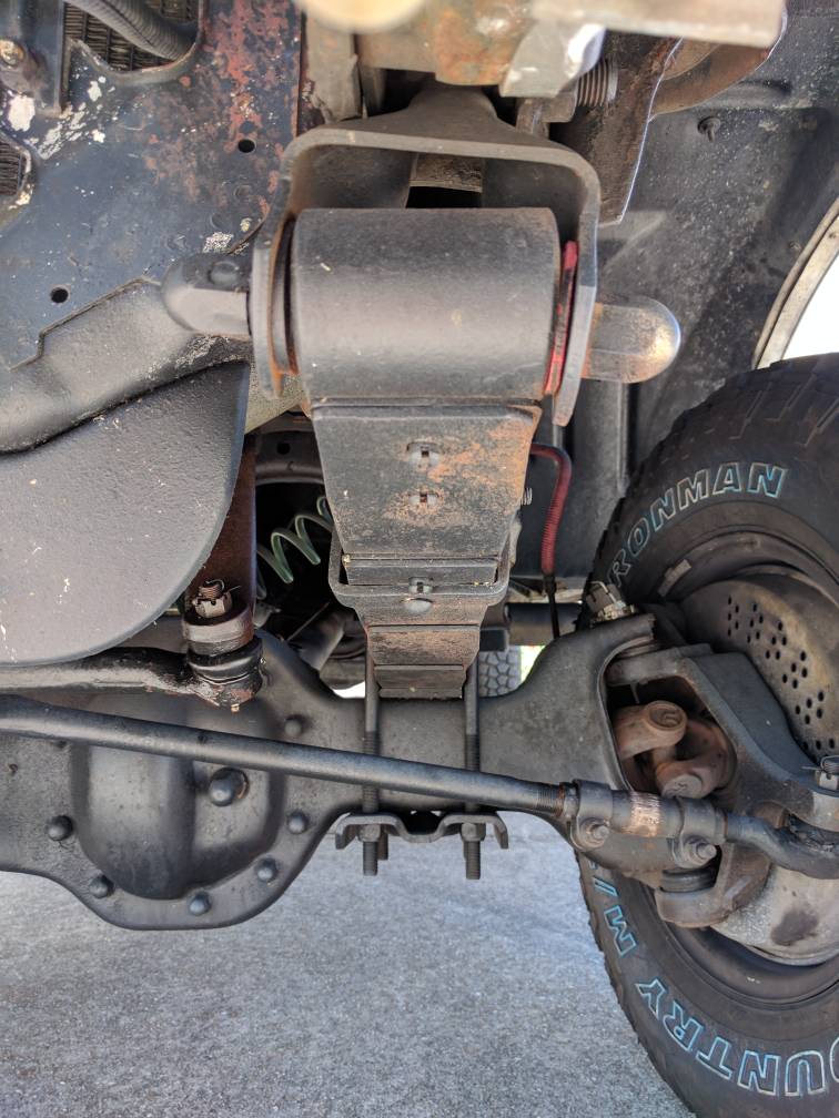

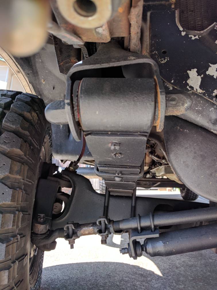

On level ground, hold a level or ruler across the width of the leaf spring, near the ubolts. It should be level or very close to level with the ground. Yours look like they are not level , but that's because they are twisting. And all of that twisting force is exerted on your leaf spring bushings.

Those are the same drop brackets I have. They are the Skyjacker class I brackets. They are in fact the best thickest stronger drop pivot brackets you can buy. Many of the other drop brackets are much weaker. They are supose to be welded to prevent cracking of the cross member. In fact I think you have a compete skyjacker lift kit on that truck. I have those same brackets along with the 5" RSK and stock leafs. The brackets allow for 4" and 6" lift as you can see there are two pivot bolt holes. Skyjacker also makes a one piece class II drop braket/frame. I would roll in a D60 with RSK or either do what I did and install the RSK and stock TTB springs. The cool thing about RSK with a TTB is you can bolt a D60 Axle to the same RSK kit if staying with OBS Springs. Using superduty Springs on an OBS uses a different RSK kit. My ground to fender clearance is 43" with the fake 33" tires (255/85/16) and 28" from center of hub to fender.

Yeah. I can get you some pictures latter and some measurements. I don't know how the lifted leafs and RSK would work out. The stock springs with 5" RSK basically lifted it 4.5" from over stock height. The beams lay pretty flat in my configuration. The stock leafs are much thicker in a tapered design to accommodate the TTB twist. In my opinion aftermarket leafs on the TTB don't work well as you can see in your own pictures. The stock TTB leafs are inverted from the typical leaf. Also I use the 4" drop bolt hole on the pivot brackets as does yours currently. If you have lifted springs you would have to at least use the lower 6" drop pivot hole. This would put the angle of the beams at a very unknown angle. May or may not make alignment a problem. Also with that far of a drop you may need to extend or relocate the brake lines. The TTB rides best as man. Have said when at ride height the beams lay flat and the tie rods lay flat as possible. The more the tie rods are angled the more likely the tie rods to pull the tires together under suspension travel and can cause faster tire wear. Mine are at a slight angle with a standard drop Pitman arm but I have no tire wear issues after having a good shop dial up the alignment in. Getting a good alignment on a TTB will really save your tires. The shop I used did a great job and handed me the before and after specs printed out for me to see. One year of daily driving and my M/TS are wearing evenly.
