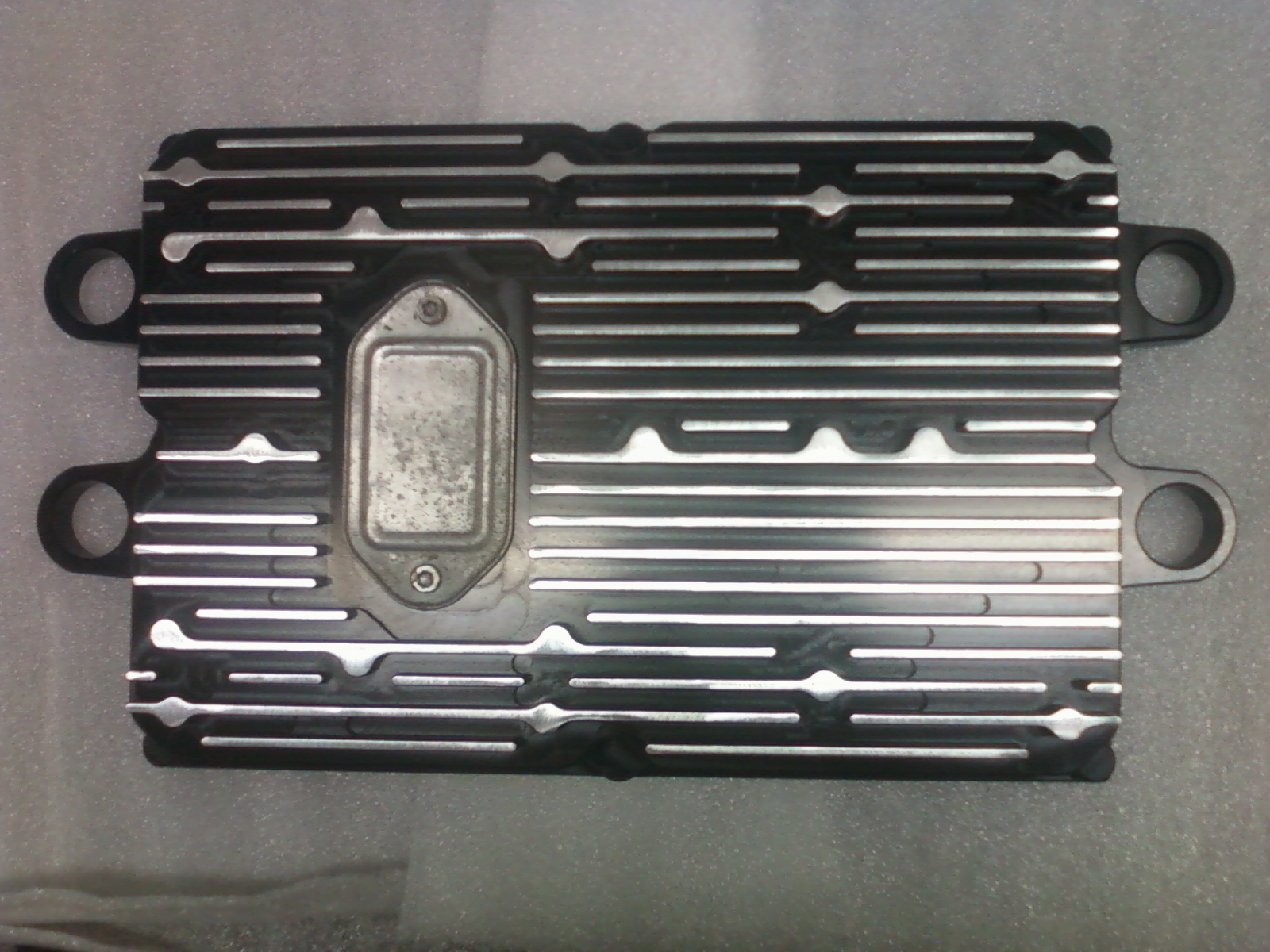

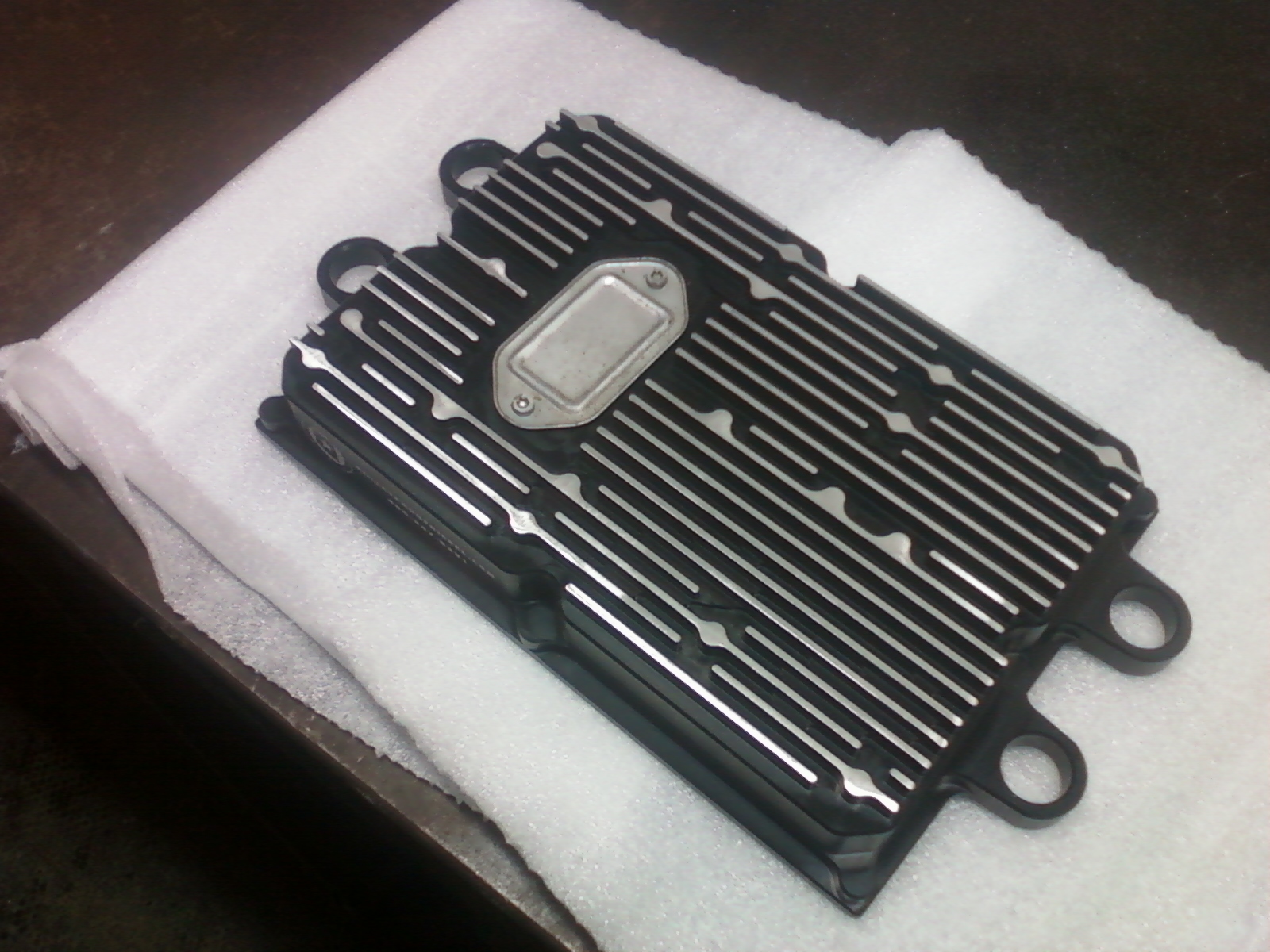

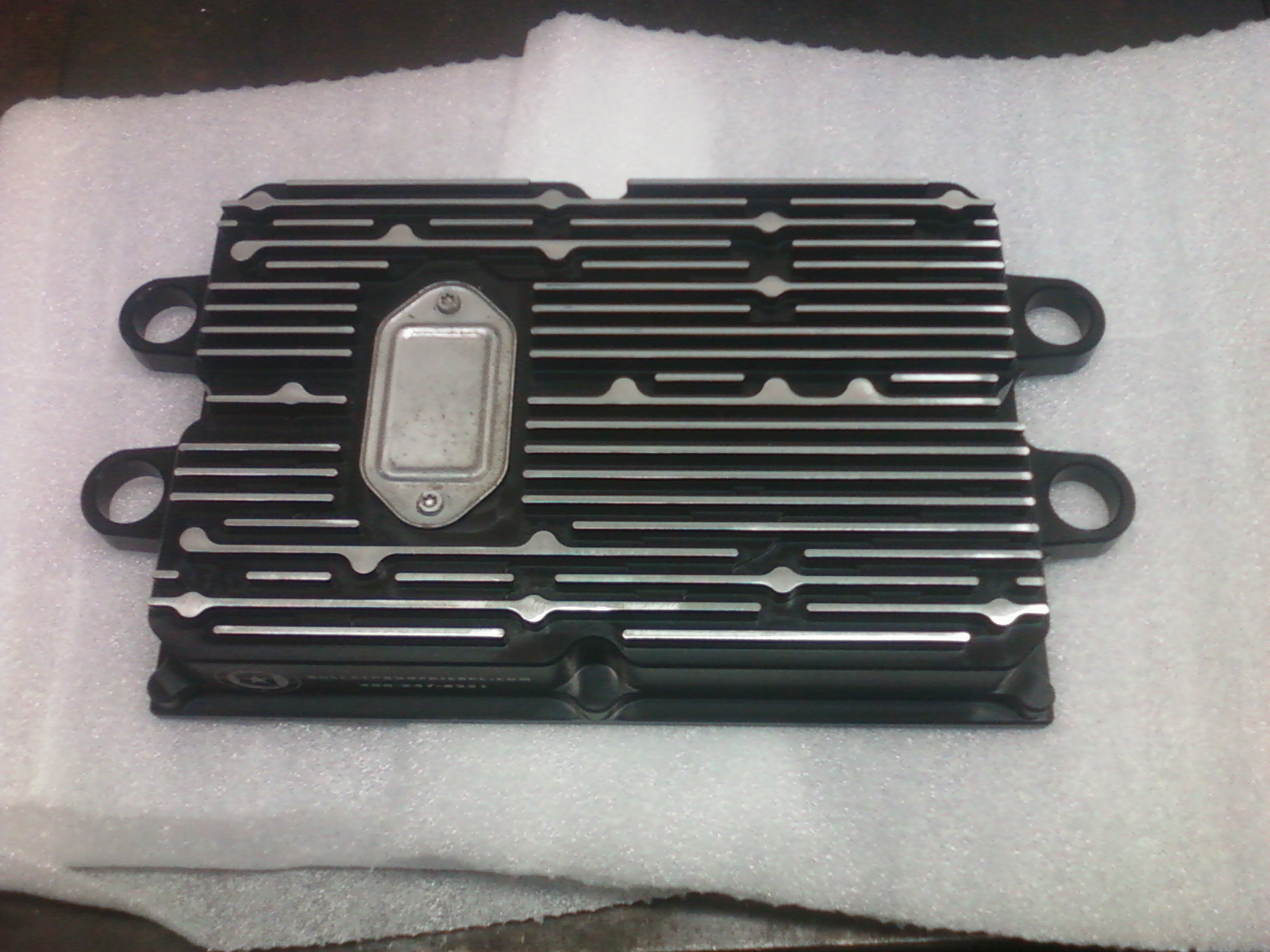

The people that know me....know that i'm just as much into making things look good as i'm into making some power. I thought the BPD FICM looked kinda boring being just black. So i had an idea...and not sure if anyone else ever did this to one of the BPD FICM's yet. But i decided to make it look like the mag hy-tech tranny pans and diff covers. I ended up taking a cookie wheel and skuffed the tops of the fins. Here's a few pics of what it looks like. Let me know what you guys think.

There are dyno comparison sheets kicking around somewhere, I think KEM did them? If I'm not mistaken, the 58v just moved the power to lower rpms. That would just show me that the choice should be made on preference and application
strokin6L
2,979
Springville NY
Yeah Morgan, the 58v FICM has shown performance results just like the tuned FICM's have. The 58v FICM has shown to increase power, throttle response and fuel milage just like a tuned FICM would. However if a guy already has a tuned FICM(such as myself) and then installs a 58v FICM...i'm not so sure if there'll be much more if any increase in performance or MPG's...other than just better starting in cold.
