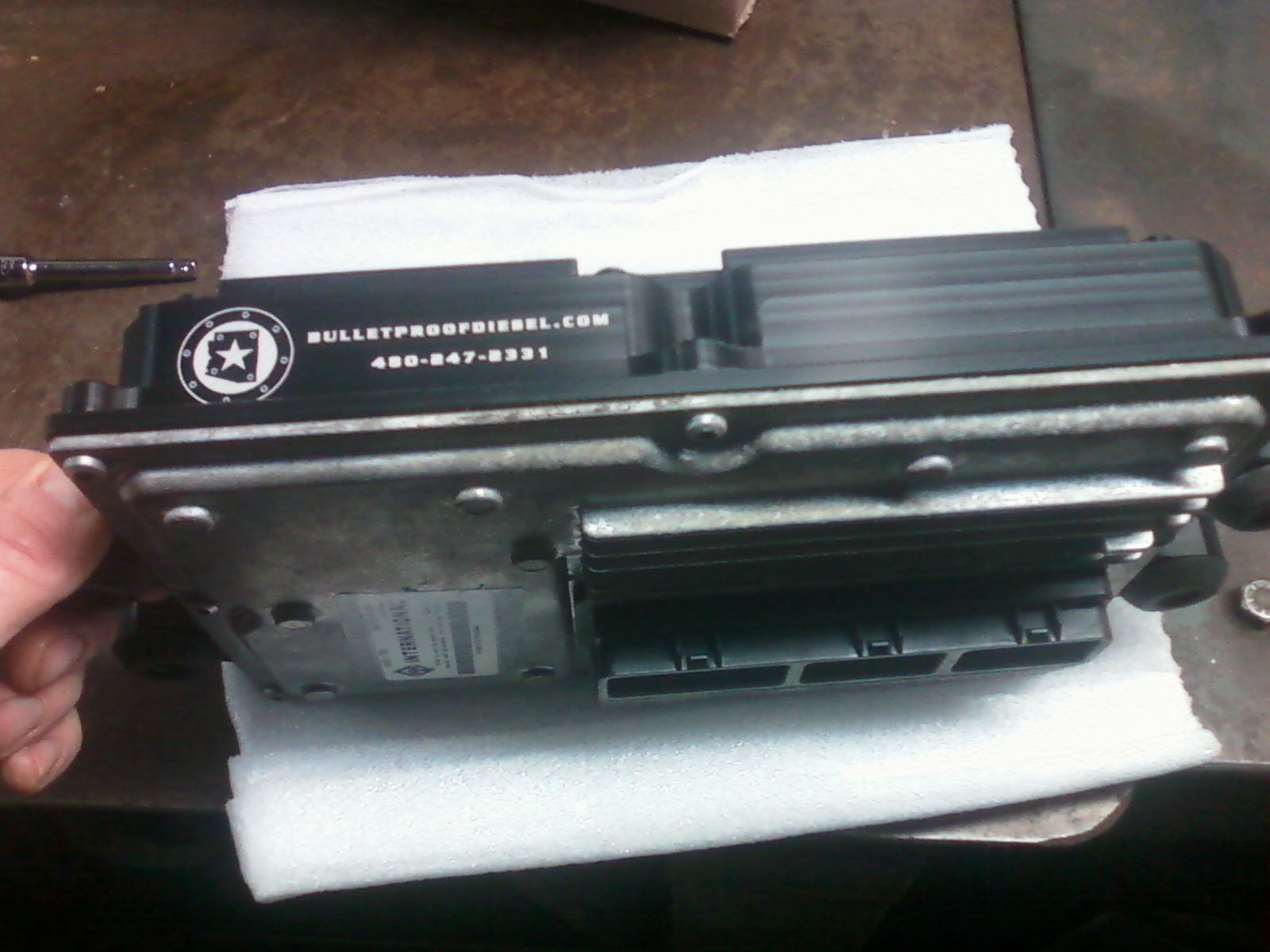

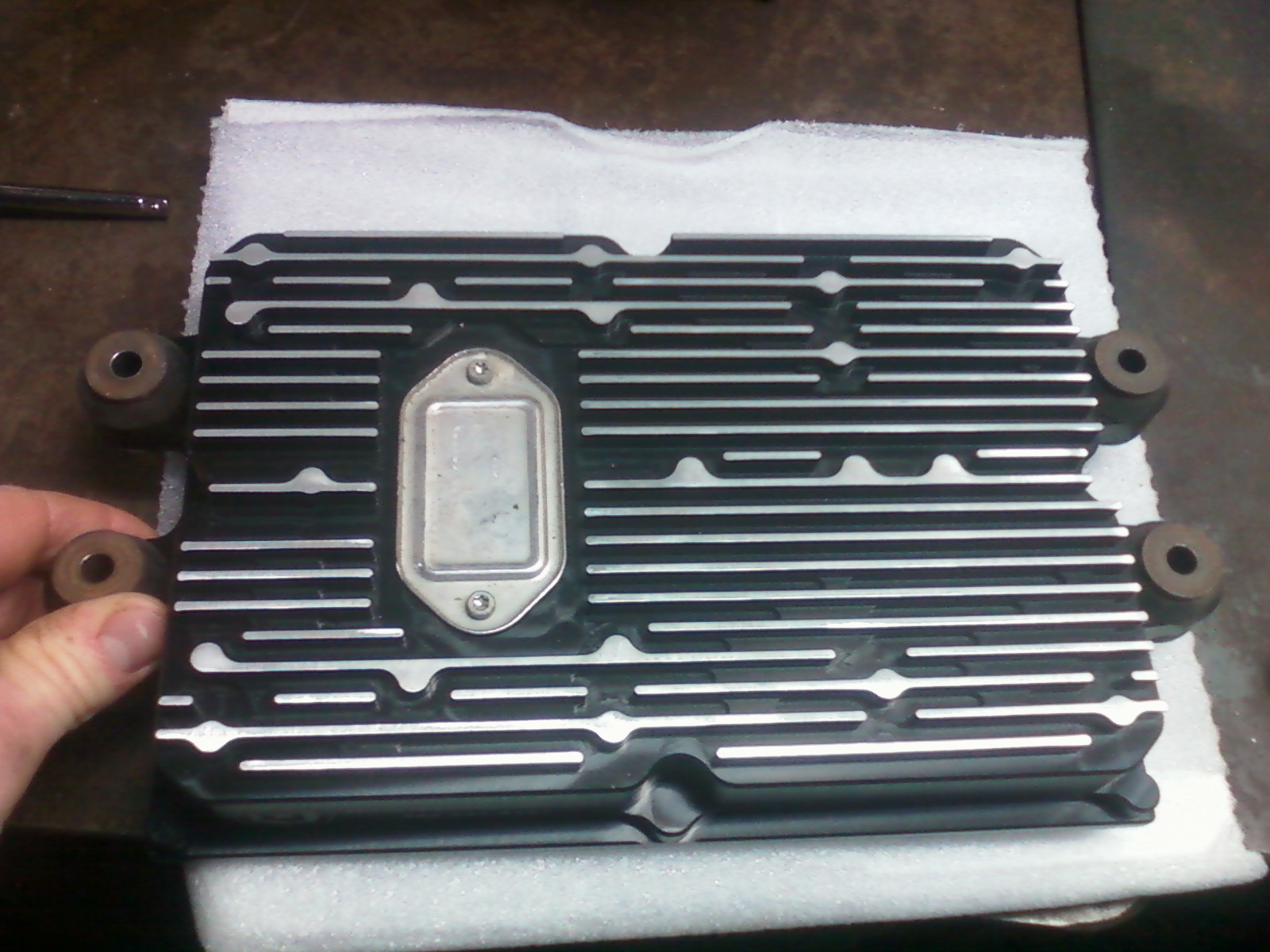

well, i got the BPD FICM bolted down to the other half. I now have a BPD FICM with ID FICM tuning. However i didn't even start the truck to see how it does. That's tomorrow's job.
