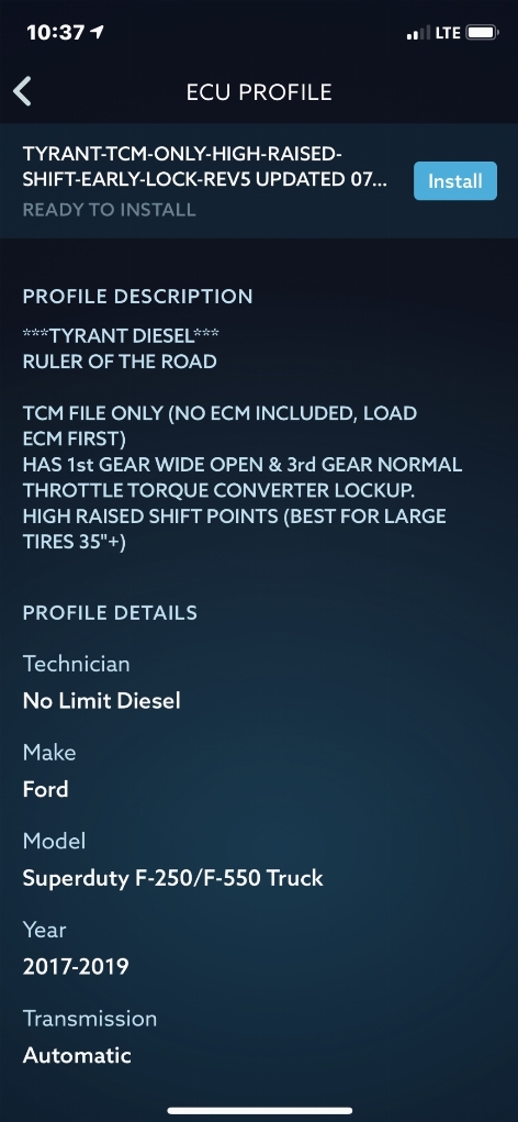

How is that truck turning those big 38's now? Do you feel the need to re-gear the truck with it being so big or does it feel OK still?
harrelljr99
Aug 4, 2018
115
Feels good. I installed this TCM profile from Tyrant awhile back and like the shift points much better.
