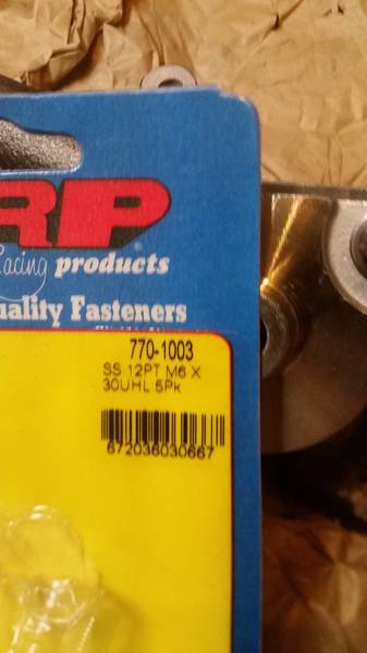

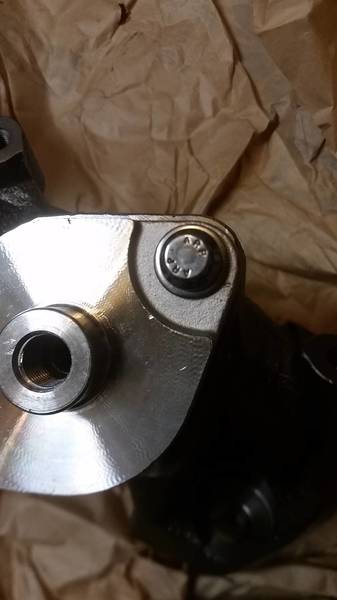

Collecting the rest of my parts for my turbo swap I realized the ARP bolts I used for my intercooler piping kit actually work for my egr blocker plate. So if yours has a blocker plate I highly recommend using these ARP bolts to avoid any future broken bolts. These are the ARP 770-1003 and are stainless steel 12 pt M6 x 1.00 30mm bolts that come 5 to a pack with the washers. These worked perfectly with my plate and have a 170,000 psi.

I would think this would work on a stock truck as well if you want to ****** in the future.
