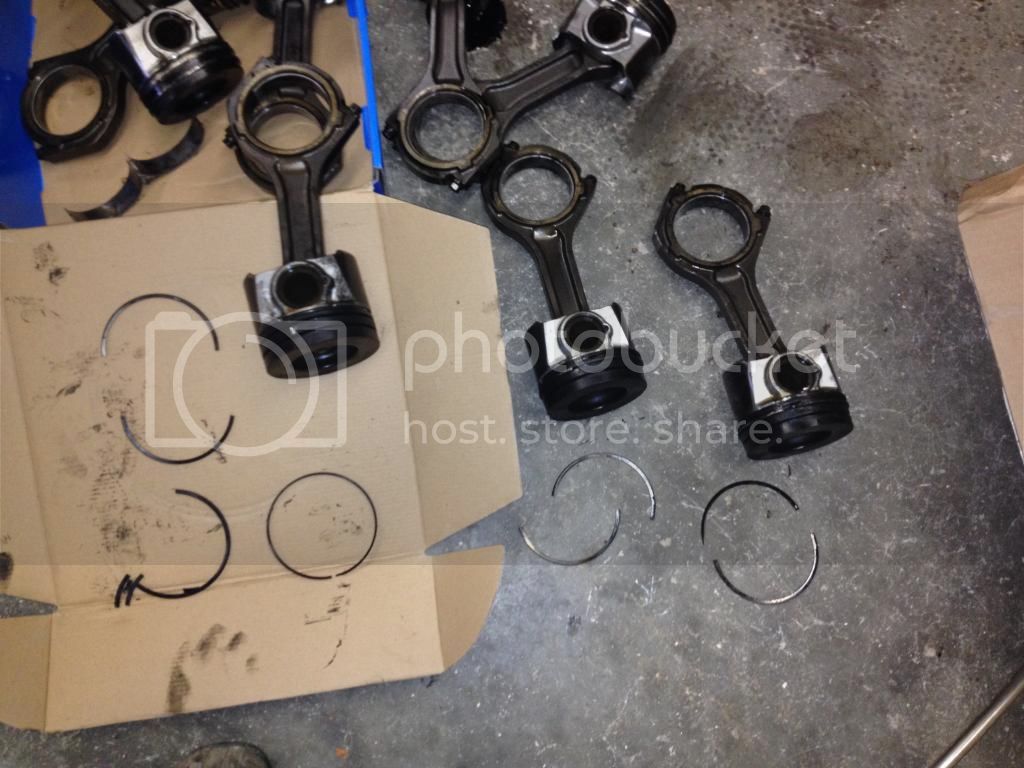

My cracked piston turned out to be both rings on #2, top ring on #5 and top ring on #8...I suppose that's why it smoked so much. New pistons on the list among a few other things, may as well its all apart now!

did it mess up the top of the cylinder? Pretty common for them to chunk it out and force you to bore the block or sleeve it

Yes, looking like it. Hoping the block checks out good enough to use std bore pistons, Id like to put the HD ones in but there are only available in standard bore.. what is everyone using for oversize pistons?
