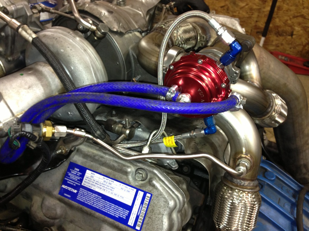

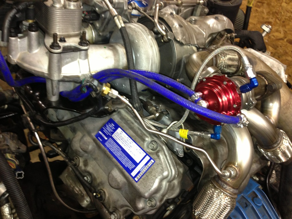

Is that EBP tube being supported by anything? Id be kind of concerned about it vibrating and cracking. But its hard for my to tell if there is anything supporting it. Looks great. Def like the color combo and braided line. Cant wait to see it in a week!! :bowfast:

That cab is gonna have a hard time comin down wth that coolant line on the wg. I know mine is very close. Everything looks awesome. Solid build
BOSS450
Sep 19, 2011
940
Concord, NC
Agreed. I switched out my turbos Saturday and didn't put the wasegate back on exactly right and its rubbing... its definitely tight in there. both mine go down

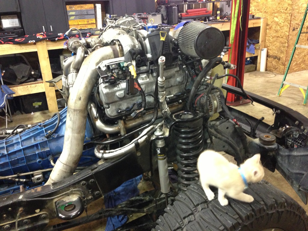

Cab is on. Few things to hook up tomorrow still, and put new tires on, truck should be screaming by 10 tomorrow night. God... I can't believe in less than 72 I'm leaving for Aaron's

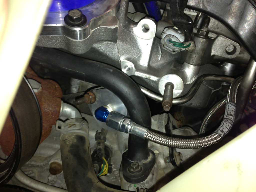

Good news. Cant wait to hear results on the intake. Awesome lookin piece in my price range. Any fitment issues with the coolant lines on the wg? I need to hook my gate up to coolant. Where did you put both lines? I saw the one into the coolant plate. Wheres the other go?
Breaking Habits
Feb 11, 2012
6,158
Mapleton, Illinois
I turned the back line angle down, cab dropped right on, no issues whatsoever
Shawn (street diesel) suggested tapping both coolant plugs from the eft delete. Worked like it was meant to be there
