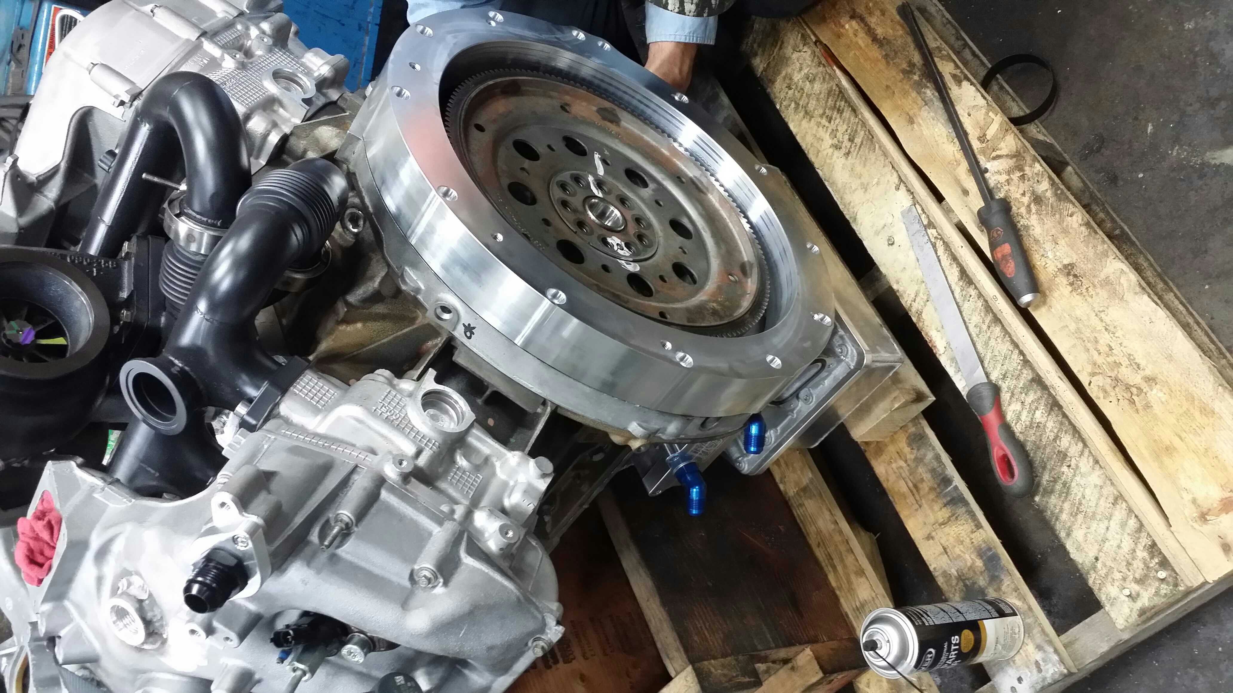

Adapter plate is Finished and ready to bolt the 47re up

Need a reliable trans that will take rounds of 1200 plus horse power and shift fast...plus there is no real true parts for the 6r out yet and do want the trans to hold us back

Dunno if I missed it in the beginning but why a 47re?
-KCCO-
reliability, its been the only trans we've had continually last over time. Skipped the in-betweens and went straight for the swap. Things are really coming together, suspension should be all finished tonight. :toast:
