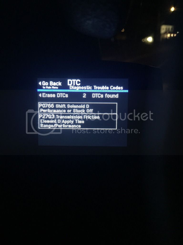

I have a 5r110 that was built by Rudys and is good for 1000hp, it has an RCD Converter. The issue I'm having is only when I'm 100% on the truck from first gear, the truck shifts fine until 4th gear, when the truck is shifting into 4th it free rev to about 3500 rpms before shifting and then locks the TQ hard. After that the truck will not shift out of 4 gear unless I put it in reverse and back up a little, then put it into drive. The truck has no codes and the transmission temp is normal. The fluid is also full, does anybody know what is causing this?
