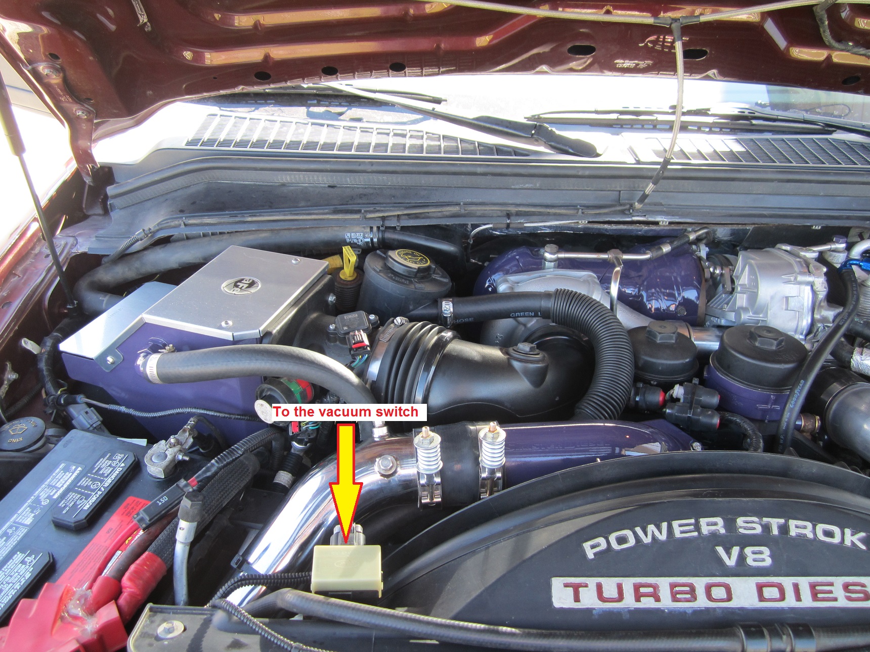

If the Rad was recently out, check the vacuum line that runs over the top of the Rad to the vacuum switch.
SlowSmoke
Dec 15, 2011
197
Sylvan Lake, AB
^^^^ what he said. Also there is a connection right beside the pass side battery along the plastic box under the positive cable. It's about half way between the two posts right beside the a/c port.
