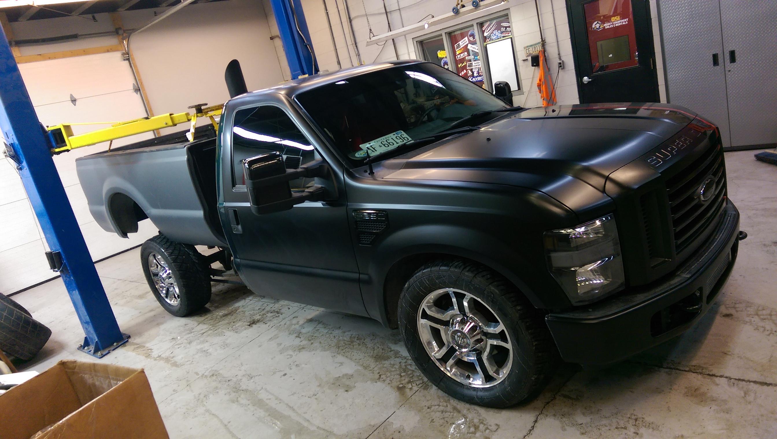

Oh and one more kind of important thing... A couple people might know bit for everyone else I'm opening a craft brewery up here called Redline brewhouse.. Themes are being pulled from nostalgic racing and performance along with a few other things, so we need a promo vehicle right? The little beast Is getting a facelift, been working on it after work for the last week.

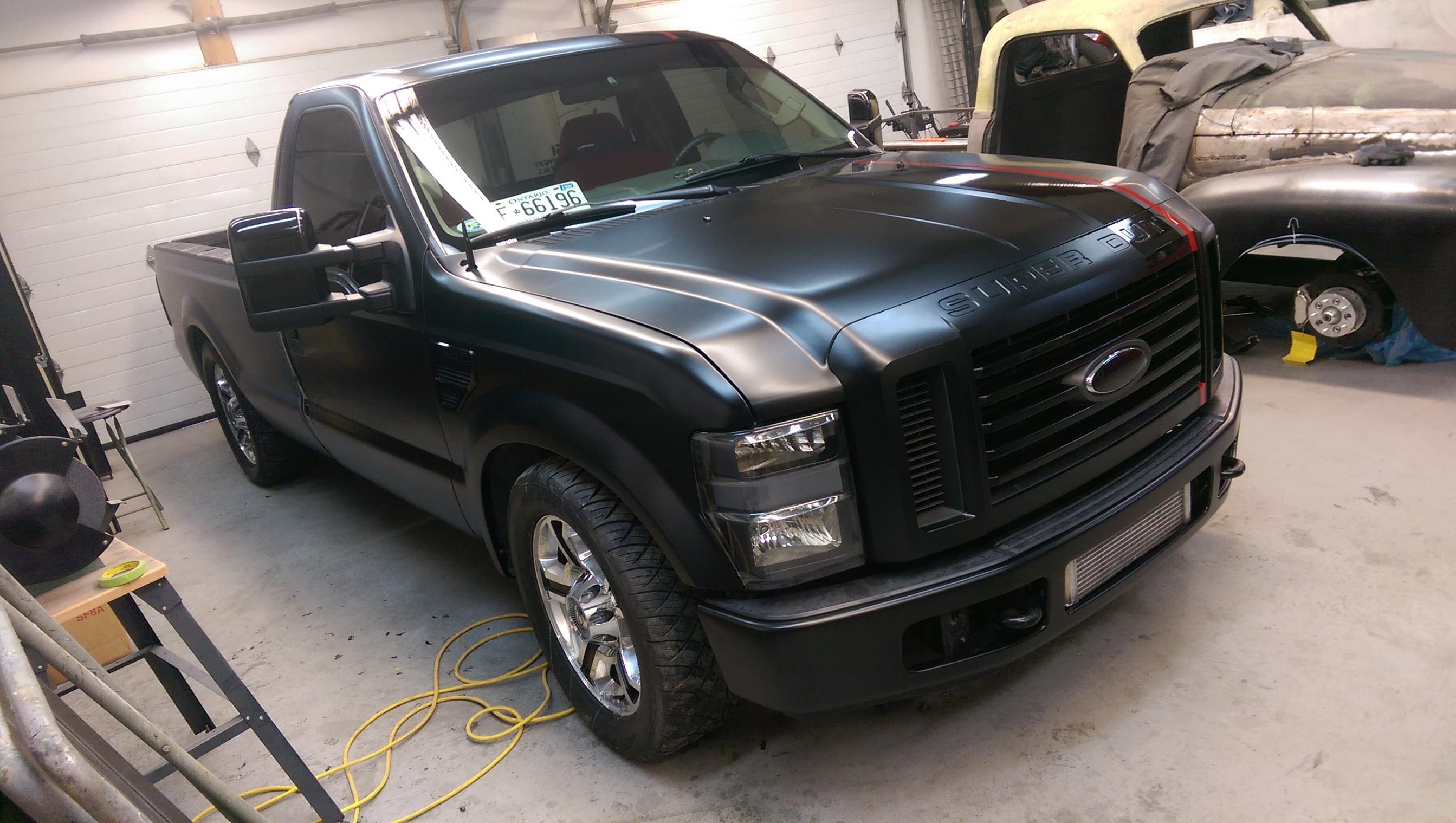

Got the front bumper finished up and back on today. The rest will be wrapped when the box comes off, which hopefully will happen next week if we can get a half decent day to drive it to the shop. Very happy with how it turned out, crazy how much a color change changes the look of something, I swear it's smaller and lower lol

Yeah it does look alot different, i guess with the black being so negative compared to matte gray you don't see the colored surface, just the exterior features (headlights windows wheels etc...) which makes it seem shorter
Looks real good though man
devdiesel
Apr 2, 2012
376
Barrie, Ontario
Ya it's hard to see in the pictures, it's satin black not matte black, the body features are actually way more obvious than when it was grey.. The grey was cool in the right light when it looked silver but it looked like primer to often for me. When the graphics for the brewery came about It gave me a great opportunity to make some changes and use it for marketing. I'll take the truck to events in the summer and use it for promotion

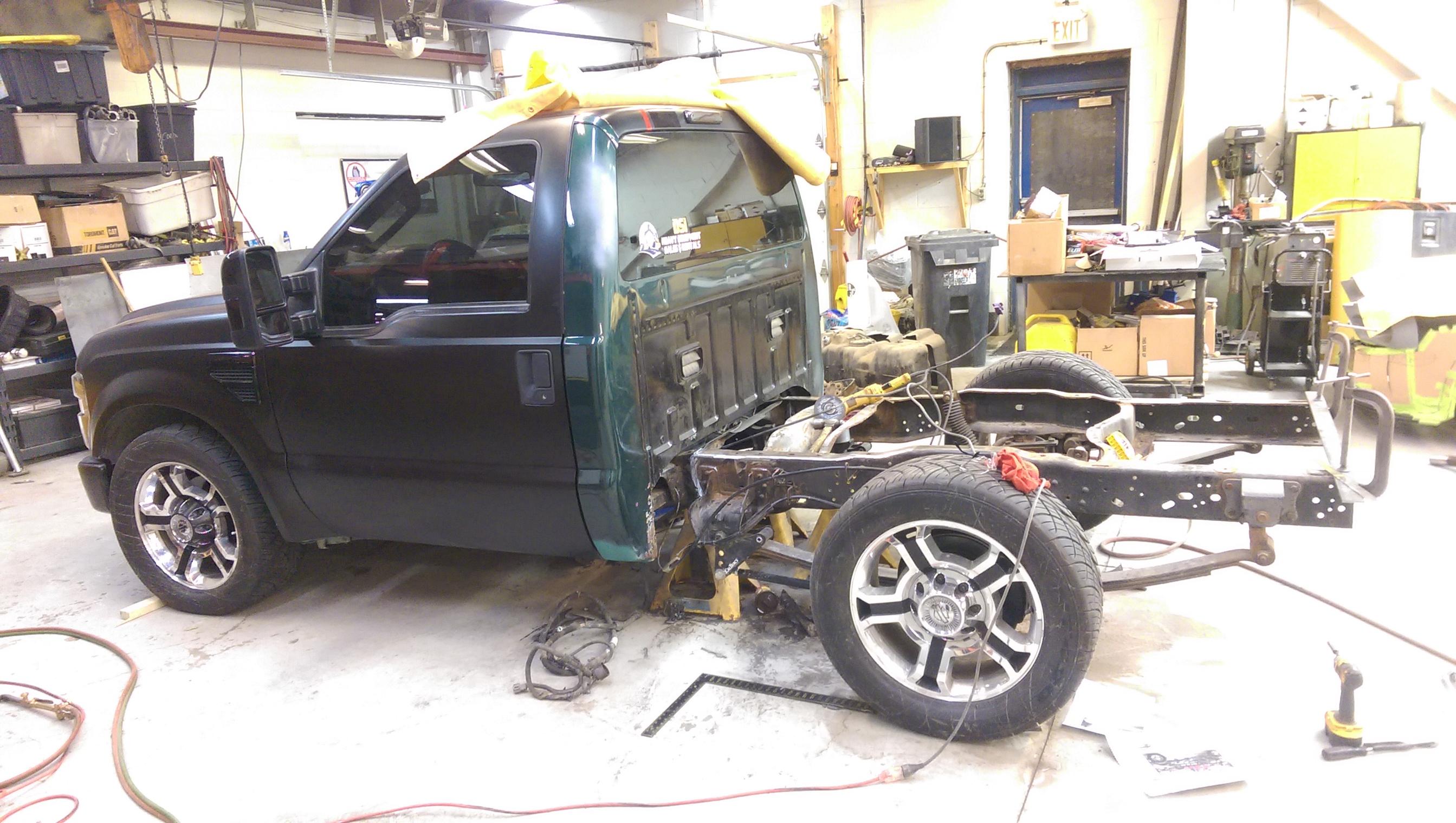

Well we made some pretty solid progress after work this week, and I can say I've joined the shorty club!
We got a dry day on Wednesday so I drove it back over to the shop and pulled the bed off/ made a junk pile

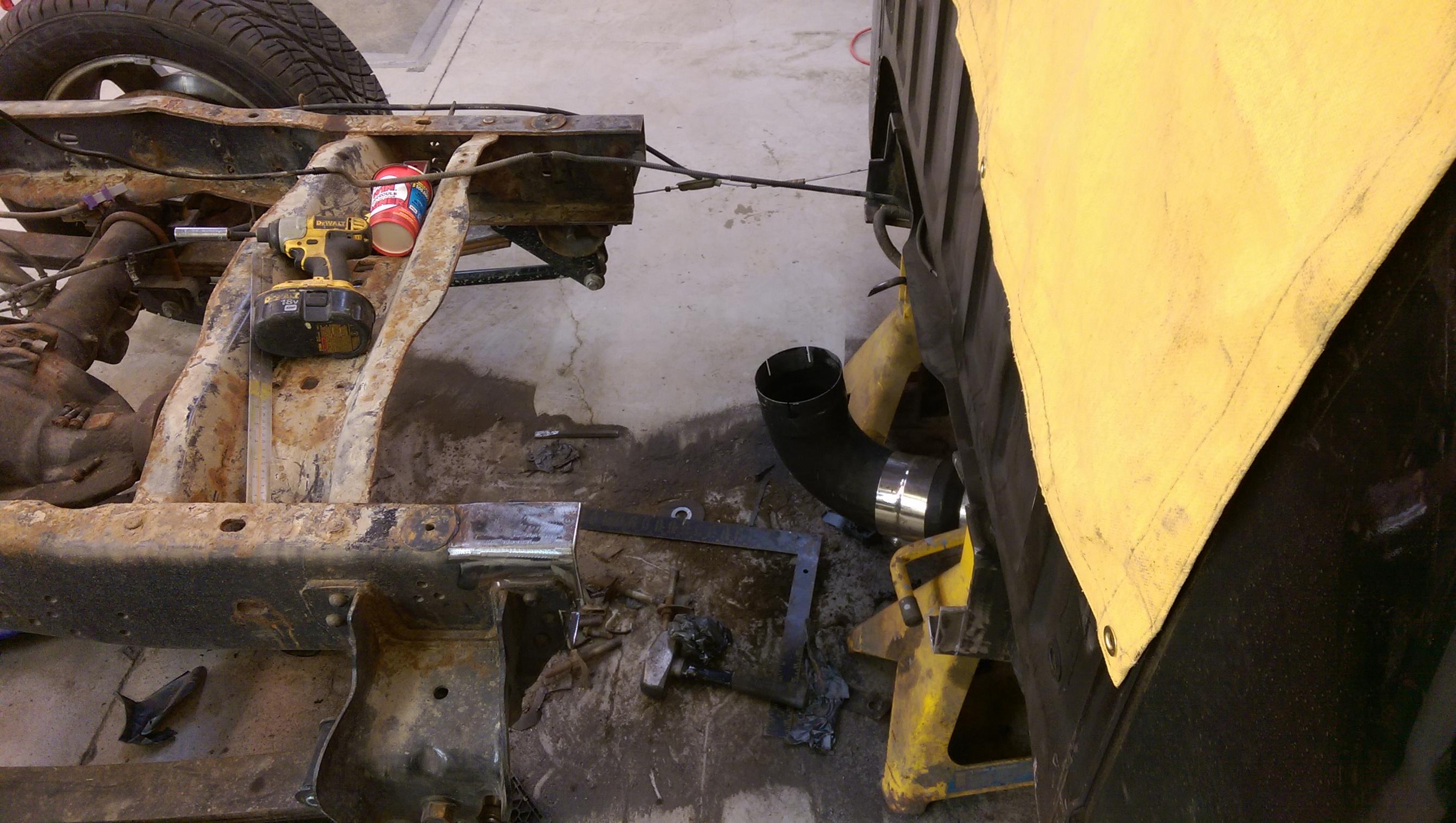

Then Thursday we made some measurements and got the cutoff wheel out/ plasma and sliced the frame along with half of the rear cross member. After cleaning the frame up a bit we squared it up and welded it together.
They certainly look funny with the bed off

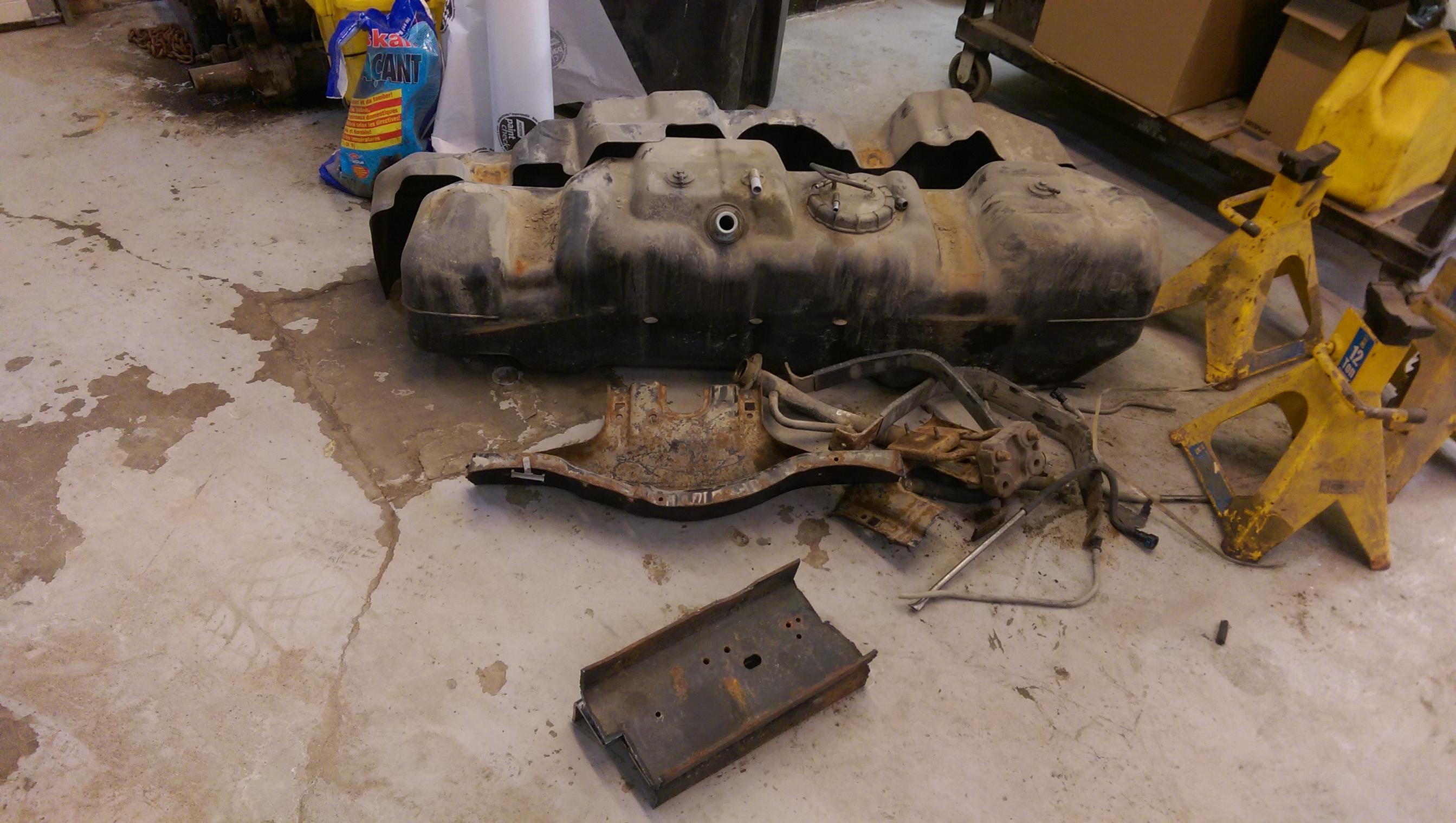

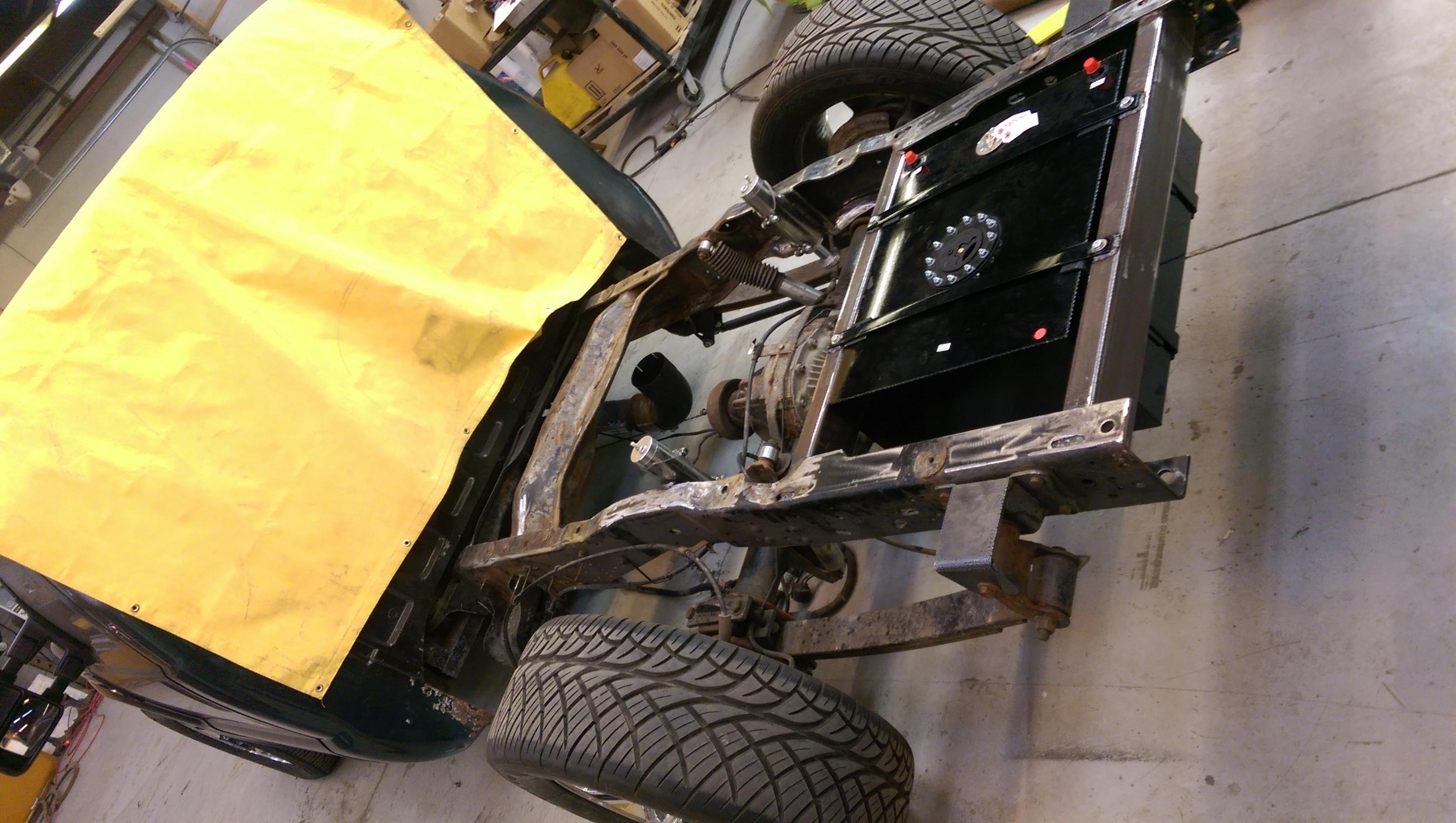

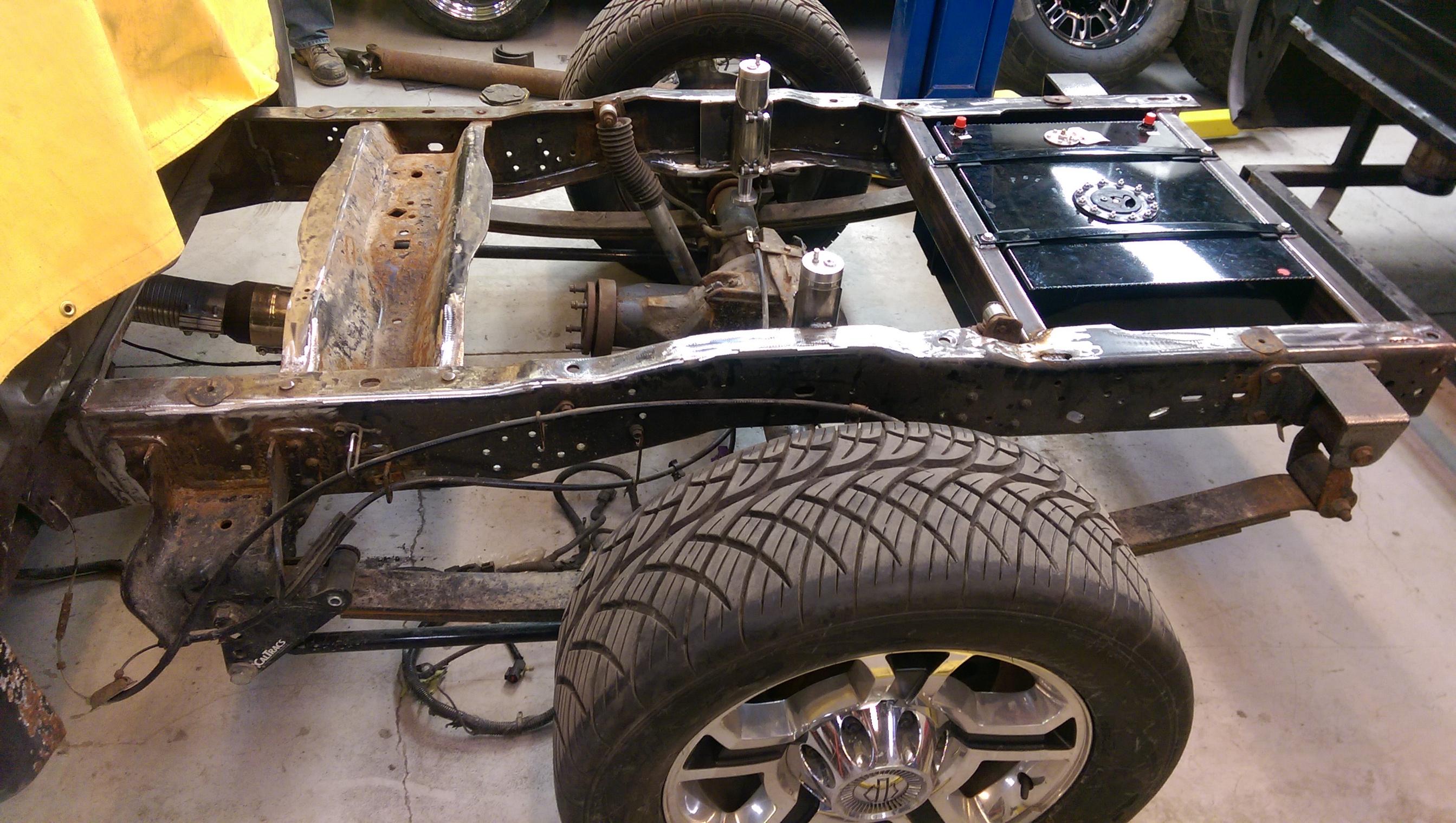

Then Friday night we got the two new rear cross members welded in (one at a time to keep things solid) and got the fuel cell in place.
The cell is slightly offcenter so the fill neck lands centred in the bed, also gives more room for fuel line routing.
Anndd I thought I'd try something different here that I pulled from the offroad world, I picked up a set of 2" travel air bump stops.
I'm planning to pull another leaf out so it's going to be pretty soft out back, and these things don't have much travel with the stock bumpstops even when cut.
So this way I'll 4" of total travel and I can adjust how hard it is, should work well
