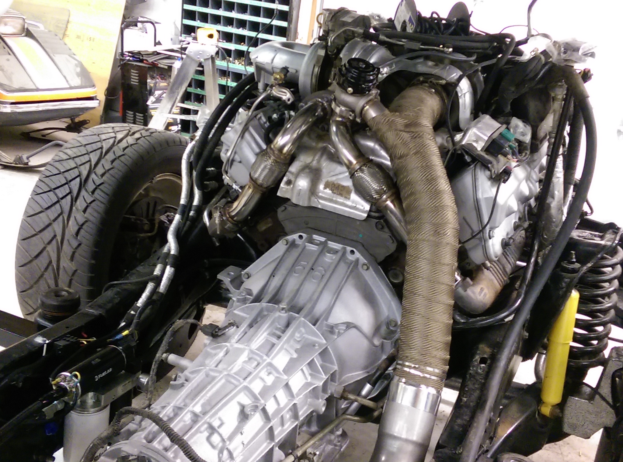

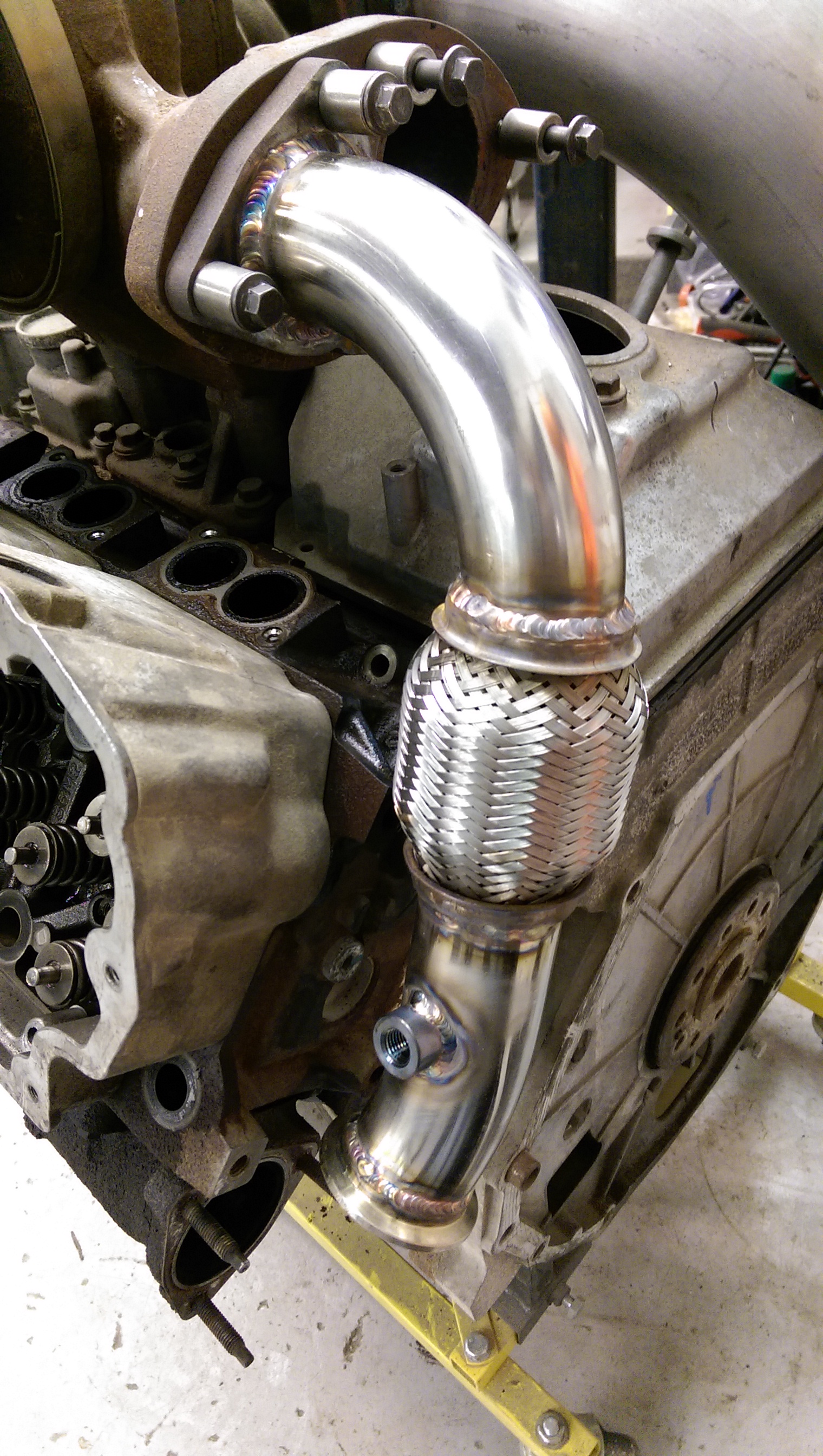

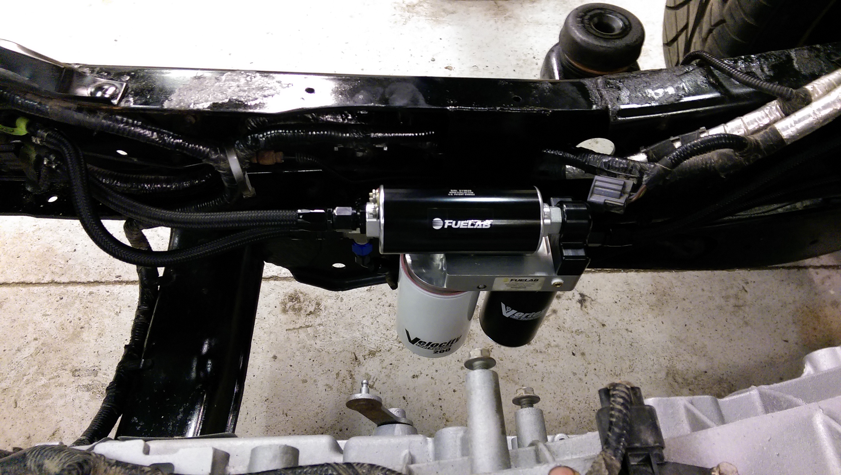

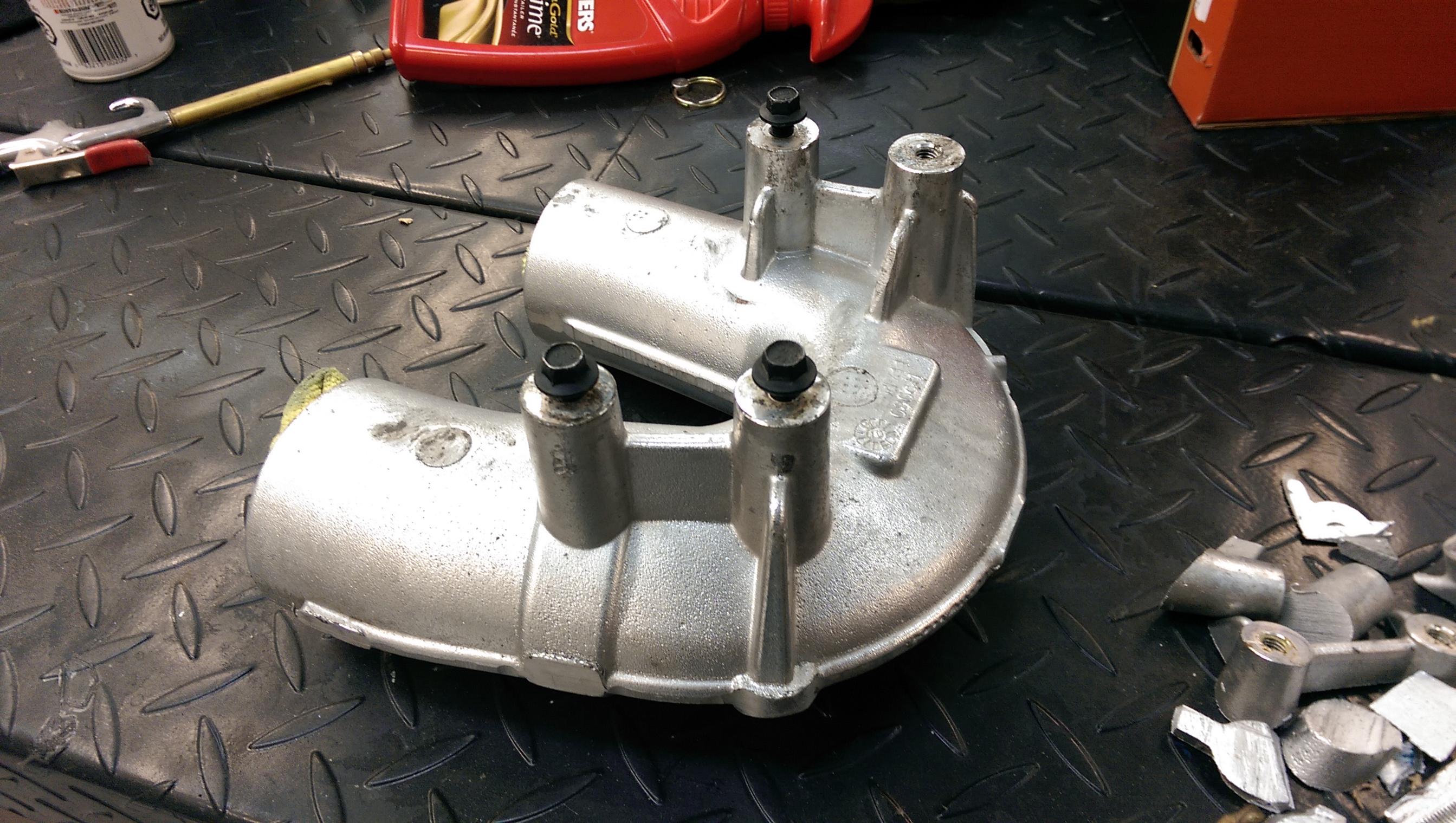

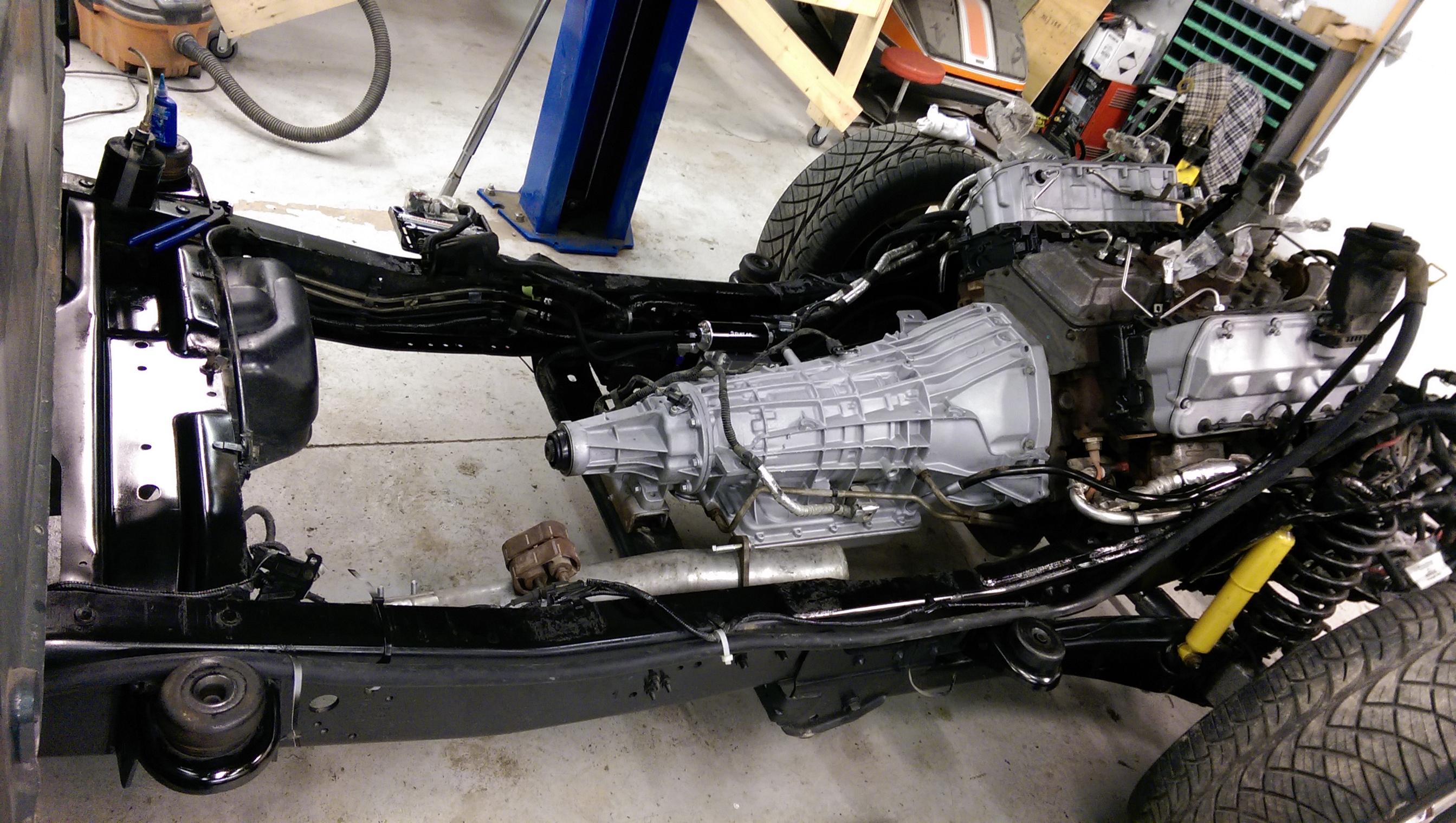

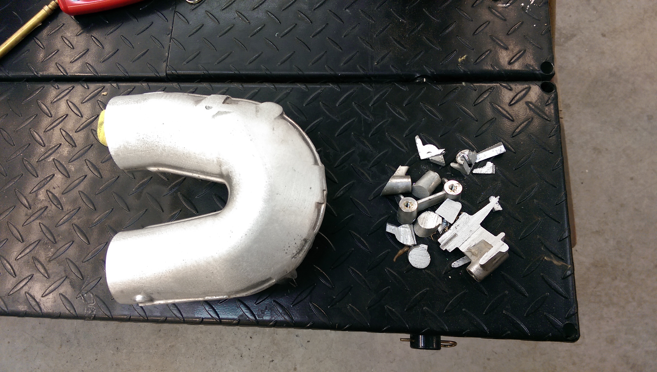

made a little progress tonight on a few different things. Started off cleaning and painting the frame, then i finalized the fuel system, finished up the 6.0l manifolds (ported and vbanded) the drivers side up pipe is done, and i spent some time on the gate position on the passenger side. Also got the ATI dampener on, couldn't manage to get the AC belt on, It appears that it needs a bigger belt because the dampener is bigger in diameter ... i know, AC on a race truck?, but I'm sure i will appreciate it on those hot days this summer lol... and i also thought i would try something i haven't seen before,since I'm eliminating the fuel cooler and vgt cooler assembly, ( going to just add the vgt to the coolant system) i thought i would make the cast turbo elbow a little more visually appealing. spent about an hour with the band saw, hack saw, and 40 grit on the DA sander. It still needs some finishing and a coat of paint but you get the idea

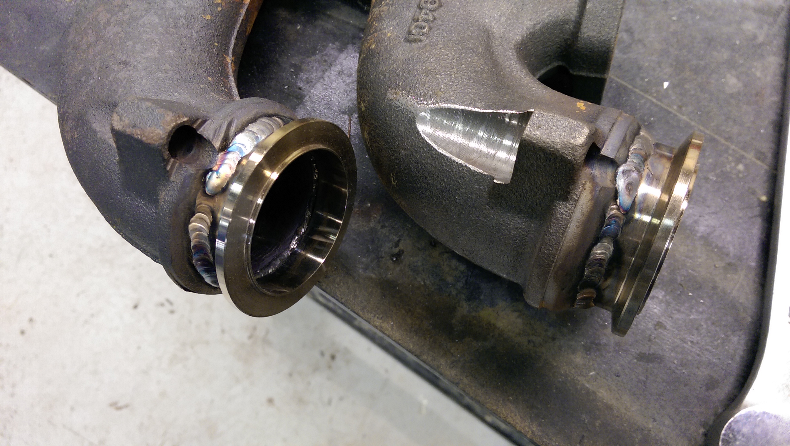

first picture is where I'm at now, second picture is the bottom of the same piece but it gives you the idea of what the top looked like, took a lot of aluminium off of it

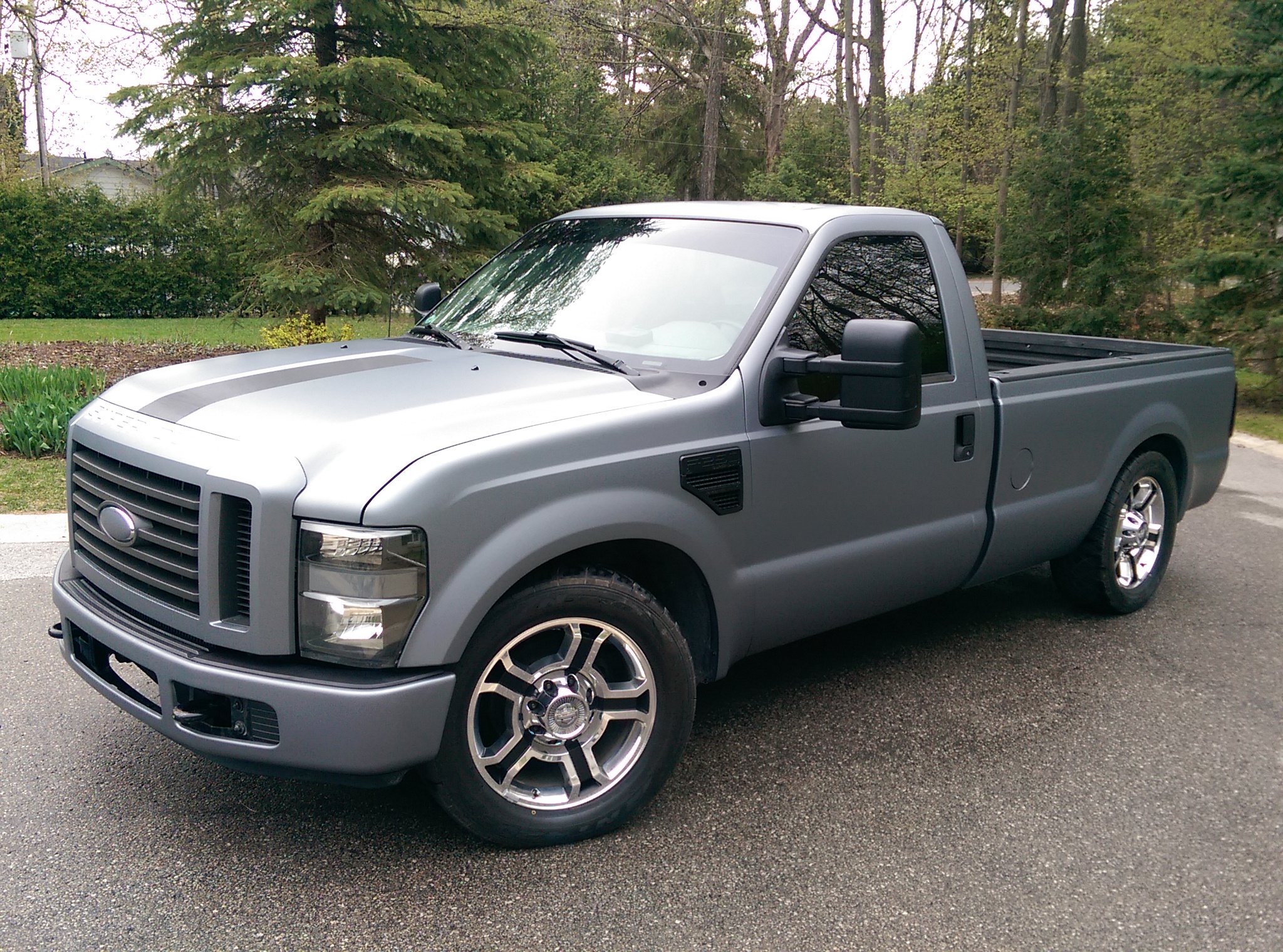

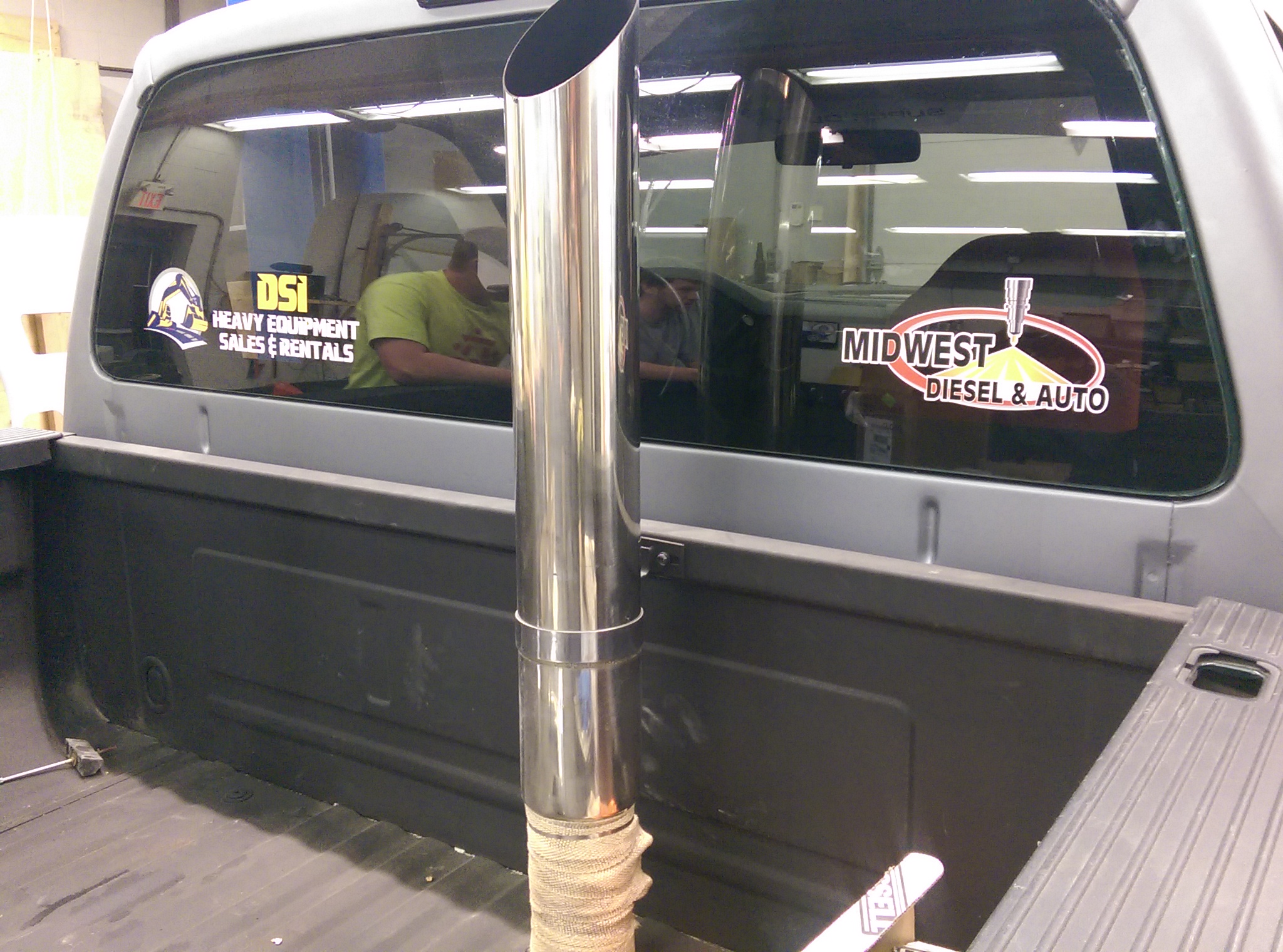

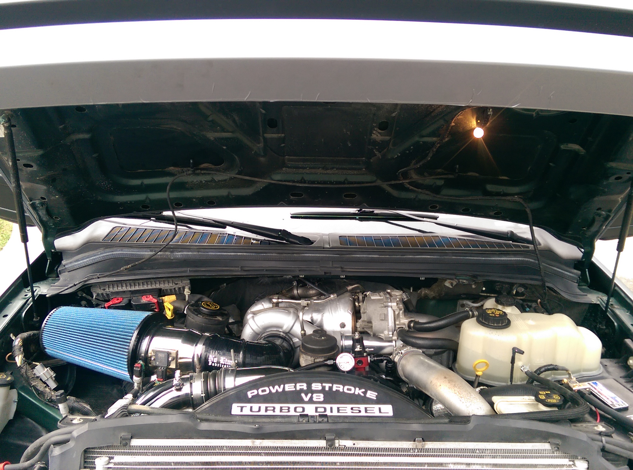

Well its up and running! we had some late nights Thursday, Friday, Saterday and finished it all up. I fired it Monday night and has run perfect, no codes, smoke or leaks. ive only put probably 20 miles on it because of the crappy weather but I am really happy with how part one of the build has come together. the uppipes/ gate arrangement came out really nice and I only had to do some light "massaging" to the firewall up top to clear the gate, have lots of room under the hood now !
im still playing with the gate and cal tracks but between them and the built tranny its shifts fantastic with a very quick firm lock up. Im hoping to get it down to the track this weekend or next weekend to get some practice in before TS.
Also I forgot to mention I had to make a slight change to the turbo arrangement. I just couldn't wait any longer to get the 75mm, so I ended up going with RCD's 72mm instead. little bummed about it but I was able to save a good chunk of change which went towards the built motor, and I always intended to spray it, so when the dual fuels and 60%'s are in i'll have to make up for the slight lack of air with some nos
regarding the turbo arrangement though, I haven't got one it that hard yet but it definatly pulls much harder, sound is about the same, ill talk about it more when it gets some more miles on it
