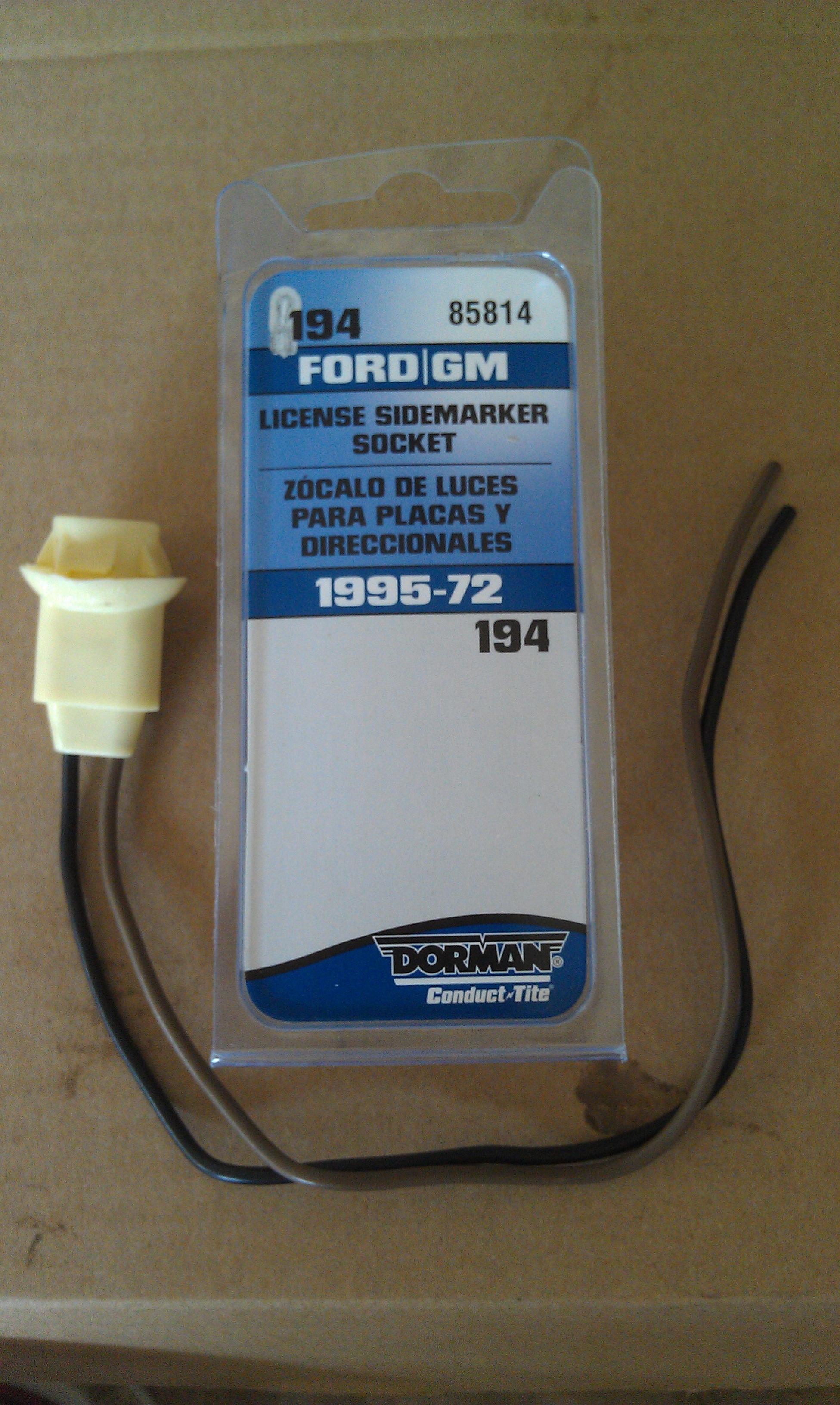

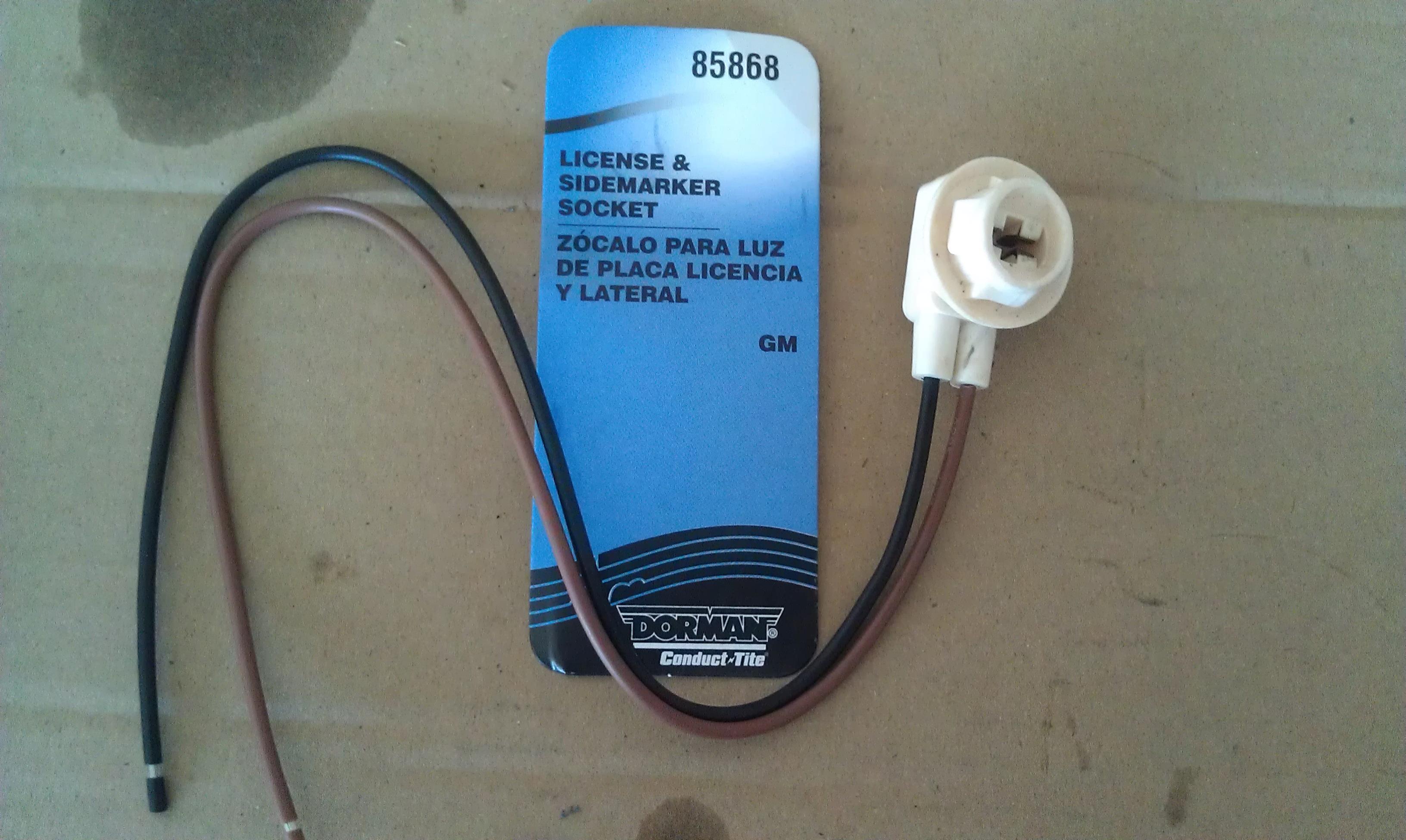

Well I wouldn't say rigid as much as more rigid. It's still not a solid plastic piece, but I found these 2 options at Oreilly's on the shelf. The straight one is more rigid than the right angle one that looks more like the factory socket. I'd say don't waste your money on the right angle socket. It's about as flimsy as the factory one.
I'll update this to let you know if it holds up.
