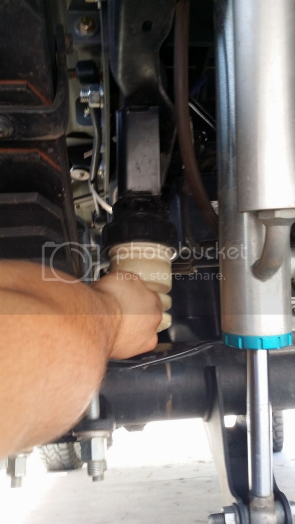

This sounds like what I'm looking for. Could you snap a pic of them on your truck?

Yup give me a sec.

With aircells removed out of cradle,
With the bumps in, didn't feel like snapping it back in and getting dirty, but you get the point how it mounts.
Only thing I can say that's a negative is, I towed a heavy fifth wheel for a friend and the bumps almost fully compressed. Never had that happen with timbrens, but then again these aren't solid rubber. But for your trailer, these should be perfect.

This is exactly what I needed, thanks! I was wondering about the brackets that seems to come with them that goes between the frame and the spacer pucks. Looks like you just tossed them. Glad I asked because I see a clear reason to try the air cells over the timbrens. Thanks much!
