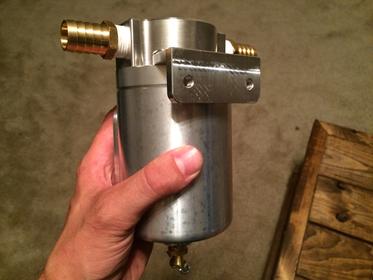

Pic
Here's a couple. Will get some of the new stainless bracket with measurements once I get it from machine shop this week.

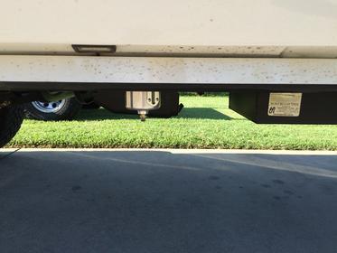

And another
Here's one from standing away. You can barely notice it. And yes I know the truck is dirty LOL. I'm taking care of that now
