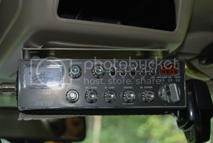

galaxy 949..running an enexspencive 5 foot whip for now

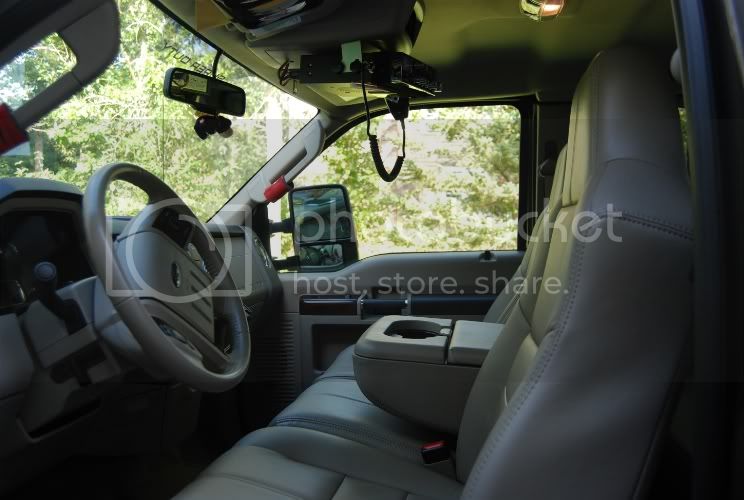

Modded cobra 200gtl with 2 firestik 3 foot fiberglass 10 meter antennas (required as my radio is a ham 10 meter) and i didnt want an 8 foot steel antenna! Radio mounted over rear view mirror and firestiks mounted on door mirrors. Tapped directly into positive battery terminal

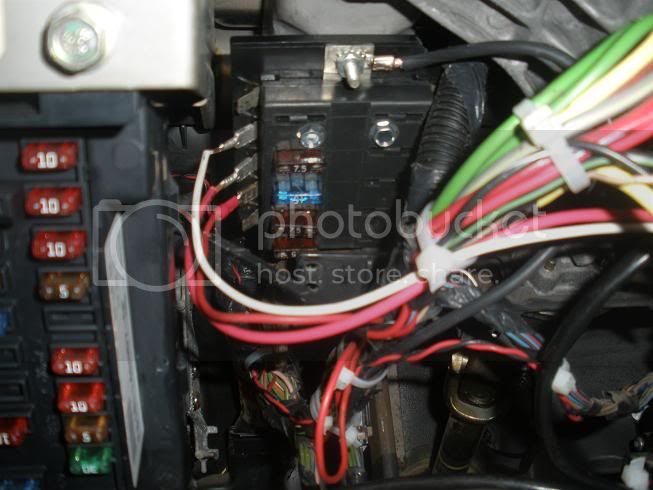

Instead of messing with a relay its a lot easier to just run a fused wire to the ignition wire in the ignition harness on the steering column. But to each his own just offering upa different route

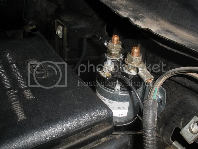

Of course its easier, that doesn't mean its the right way to do it. I don't like pulling any extra amps though a wire for something else, than the tiny bit it takes to energize a relay.

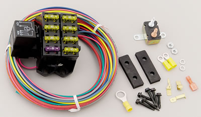

I run this fused terminal block, so nice for misc. add ons!
The terminal block is powered by this nice big "keyed hot" relay.

I do like the idea of a add on fuse block, but runnin a regular cb off the ign harness wont pull enough to disturb anything. You run into problems when you throw multiple accessories on to the circuit
