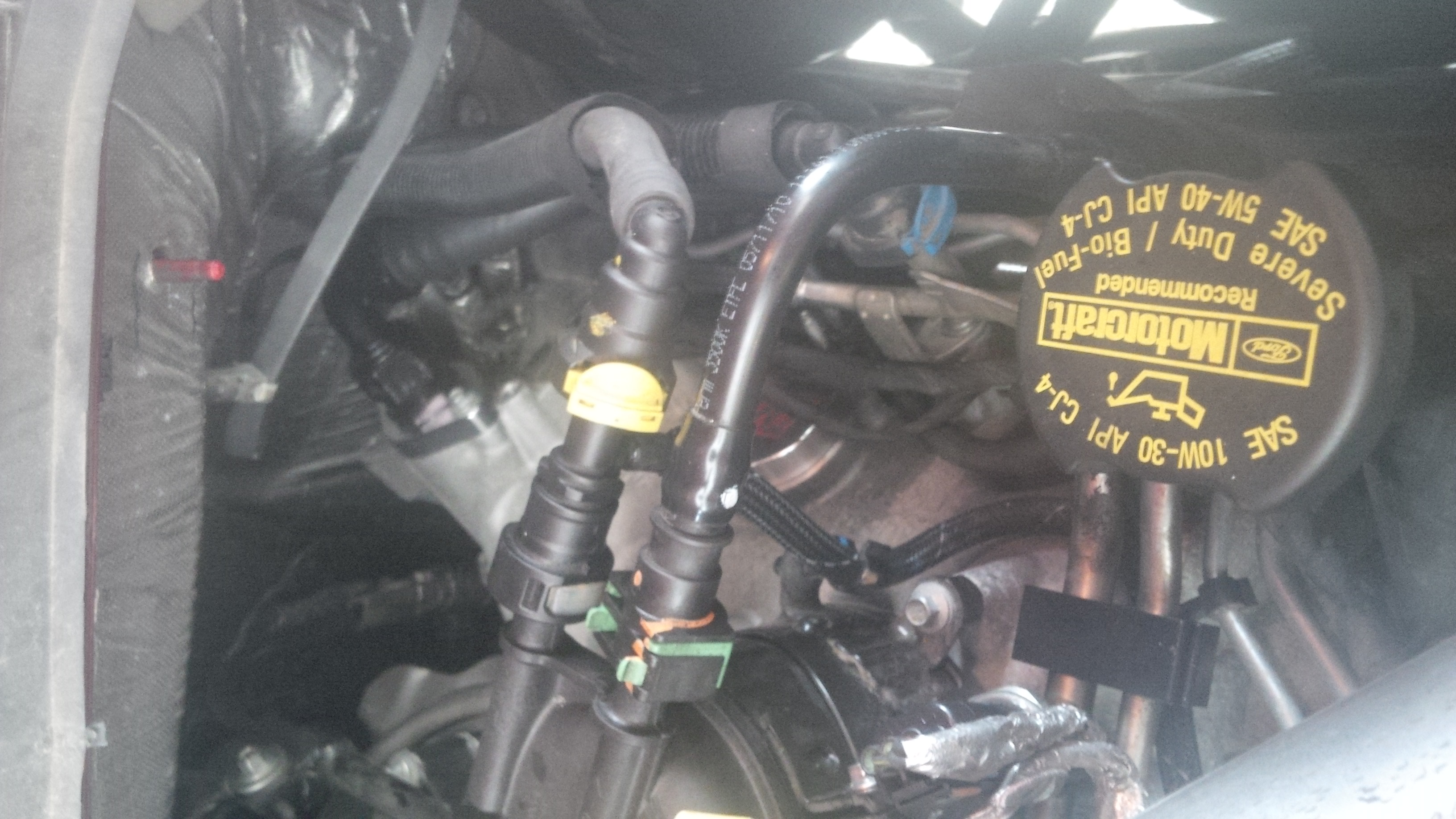

Is it possible to leave the stock ccv in place and just un plug it from the intake, plug off and route the stock hose away to vent to the air?

This is how I did mine. About $15 worth of parts. No issues or drips so far....I hate oily boots

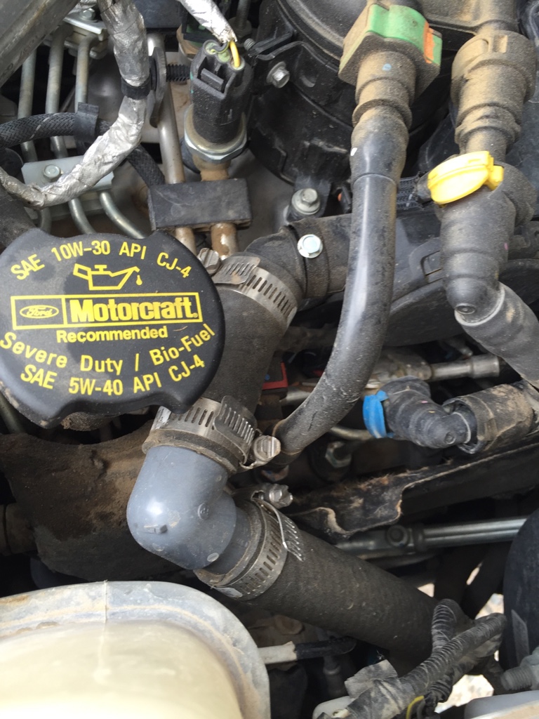

so that's where the ccv is at. lol
is that a expandable plug at the turbo inlet?
live life full throttle
Yes it is but haven't had an issue yet. I have a different plug and a worm clamp to install but haven't had any issues with that plug.

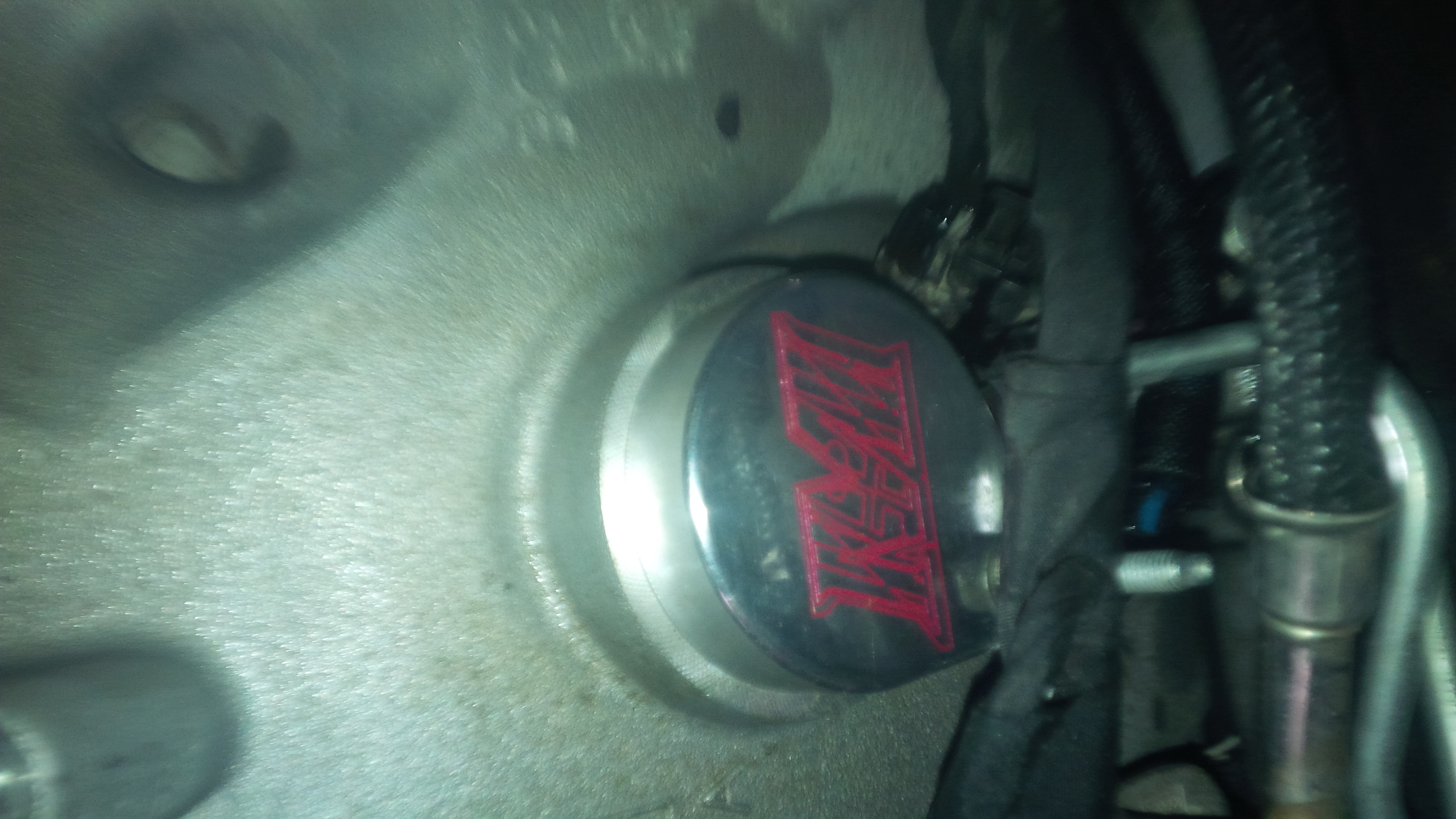

cool. simple and easy.. i have them in the block of my dually.

I pulled my intake all apart cleaning the pounds of egr gunk and the plastic ccv tube broke and ford wanted an arm and leg for it so I figured I would just reroute it.
