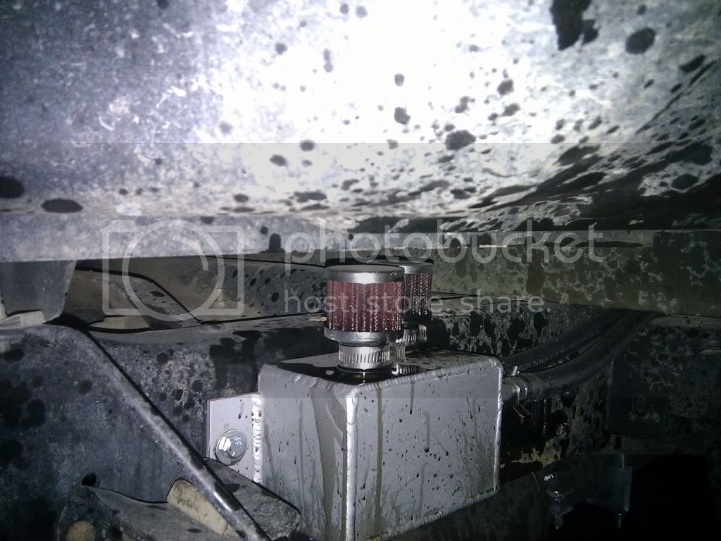

I don't have a race truck, it is my dd. I know it has always been an issue, two motors and the same problem.
Aaron, Mike H was talking to you about this but nothing ever came out of it. But there is no baffling in your kit anywhere. It seems some have more problems with this than others. I tried a simple fix but it didn't help in the long run.
[URL="
This is how it looks after one day or so. I have to drain it and try to keep the filters oil free or it does this constantly.

I tried Craig's kit too, but same issues. No baffling in theirs either.I am not trying to throw people under the bus, but this is what happened to mine and my issues with them.
