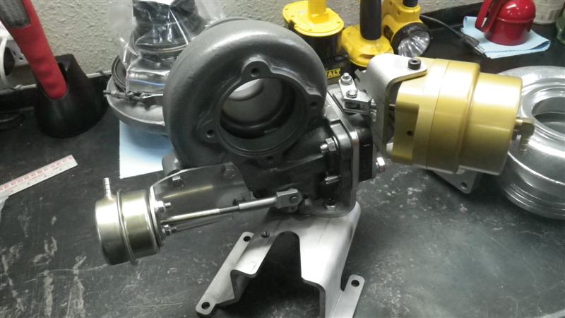

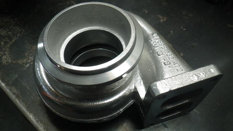

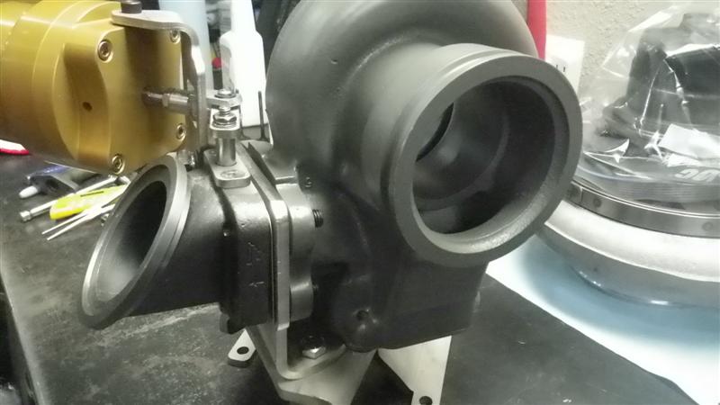

I had my turbine housings coated inside and out.
Went with the high lustre. (I also included a picture of one of my housings with the army green inside/out.)
It's rated for 1500*F continuosly. (Was kinda worried about the secondary, as it gets hotter then that, but you can't really see it anyways. And the primary will never see that high of heat for very long.)
The place I took mine to also has a higher rated coating, but it only comes in a dark army green color. Its rated at 2000+.
I had my manifolds, and up pipes coated inside and out with the army green coating...lasted 2 years through the ugly Canadian winters. Then the manifolds started to show rust on the outside of them. I called them, and they said bring them back, we will re-do them at no charge.
The place I get to do all my coatings is www.topguncoatings.com in Calgary, AB.
