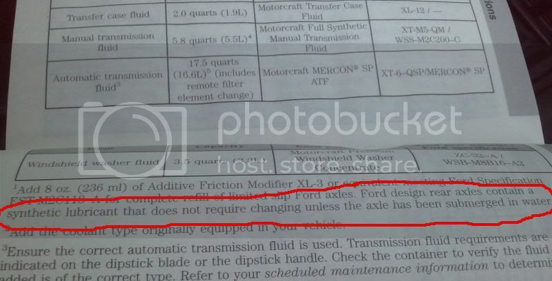

Is it 50,000 miles?
hmm thought the manual said that ford uses a synthetic oil which didnt need to be serviced unless water got into it. i did mine @ 95k. only reason i did it then was because i had too much fun at the river. i dont see how bad it could get at 50k.
