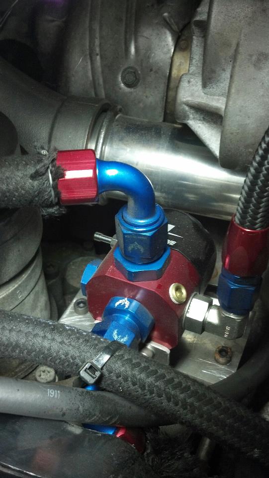

heres a picture of the block
White_monster
May 19, 2011
3,177
The great white north
No idea what it costs, I'd guess $40-50 though. Maybe get Craig to send your sensor back to you. Another question is why didn't it get installed in the first place? How do you adjust the pressure with it mounted like that too?
