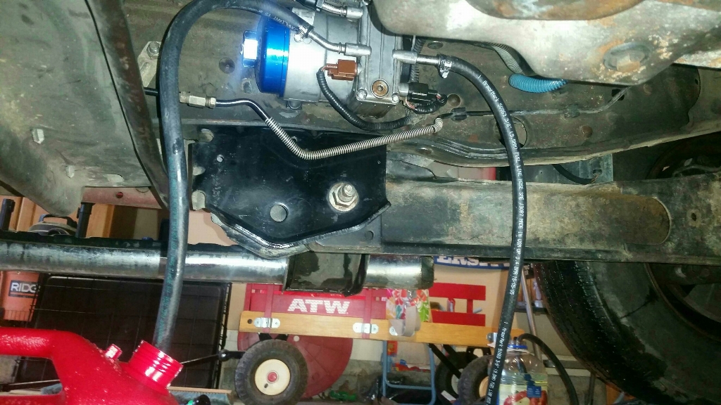

Ok, here is what I did. As you can see, the only factor in this is the hfcm itself.
And this is the result.
https://youtu.be/2aS_s86L0aI
It's obviously introducing air somewhere, somehow, inside that hfcm. Wondering if the new pump I got was bad out of the box.

Would it be worth doing this test again with the returns looped together? Or would that not prove anything at all?
Sent from my SAMSUNG-SM-G900A using Tapatalk
Sep 9, 2015
3,609
167
Mesa, AZ
That wouldnt show you anything i wouldnt think as you are eliminating the return to the tank the way you have it in the picture.
Anything else happen when you damaged the stock fastener and replaced it with the slotted screw? did you have to repair threads or dig something out that may have damaged the HFCM case? Its definitely sucking air.. just trying to consider everything.
6speedsd
Jun 9, 2011
3,468
Olive Branch, MS
Yeah I had to retap my original for stripped threads. However, the used one I tried is causing the same issues.
After taking that pic, and the initial videos, I took the other hfcm, my new filter, and my original pump, and put it on the truck. Just for chits and grins. Exact same scenario. Doesnt matter what combination of pumps, housings, filters, caps, etc you try....always ends up with air in the fuel.
This is the part that I don't get. I could see getting a bad pump out of the box, but for it to immediately act like my old pump did? That's a hell of a coincidence you know. But what else could it be honestly? There is only so many ways to get air in the fuel in that hfcm!
