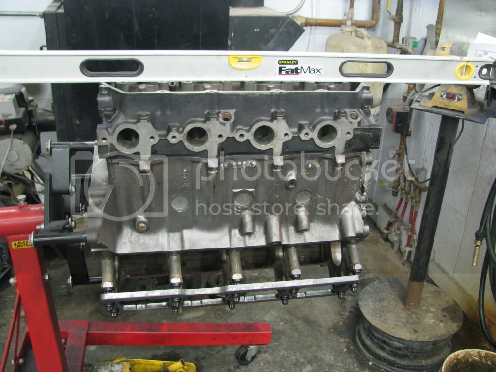

907Dave, got a pick of your oil feed from the passenger side oil port?
Also can we clarify what the 1/4 port on the passenger side is for. Can we use it for an oil supply to the turbo or not?
I'm confused now. Thanks
The port is on the driver side, its 1/4 NPT and there is no reason why it cannot be used for an turbo feed. In this pick I was using it as an auxiliary feed for my HPOP's.

Dave, I looked, there is a passenger side port. Rear of block. Near the rear main. Unless I'm mistaken and its a coolant passage, it should work, no?
Either side can be used to feed your LP turbo. I see no reason why you can't supply it with its own dedicated feed. Less line, means less clutter. That's just me though.

Thats the coolant drain plug....see how it is positioned in the water jacket?

1/4" npt sounds right. For some reason I had 1/8" npt stuck in my head last night. LOL
Sent from my Droid using Tapatalk
There are others that are 1/8", that is the only 1/4" one.
It's usually made to feed the Gen3 Style pumps as an auxillary feed. You can use it to feed whatever you need with oil.
That's a coolant drain plug Steve.
