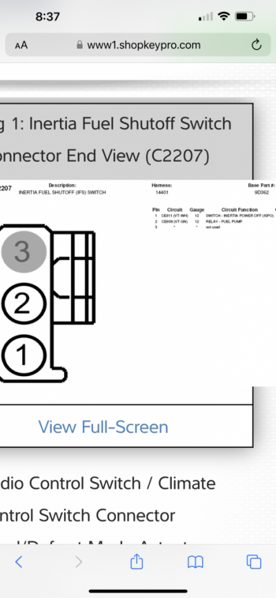

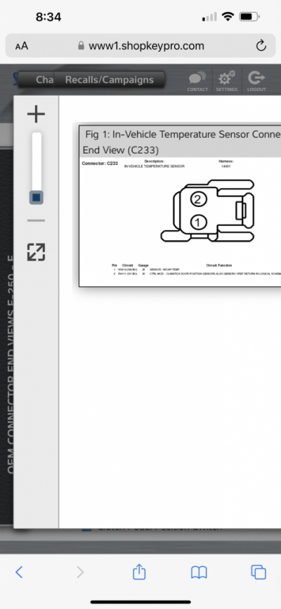

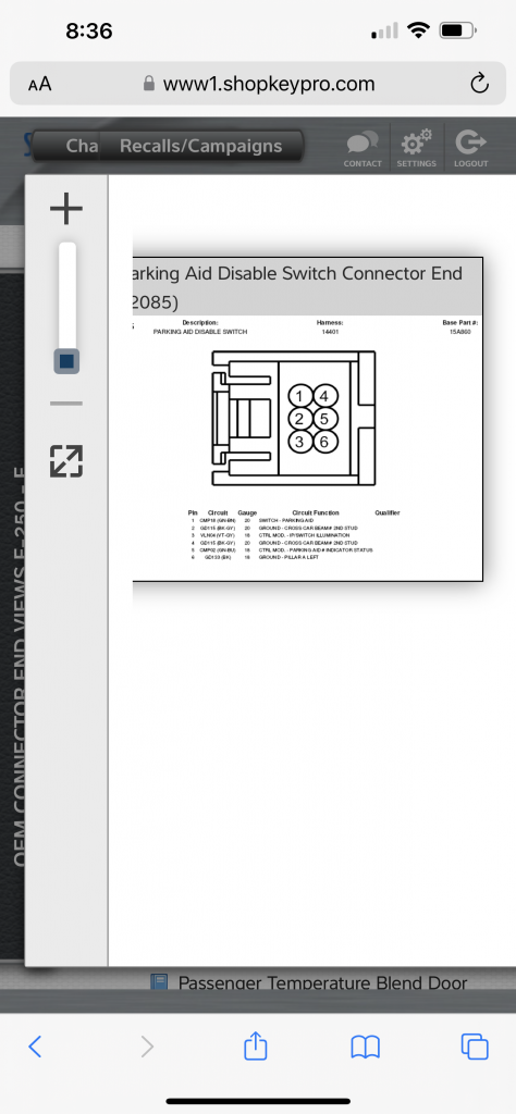

Hi,
I’m in the middle of a dash swap from a 2005 Excursion to 2008 F250 and just need the following connector pinouts from a 2008 F250 to wrap it up. Any help would be great. Thanks!
Sunload sensor
Cabin Air Temp Sensor
Parking Aid switch
Passenger airbag
Fuel cutoff switch
Racer71
May 23, 2021
77
12
Here are these

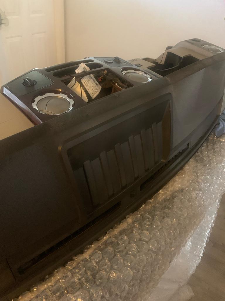

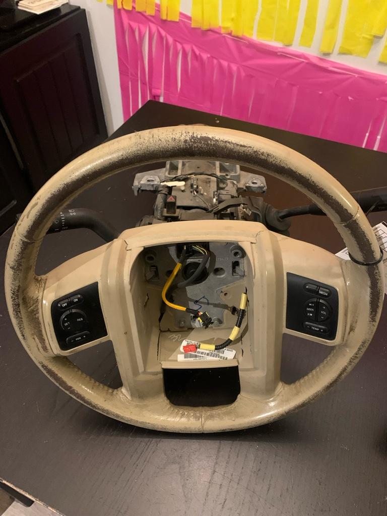

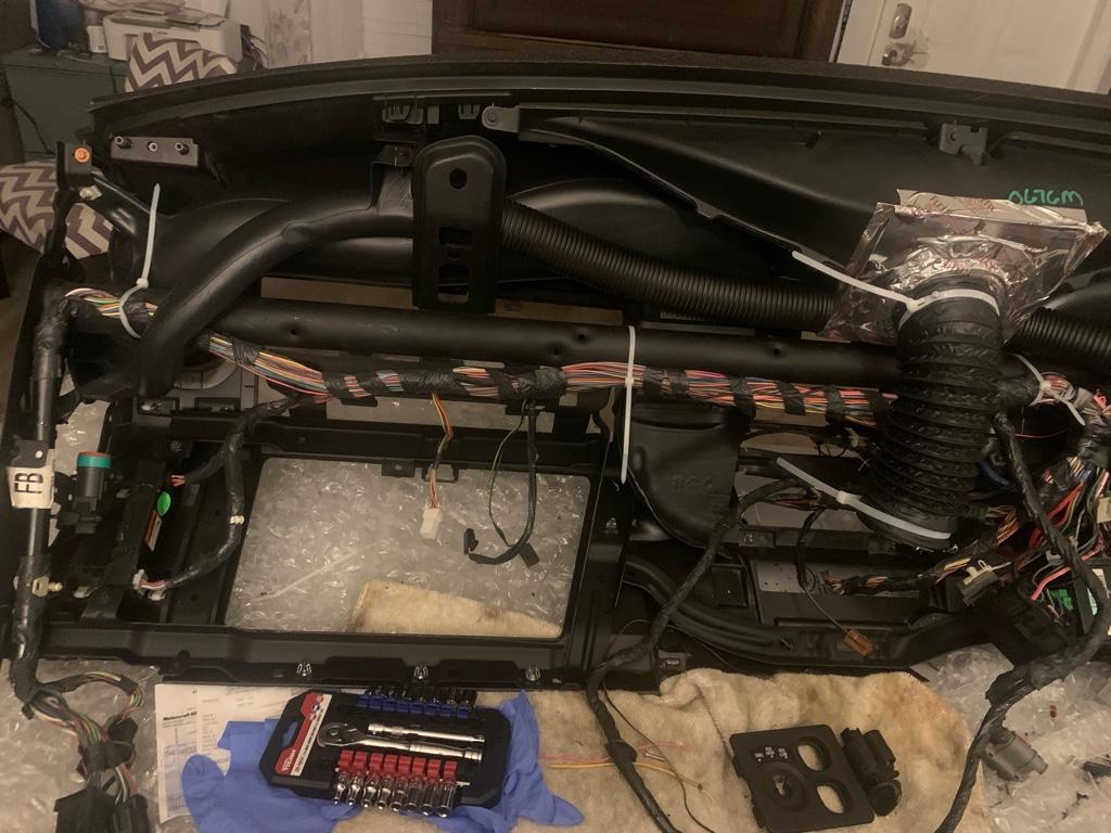

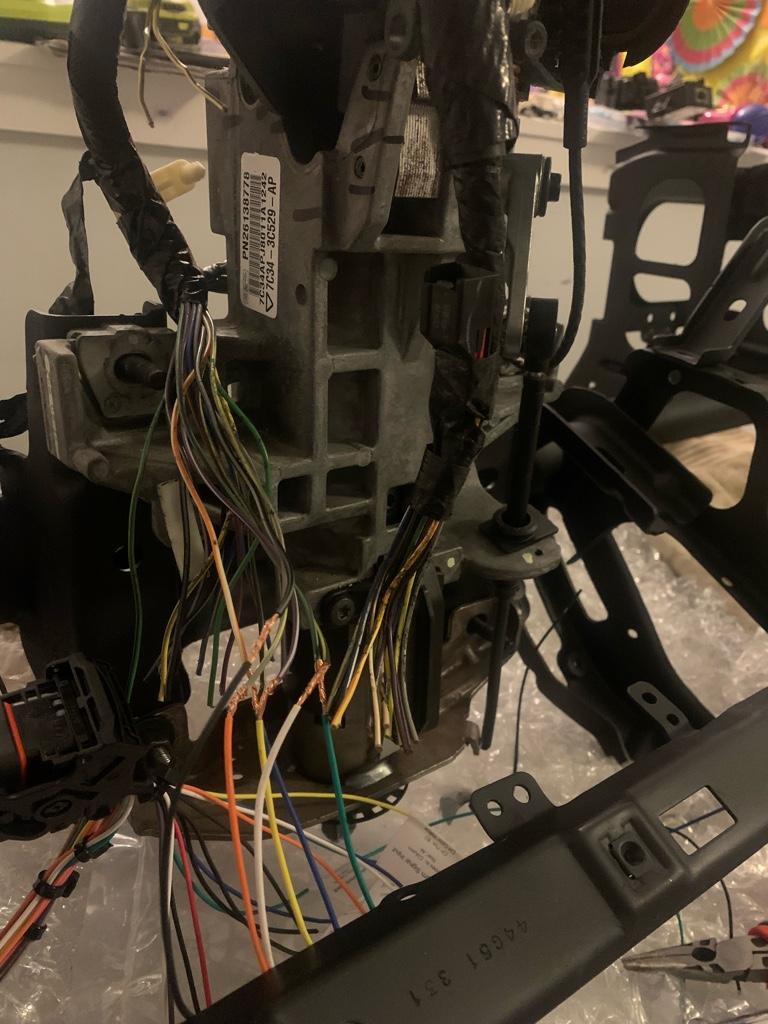

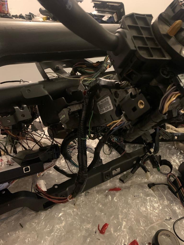

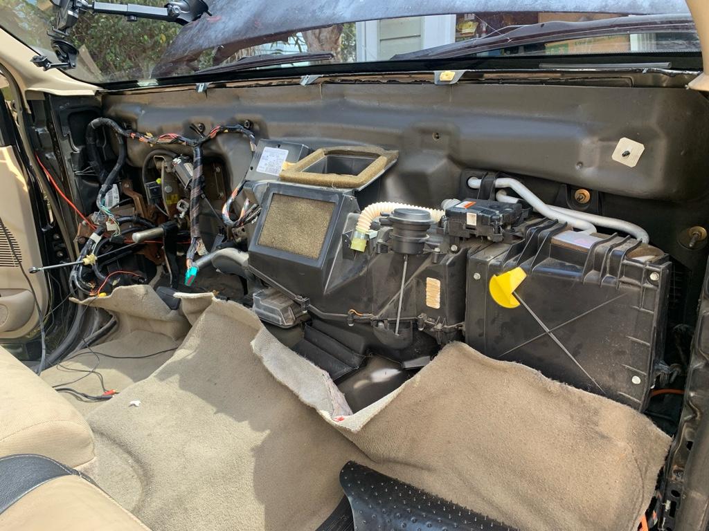

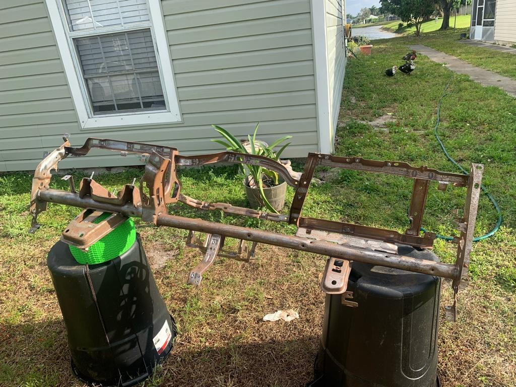

robby830
Jun 20, 2020
30
Here are some pics from when I started to where it’s at now.
