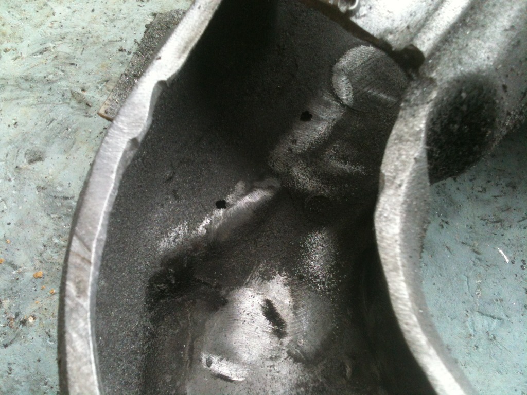

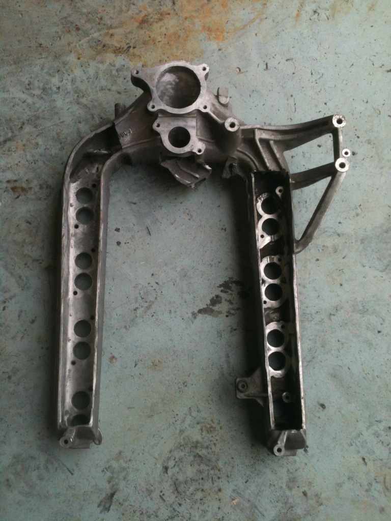

Guess I'm just going to toss what I have out there due to deer season is going to keep me swamped untill the end of the year. This isnt finished yet
ImageUploadedByTapatalk1346602142.378519.jpgImageUploadedByTapatalk1346602223.080026.jpg
I gutted where the egt Sits inside of the intake, I may just remove all of this and rework the front alittle. Here are a few spots that I'm going to address
ImageUploadedByTapatalk1346602471.883325.jpgImageUploadedByTapatalk1346602534.784784.jpgImageUploadedByTapatalk1346602599.349859.jpg
The first I believe I will either weld or use epoxy to fill in. The other two I will have to take the time to look and my truck to decide if these spots can be removed and welded. I'm trying to decide how to address the tops of the runners. Thinking I'll try something like the Gogo intake with the bolt down covers. Input, ideas and and critisms all welcome.
Oh incase anybody was wondering, what is done took around 2 hours with a 1/4" electric grinder, a 4.5 inch angle grinder, a Drill, and my girl setting there telling me about her day and questioning every little thing I did. Everything will be tig welded.
