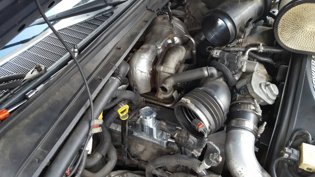

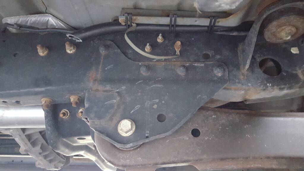

Maryland performance makes a beautiful ccv reroute kit. And chances of the ccv putting oil in the intercooler very high...
