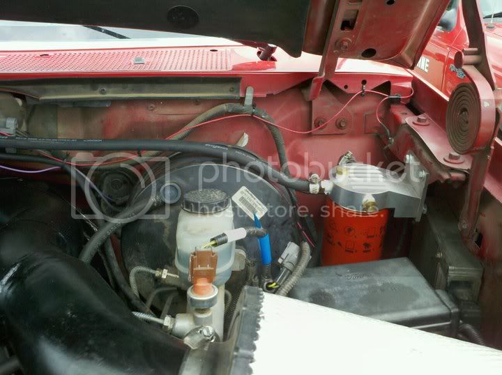

This is where I mounted mine, just gonna put a 45 the line to the tank, and 90 on the back side...
There were already two holes where I mounted it so all I had to do was make the plate a bit smaller and re-drill the holes.

I like that you took the time to take a photo. That makes threads so much better.
Where are you going to tie the hoses into.
I just went with what dieselsite said and put "T"ed it into the coolant tank, and then took the plug out of the port under the T Stat, and put the fitting in there... no problem on the picture
