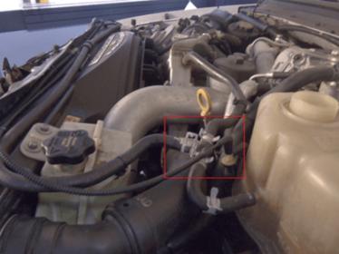

Is the Degas bottle the correct one for the 6.4 ?
The attachments show the what the incorrect and correct bottle should look like and the updated Venturi T for the degas bottle.
If all this is correct have you replaced the stock degas bottle cap with a replacement cap?
The stock cap is prone to failing and not holding the correct pressure inside the degas bottle, you can pick up a replacement cap at any autoparts store.

my degas bottle has the two hose style. the top hose is caped and I do not need the Venturi t due to me not having an egr
