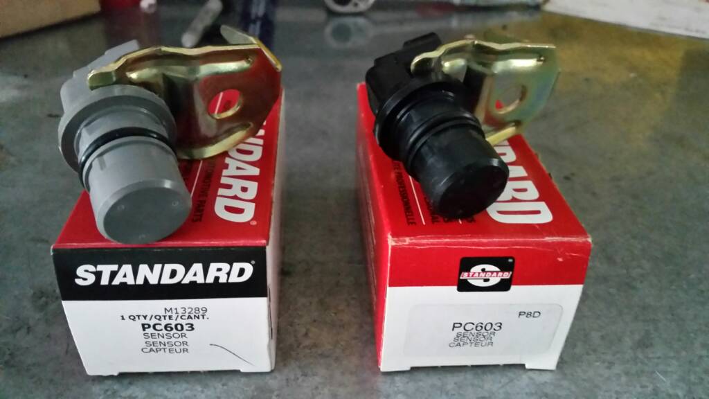

I ordered a second Standard CPS off Ebay for under $10. The second CPS came in gray. The box for the gray sensor says it's made in Mexico. The box for the black one says made in USA. The USA box appears to be an older Standard box logo design. Hmmmmm

I just installed one of the gray Standard PC603 CPS', and this is the smoothest my truck has run in years. I am looking forward to putting more miles on it and see if there are any power or MPG changes.

I installed the black Standard CPS sensor two weeks ago and noticed a significant mileage increase. Mind you, when I noticed the mileage increase, my clutch fan was bad; it was locked/engaged all the time.
The mileage test was a non-scientific one. When I re-fill or switch tanks, I reset the trip meter. On the front tank with Ford replacement gray CPS, I was getting around 250-275 miles on the front tank. After putting in the black CPS, it jumped to 333 before I switched tanks. I have not refilled the tank to verify how much fuel I used. I was still running a bad clutch fan. The coolant needle was just barely in the range \____/.
